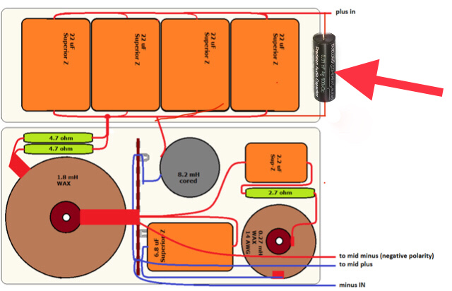

My query is to what extent this resource (using a bypass cap) can be useful in the mid section of my crossover. Should it be installed as indicated for high frequencies? (That is, in parallel with the original cap? My doubt is given because in the media a high pass filter and a low pass filter is combined and I am not sure how the use of a bypass would be maximized.
On the other hand, I have clear sound improvement when using quality caps. Using quality caps in the high frequency section can be expensive but it is possible. However, in the mids section the thing is much more complicated by the value of the caps used. In my loudspeakers I use 4 caps of 22uf of Jantzen Superior Z-cap. Replacing all of them with others of higher quality and sound is an unbearable cost for me. A possible solution is the improvement with a bypass, as I have said before, but it could also be combined with the Z-caps, other condensers of lesser value but that could provide an improvement in sound. For example, in a total value of 88uf, use 80uf of the Z-caps and 8uf of another better cap. Anyone have knowledge or experience of what is the minimum value of a cap for this possible solution to work? 1 pfu? two? 4?….

Bypass caps must make up a significant portion of the total capacitance to have a significant effect at audio frequencies.* The former 'significant' can be interpreted as one third. More important is to keep the total capacitance the same. That means that you have to take out some of the old capacitance, before you add the bypass capacitor.
* And the large capacitor must have sub-par performance, obviously. Except for electrolytic capacitors, they usually are quite good.

thanks for your help. My question is whether this resource can be useful in the media section of my speakers at the position I indicated in the attached photo. Would it be the right placement? Is there any other alternative?

Toni,
You could, as an experiment, make your own bypass capacitors if you are convinced they actually improve the sonics of your loudspeakers. It would virtually cost you nothing but effort although impractical in size, simply use Alfoil and a dialectic of Glad Wrap (food wrap). One might think that idea is rather silly which indeed it is, but it would prove the point that bypass caps are simply pretentious in their use in crossover networks at audio frequencies. If you want to 'lift' the midrange somewhat supposedly to increase midrange clarity why not use the tone controls of your amplfier (if it has some) and that should do the trick. Wasting money on such trivial pursuits as bypass capacitors would be better spent elsewhere, sorry to be so blunt but the marketing of 'enhancements' is just that ... marketing.
