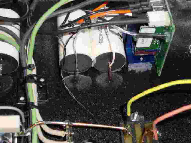

I am curious if using bypass teflon caps on my UcD 180 would make any difference?
I have 2 --12 mf coupling caps per side right now.So that is 4 caps altogether 22mf per side.
I was thinking of using some .01 or .1 teflon bypass caps.I wonder if this will change the sound much at all.

Hello and thx for the reply.
I really don't know---this is the rev 2.0 serial 0540 and 0553
Having a hard time posting pictures here---this is the best i can do
Those caps are huge. I would keep them smaller and mount them not so close to the UcD module with those long unshielded wires. These unshielded wires may pick up noise from the UcD modules themselves or from another noise source.
Best regards
Gertjan

From what I have read in these forum and looking at your pictures, what you need to do is the following:
1. Remove the Sonicaps caps you have in place now.
2. Insert a wire strap across the pads where you removed the two 22uf 63v electrolytic caps.
3. If using single ended RCA connections, insert one 1.0uf 200v cap in line with the "+" pin. Mount the cap at the RCA jack.
4. If using balanced connections, insert two 1.0uf 200v caps inline with both the "+" & "-" pins. Mount these caps at the jack.
No bypass caps should be used on the incoming lines to eliminate smearing.

Hello and thx for your reply
What would be the drawback of this method?I do believe that when this amp was built the guy was going by the reference design.I only use single end cables.

I must have missed it in the hotrod forum or at the time did not understand what i had read.
It looks like it would be fine just too use one 1.0uf 200v cap per - then one for +
It looks like trading one coupling cap for another right?I could order 2 1.0 uf mundorf silver in oil caps for this application if i am understanding this correctly .I will start posting in the hotrod forum
