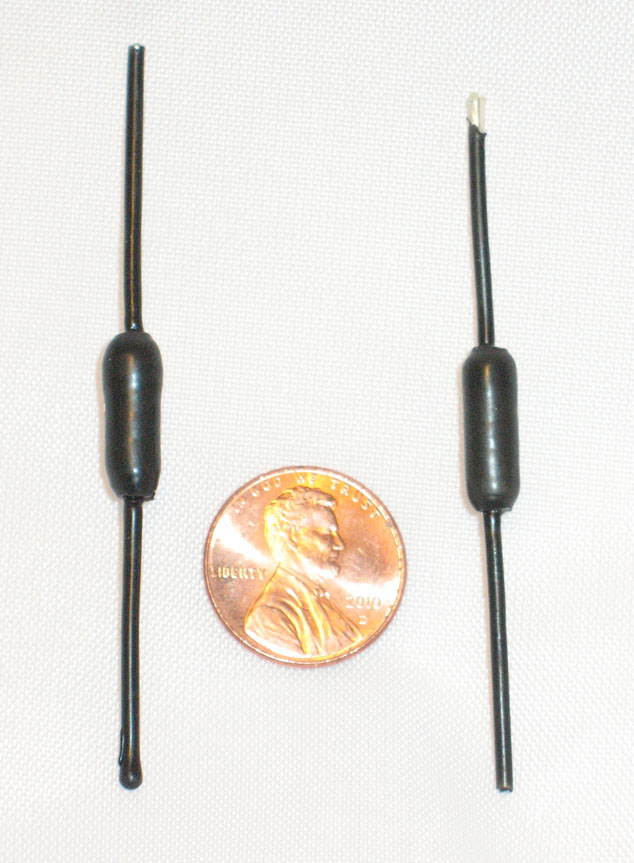

== Device Properties ==
The leads of the device appear to be highly magnetic.
The leads are absolutely not plated copper nor copper alloy- no amount of scraping causes copper to appear. And the attraction to magnets is fierce- when I held a loudspeaker a few inches over the workbench, the parts literally flew off the table.
There's pretty simple test for nickel that I'll run- basically, it's digested in nitric acid, potassium hydroxide added to bring the pH to something over 9, then adding DMG (a chelating agent). A red color indicates nickel- white precipitate in the alkali step indicates iron. The leads do solder well, so I think jlsem's speculation is most likely correct.
John, I tried scraping as you suggested and indeed, the leads appear to be plated copperweld (i.e., copper-plated steel and highly magnetic).
