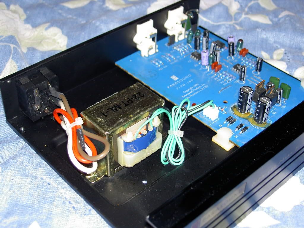

I was also wondering if any of you guys, by looking at the components on this Denon turntable, would be able to recommend any type of upgrade like replacing any of the caps, resistors, or what not, that would improve its sound! Also, take a look at my phono pre-amp and let me know if this also can be upraded. I noticed on the power plug jack, that the earth ground isn't connected to anything. Is this O.K.? Thanks again everyone for your help! Here are 2 photos of the pre-amp:

I did notice that when the volume is turned up like around 3/4 way & up, you can hear a hissing sound.
There is a lot of gain in a phono stage. The hissing is normal when the gain is turned up 3/4 of the way.
Perhaps better equipment
Without patronising you at all, perhaps upgrading the turntable/ phono section may be in order. I dont know what other members think but will read with interest. If you have a budget to upgrade it might be better spent. Modifying stuff that works as in the phono preamp may well result in degradation of sound or it may stop working all together. Those op amps are soldered to the board for instance and may be difficult to get out if you are not experienced.. I dont like metal film resistors etc etc but perhaps leaving it alone and upgrading to a tubebox se or some such device by "project" may make you happy.
