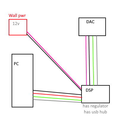

I solve this literally by leaving the DAC connected to an external linear supply (though smps would do fine, just no downside to this for me) and the signal lines to the computer that has a root hub using a new chipset. This technically is against the usb spec as the power is there before the negotiation but newer root hubs handle this just fine - it can confuse some older ones though, but we are talking many years old by then.
It is essentially one USB B connector connected to two USB A ends where one only carries Differential Pairs signal (Green-White) and GND and the other one only VCC and GND. I loop the DAC through my DSP box which acts as the power supply for the DAC and then forwards the signal. I have it this way because of future plans unrelated to this power thing.
My primary use for having it completely separate from the computer is so that in the event I forget to shut off the amps, my speakers dont get the huge pop the UMC204HD has. But the spirit is the same.
Attached image is how my situation is, to make it clear that the DSP box does not do anything else than act as a junction box
