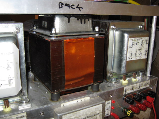

Not always. Those of us using HP p-p stuff with high VA transformers in close physical proximity with the output trannies will notice hum on switch on. Reason, a short period delay arises from not all tubes conducting at the same time, so at this moment the global nfb loop is not effective in reducing the output impedance. Give it time.
