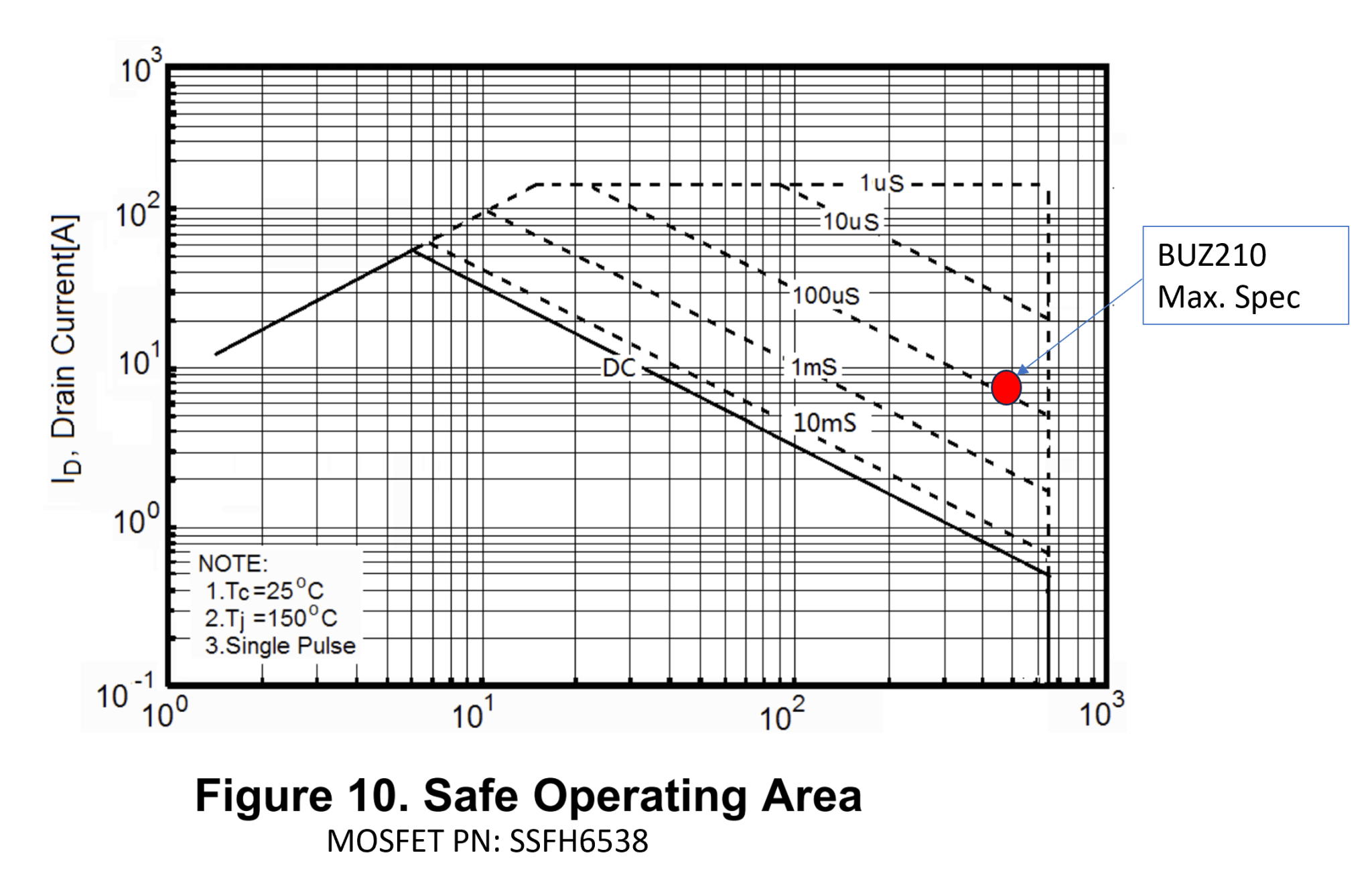

@MarcelvdG thank you for the response. After doing some research I believe that makes sense to me. Please tell me if I understand this correctly. You are saying that assuming the FET is used as an amplifying device rather than a switch, I should make sure that the operating conditions like Id and Vds are in the safe zone on the SOA curve. For example, if the BUZ210 is operated at or near its maximum specifications of 500Vds and 10.5 Id, the SOA curve from a potential replacement FET below probably wouldn't work because the operating condition is not within the continuous duty zone (below the DC curve):
Indeed, and modern MOSFETs often have a maximum drain current that drops very quickly with increasing voltage on the DC SOAR curve, or even have no specified DC curve at all. stv has a point about the heatsink size, though.

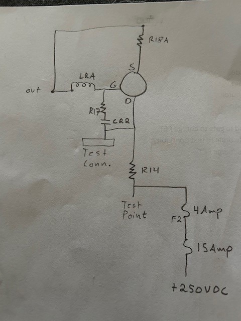

Thank you both! This is very helpful feedback. Are there other ways I can determine if the MOSFET is being used as a linear device or as a switching device in this circuit? I can eventually power the unit back on and take measurements.
