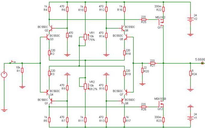

I never tried a similar design, but for me it looks promising.
Could result in a fast but at the same time stable design.
The output stage seems somehow close to a ZEN....
If you find the right bias... promising....
Hm, bias might be critical in reality.
In fact I am not sure if your DC bias of the output stage
will show a satisfying temperature behaviour.
If you observe issues with oscillation/ringing, then my proposals would be:
1. Make the slowest pole more dominant and more linear.
==> caps from gate to drain of the Mosfets.
2. Shift phase of the feedback signal towards earlier.
==> cap parallel to the feedback resistor.
Bye and looking forward to your results (if you go for this amp)

Does anybody see some
odd component values there. Cheers,
Argo

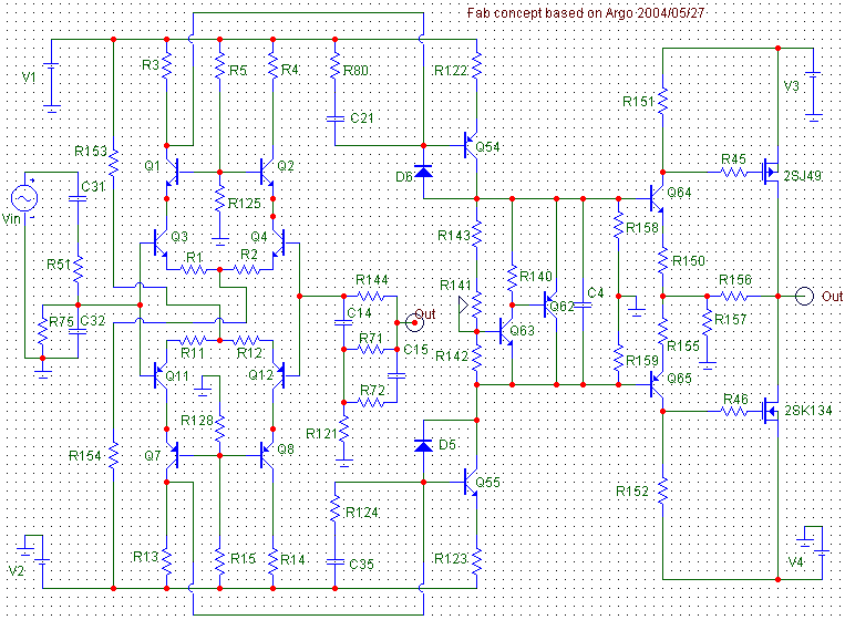

Argo,
I will try to describe your design: Complementary symetric differential cascode input stage with passive current sources and no "standard" VAS (or VAS formed by the output stage).
I believe that this simple circuit topology may be better for a preamp (class A) than a power amp. I will explain why. It is true that power mosfet does not require a high drive current compared to power BJT but you would need a high diff input current (thus medium power transistors) which in turns will load too much the input stage by the mosfets. Also, unless they are matched very closely, the bias of the mosfets will be different and imply a different current for positive and negative diff input stage which is unusual.
Also, R21 and R20 should be much higher (R21 is usually closed to R1). The overall open loop gain is only about 16 to 30 depending on the transconductance of the mosfet (usually less than 2, thus mosfet stage gain 2 * 8 =16) and you have a "desired" closed loop gain of 11. In practice, because of the low open loop gain, the closed loop gain would be about 6.5 to 8. The amp output resistance would be too high which in turns creates a low damping factor, and so on... Unless your intent is to perform a "non overal feedback" design or extremely low feedback design, you need more open loop gain. Again for a preamp since the output load would be something like at least 10K ohms then the open loop gain would be about
Sorry if I may sound a little pessimistic about your design but I just want to help you and no more. Good luck!
Fab

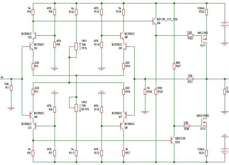

Hi Argo!
With the second schematic you will only decouple the differential from the MosFets.
But you will still have the low gain and a high comparably high output stage.
If you go for such much number of stages, you should probably
go for a more standard design.
I.e.
You could use Q9 and Q10 for a traditional VAS.
By this you will not need anymore gain from the output stage
and you could connect Q11 and Q12 as a normal voltage follower.
...entire circuit would become pretty much standard by this....
But if you are not experienced in own designs and all the related calculation and background for frequency compensation you will probably be more lucky if you pick tested and proved design and only use your BUZ for the output.
In fact your first design was somehow charming for me, because it had the following one straight line.
A 2-stage-amp instead of the typicall 3-stage-design.
Low feedback.
Very fast cascode differential input . Dominant pole given by the
MosFets reverse capacitance and the driving resistance....
Also the low resistances in the feedback matched perfectly to this
approach, as this would shift another parasitic pole to very high frequencies.....
Alltogether charming and worth a trial, even if we consider
all the obvious drawbacks which FAB listed.
The ZEN amps have proven that such a low gain+high output impedance design can sound pretty fine.
Your design would combine a ZEN with some more gain and
a DC-coupled signal path... again charming... at least for me
I am not sure if all your values would be really fortunate....

Hi Marcus,
Thanks again for encouragement. While I really appreciate Fabs effort to talk sense to me - what the heck - I have built quite few circuits, which after much hassle and time spent, have given me nothing but a disappointment because of the sound I heard from them after fire up, that one more failure cannot kill my interest to this hobby. So I will build it according to the first schematic, thanks to your enthusiasm, you have also stirred up in me by now.
As I told it’s not my schematic. I copied a most part of it from here http://member.newsguy.com/~stigerik/html/mpa_30_power_amp.htm and the rest I added from the schematic from here http://home.tiscalinet.ch/cooltune/Projects/Megalith01.htm . Yes I am curious what it comes out. If it turns out bad, I will always have a safe wonderful sounding circuit - JLH class A with Geoff’s updates. I could be happy with JLH amp, enjoy it for the rest of my life and have other interests and not build a thing ever but this is not the case. The thing, what drives me, seems not to be a listening of the good equipment but rather building and experimenting with it.

Argo,
To respond to your question, your input stage is fine. Your second schematic, as pointed by Chocoholic, has still low gain and high output impedance so I would not go for it. However, my comments are only on electronic characteristics so you know. I do not pretend that low open loop gain sounds worse or better than higher open loop gain. The THD will be higher (but is it an important element?) and the damping factor will be low. For the latter, I am not convinced how it can sound better, but "sound" is subjective to the listeners.
I must say that I did like also your design (maybe it is because it is fully symetric, uses mosfet, cascode diff input, etc). The MPA30 and Megalith have higher open loop gain thus lower output impedance and output transistors are isolated from input stage.
the MPA30 is a low overall feedback and the Megalith is a local feedback design on gain stages.
this is really your decision to continue with your design. Maybe, it is still possible to use the input of MPA30 and output of Megalith to meet your original intent ..but it is tool ate and I must go to sleep...
Fab
Fab

Trying to figure out your intent based on your comments on this thread, here is what I began to have in mind before I got to sleep yesterday.
You will recognize your symetric diff input stage (MPA30) and mosfet in voltage gain configuration ( Megalith output stage) with local feedback. Also, it has a VAS to increase open loop gain and the Megalith output stage. It has bias current adjustment to go either class AB or up to class A. Since you can adjust resistors values to your needs ,you are able to either have a very low feedback or high feedback design. It is just an adaptation from your original concept and I do not pretend that it can give outstanding results (but it could too!). What do you think?
Fab
Fab
I would like to point out that D5 and D6 should be Shottky diodes or switching german diodes eventually.
Argo
