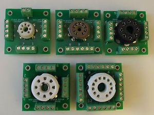

Tube socket. What type I should buy? Are there any suitable for breadboarding?
These look nice! I am thinking of having 9 pins for small signal and 8 pin for power tubes (I am not sure, that I am using terms like small signal and power tubes correctly, so please excuse me)
