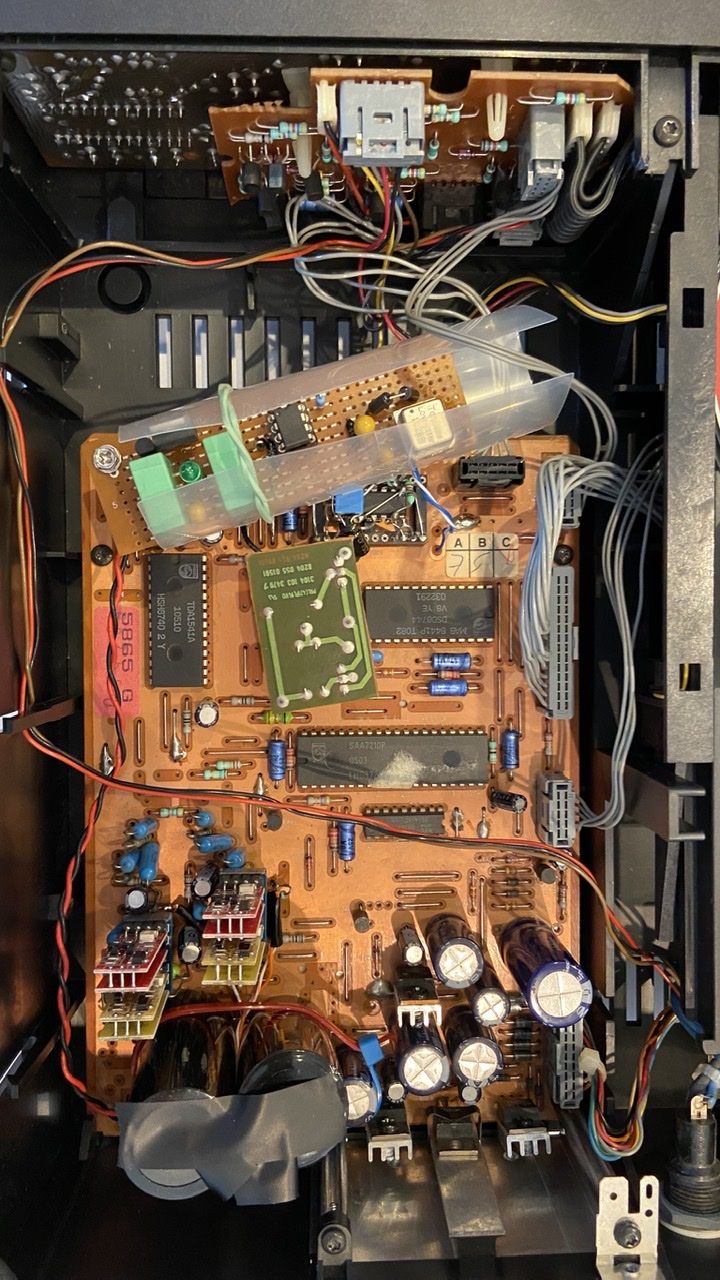

I confess I'm a member of the TDA1541A "cult" and I believe that CD red book has enough information to sound really really good if the I2S signal and power supplies are done right. So what I like to do is get an old Marantz or Philips CD player and mod it using the information found mostly on this forum and also elsewhere on the web.

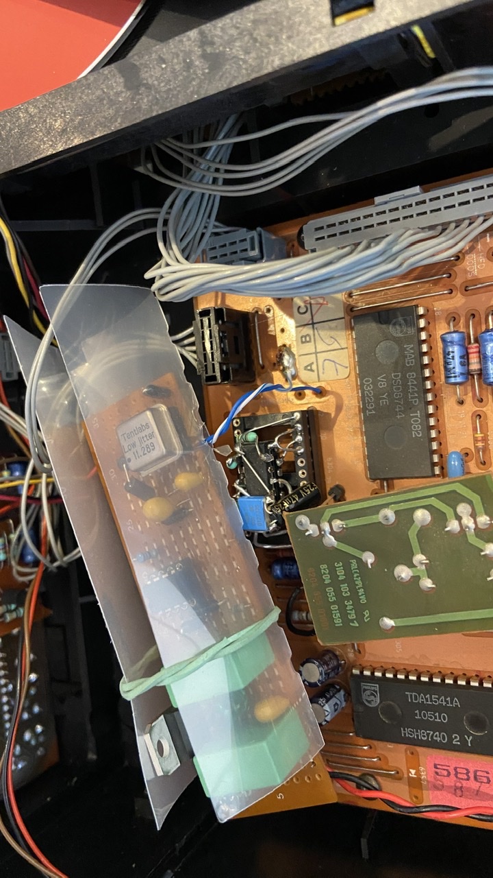

The newest project that I haven't made inoperable yet (fingers crossed) is a Marantz CD-273. It's a cheap nothing special player which originally sounds just ok. It had the LM833N opamps. I put the Bursons in but wasn't impressed much. It sounded better, but it was still somehow restrained and uninteresting to listen to. So I decided to mod it a little and bypassed everything behind the opamps so that the signal goes straight to good audio output caps and rca connectors. This unveiled the music quite a bit. Then i removed the SAA7220 oversampling and filtering chip and installed a reclock thingy that realigns the I2S signal before entering the TDA1541A. This mod also removed signal oversampling and cleared the 5V psu line of one noisy chip. Now the CD player sounds so much better it's barely recognizable and is actually a pleasure to listen to. Now it's a good enough platform for testing opamps.

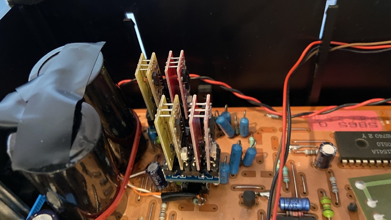

The CD player originally uses one double opamp per channel where the left side of the opamp amplifies the signal and the right side buffers it. I used double and also single opamps with singles to double adapters.

Since they are singles I put them in with Philips as buffers and the combo sounded better than an all Philips combo right away!
Great, then I tried them with every other opamp as buffer and the best buffer were the AD797s. The sound was natural, detailed, dynamic with deep enough well defined bass. The vocals were just amazing and level of dynamics which gives the music its emotions was comparable to a tube amplifier.

Let's go step by step - in between I upgraded my CD player with a TentLabs low jitter clock powered by a homemade Flea voltage regulator.
The effect was profound regarding the sound image resolution (more detail) and the soundstage got more depth. The CD player rose to a seriously good sounding level.
Then I put the Vivids in instead of Classics (both are singles followed by a buffer opamp) and music retained the detail and got more free in a sense somehow.
Then I wanted to try Bursons all the way - for amplifying and buffering the signal, but they couldn't fit on the single-to-dual adapter. So I had to strip them of their otherwise nice casings and oh my, it was worth it.
Especially with the Vivids as amplifiers and Classics as buffers after a few days of break-in it got in the ballpark of "the best I have ever heard". Vivids are all as good as Classics, but even more natural sounding.
