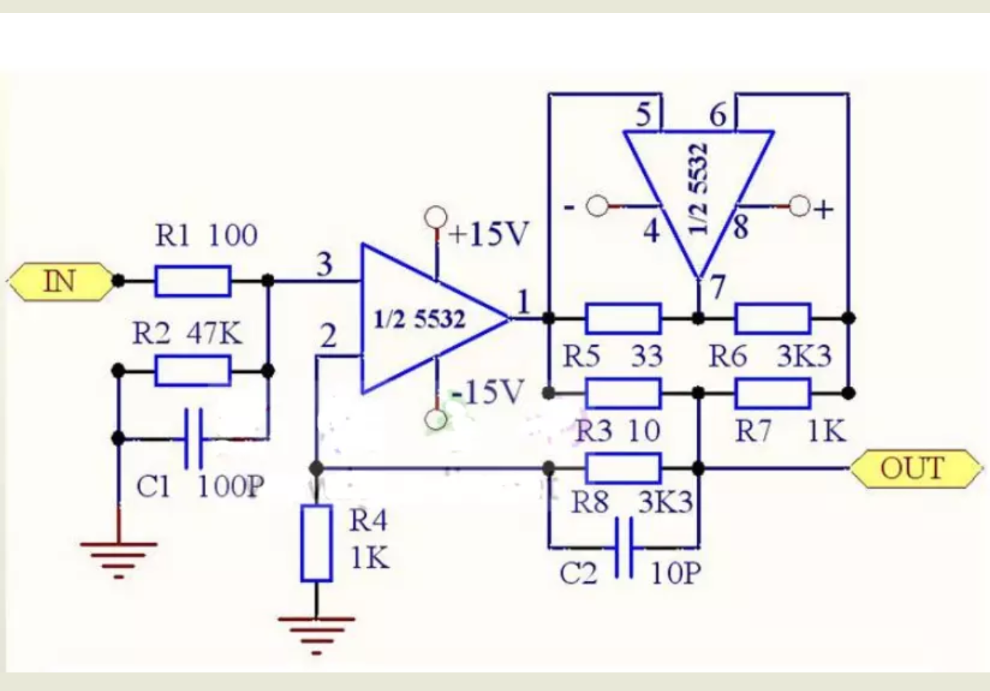

Let me refine my question. Looking for a circuit design for a two, dual opamp stereo Preamp with a 24V+ input. How's this for a starting point? Yes, it's +/- V power, but thought I would throw a noodle on the fridge and see what sticks.
The circuit shown is a method for augmenting opamp output with another one to improve drive capability. If you need high current drive you should look at the datasheet application note for the LME49600 which is a high current buffer in the overall feedback loop of an input opamp stage.
Not sure what +24V input is needed for. Most common opamps have +/- 18V supplies. TI does make a few higher voltage models.
