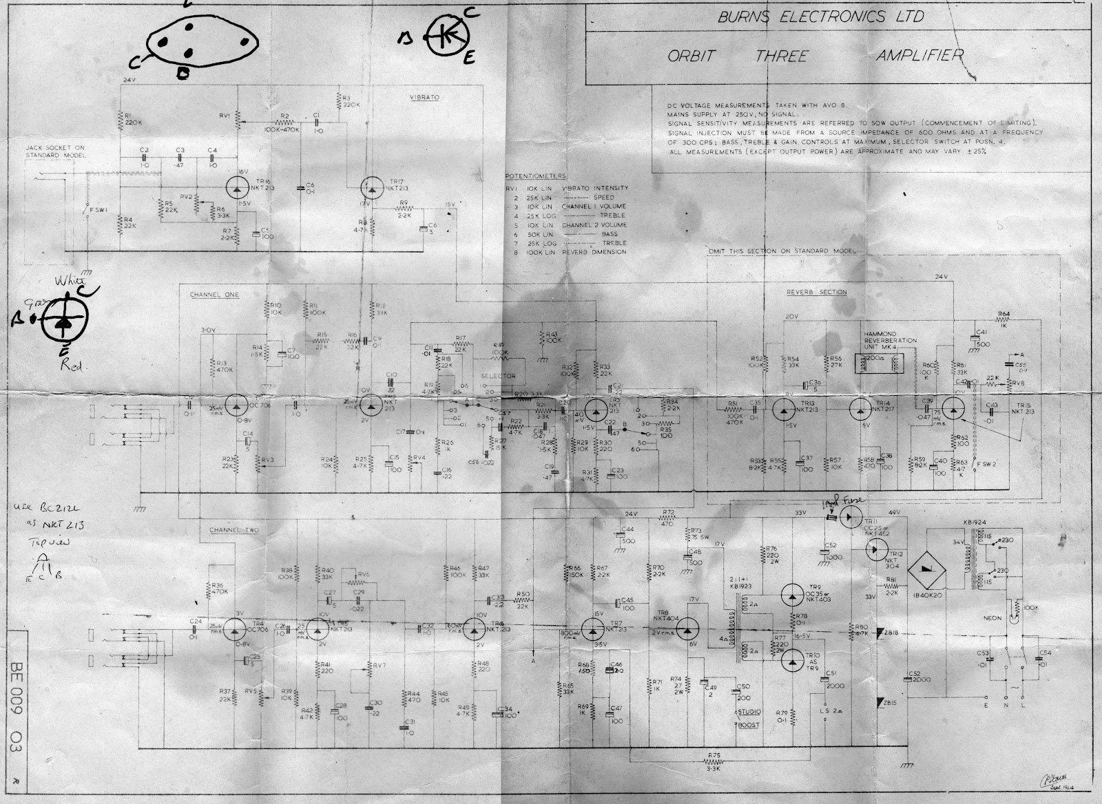

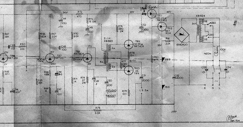

This is fairly normal with any transistor amp, but more so in this case (as according to the schematic on the link above it uses a 33V stabilised PSU).
However, I'd a little dubious about it's 60W power output, although I suppose it might just make it at high levels of distortion - but unlikely to at clean power levels.
Presumably the speakers were specially made?, as 5 ohms isn't a normal value?, and it was certainly unusual to have an amp made for 2 ohm speakers way back then.

Found this circuit which may help. as you can see the transistors are germanium.

Pretty crude, even by the standards back then - reliability was helped (greatly) by using a transformer driver, making the amp far simpler and immune to the 'domino' effects in DC coupled amplifiers.
Back in the early 70's we upgraded to a 125W TUAC power amplifier module for doing disco's, it never failed despite plenty of use and abuse - unlike the numerous DC coupled amps we had used previously.
The 'problem' with such designs of course is sourcing the special transformers required 😀
