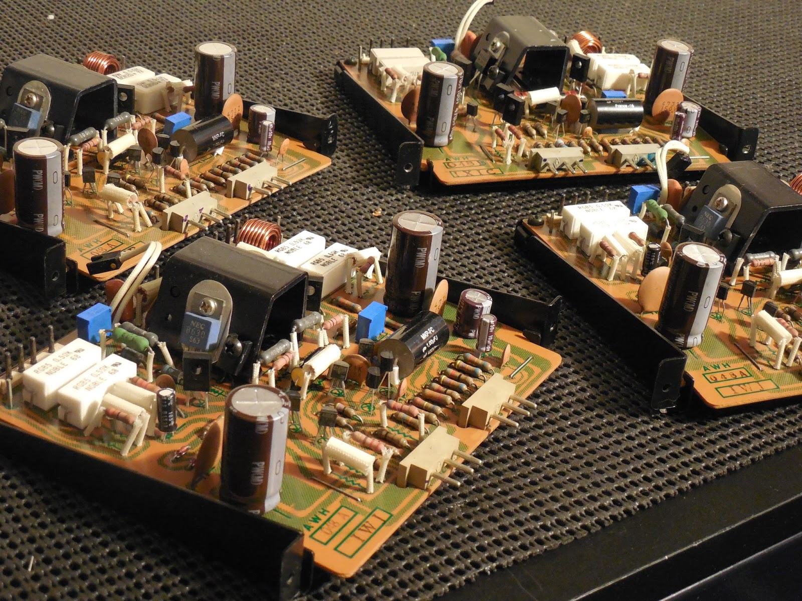

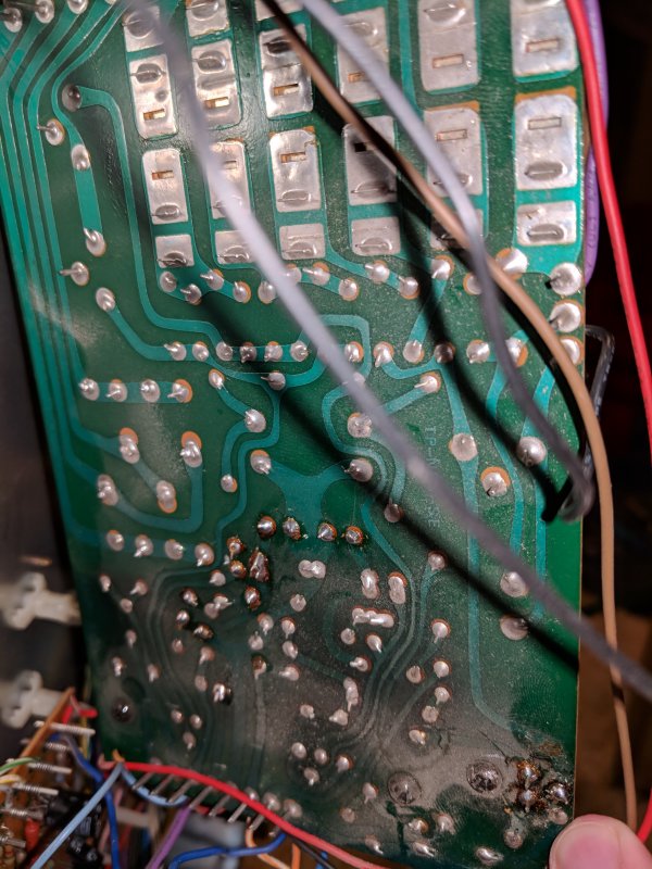

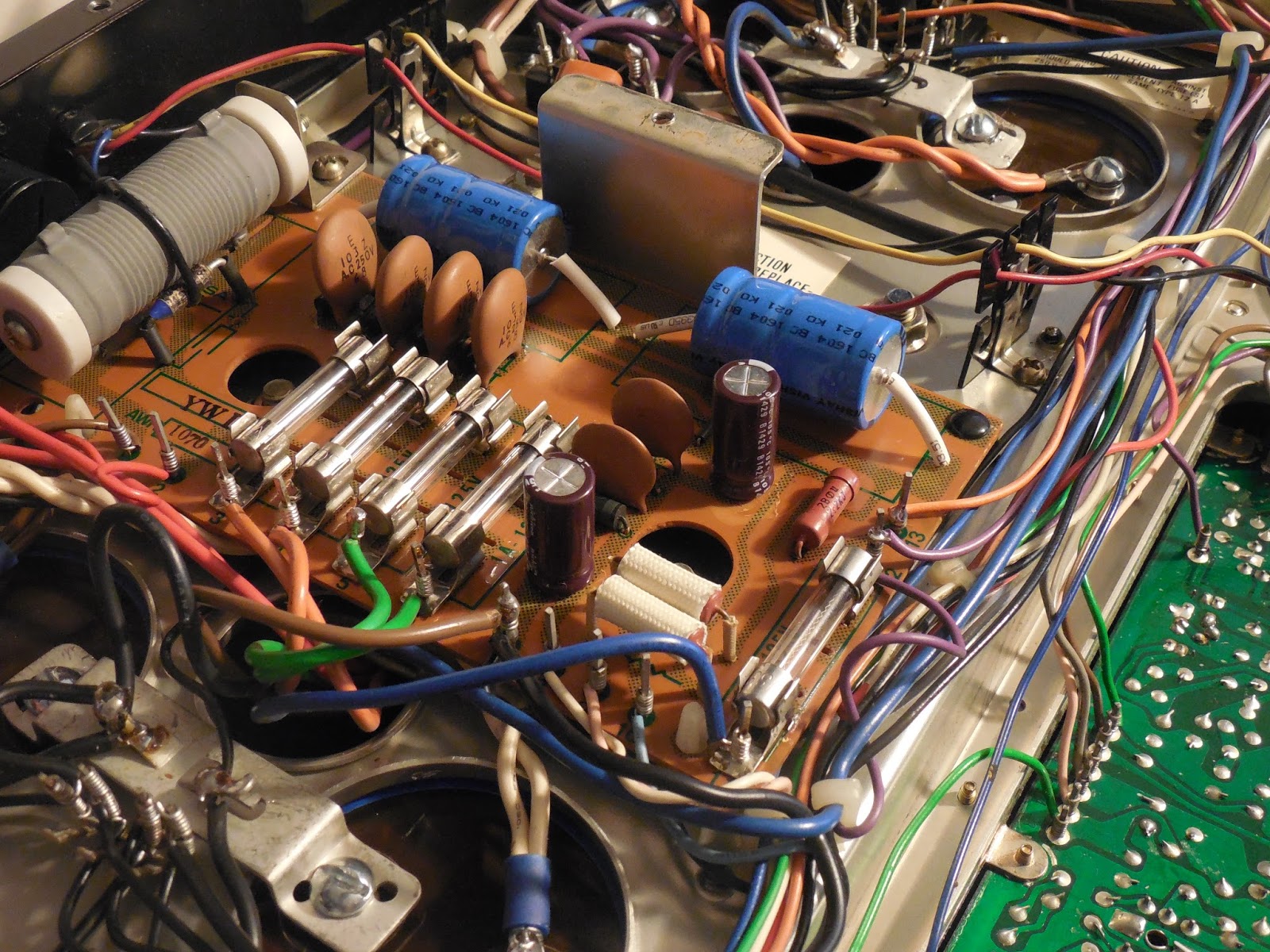

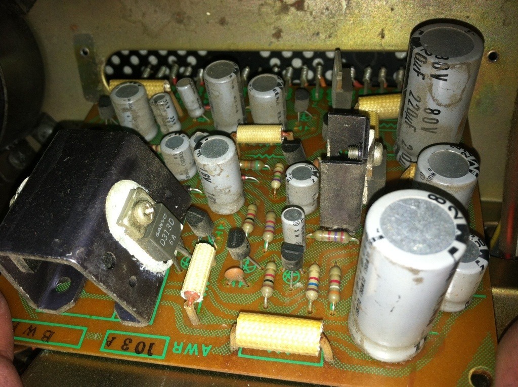

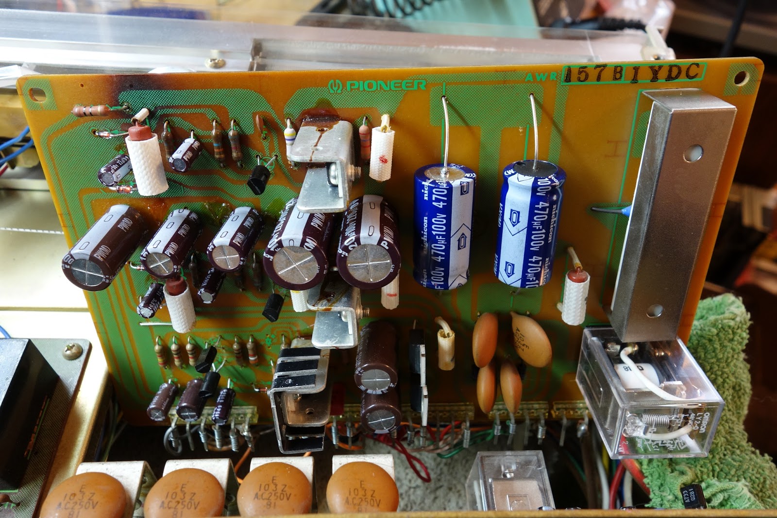

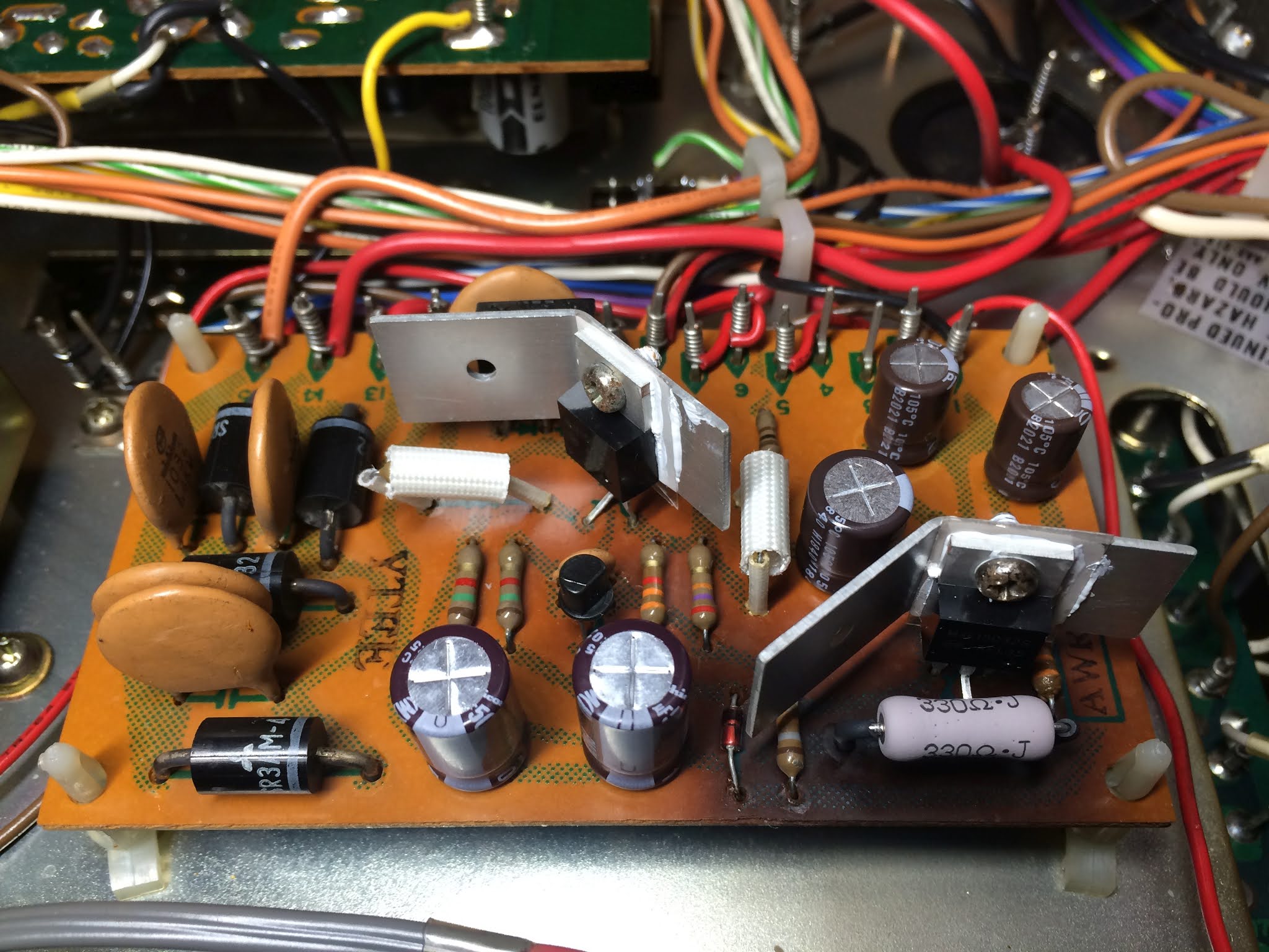

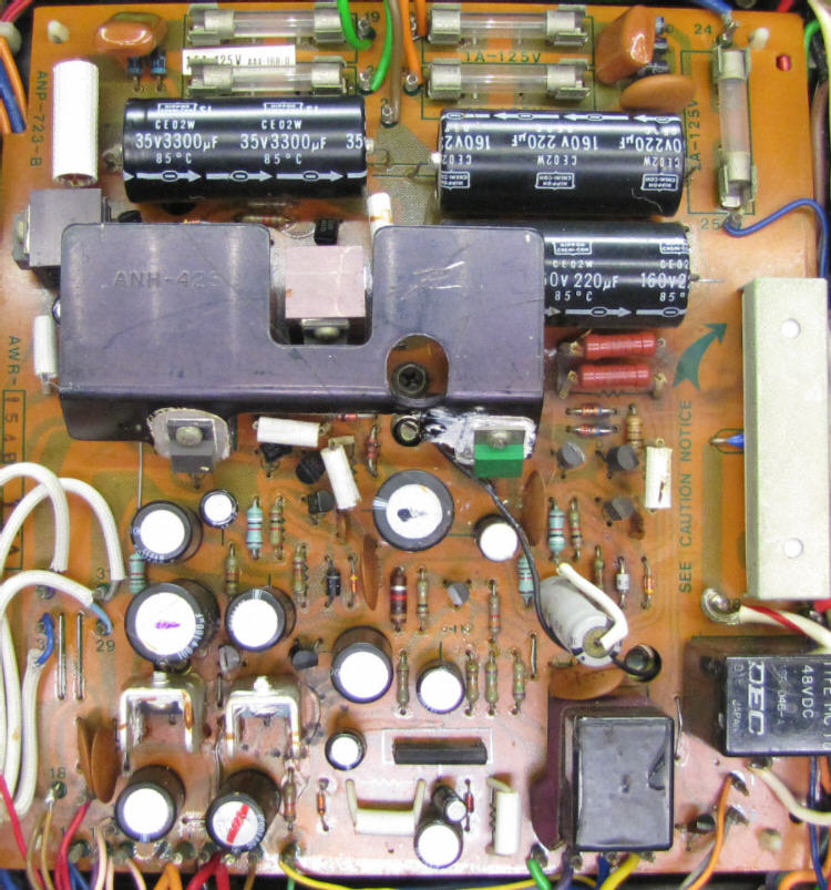

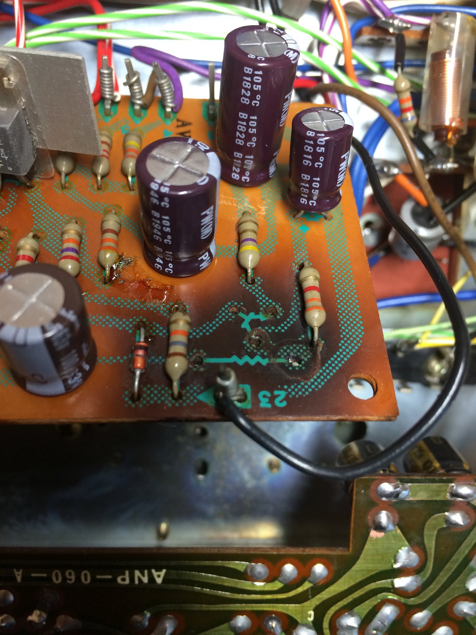

Burned Power Supply PCB's in Pioneers SX Series (727-828-939-980-1050-1080-1250-1280-1980) let's make things better ??
In the attachment there are some images from PS-PCB's of Pioneer's vintage receivers from the 70'. Main reason therefore is the fact, that no chassis mounting for the TO220 parts was realized - instead this only mounting on a actually too small heat sink.
All images in the web after performed refurbishing procedures show the same result - this means that thermal stress continues to occur during operation. This I don't like.
With the SX-939 I plan to screw the TO220 parts onto the chassis in order to achieve better cooling properties.
Maybe there are user's that have done this in such a kind and can upload images - thank you very much.
