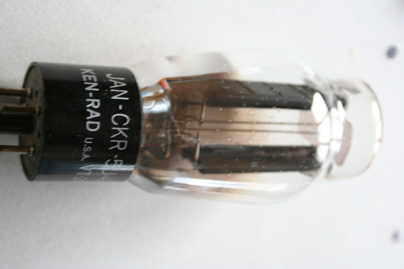

Regarding brands and tube longevity, this 1950's KenRad version of 5U4G is by far my longest service tube in current use and has outstripped 45,000 hrs service mark and still with good emission.
Where did the Ken Rad brand originate from ? Did it have
it's origins in Canada ??
richj
richj

Colt45 said:"Kentucky Radio"
Kenrad started making tubes in 1925, and apparently was acquired in 1945 by GE. The company was divested in 1987 when GE and RCA merged. They still make specialized microwave tubes.
Their tubes are generally well regarded.
I have some very nice box plate 2A3 made by Kenrad, somewhat before the acquisition. Their construction style is uncommon here, and I don't know of any others that are exactly the same. They command princely sums on eBay these days..
