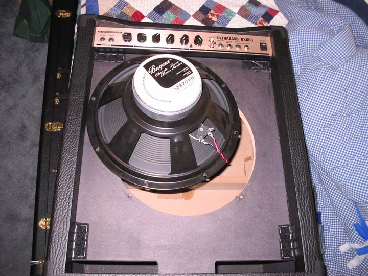

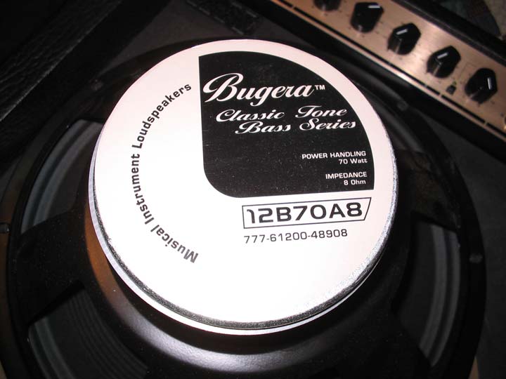

Hey, Does anybody know where I can find the specs for a Burgera Bass driver, specifically the Burgera Classic Tone Bass Series driver in a Behringer BX600 Bass Amp (Driver model #12B70A8).

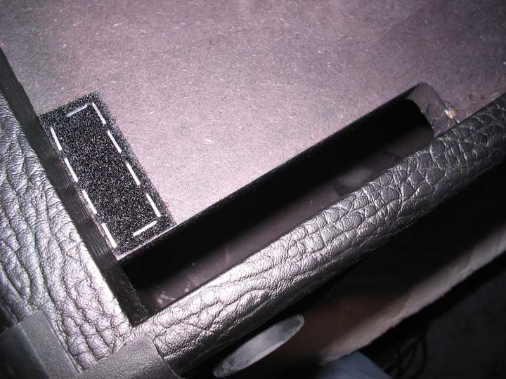

I was looking at the cabinent, and it's a ported cabinet with two 1.25 x 5.25 x 0.75" ports. The driver seems to either be peaking way over Xmax or there's tons of port noise or something when I play really low tunes such as songs with a 5 string bass, or especially when I play drop A tuning. I was wondering what the driver specs are so I can at least get an idea of what the driver is capable of. I might just create real ports in the cabinet and bring the tuning down, or I'm even thinking about buying a new 12" driver to replace this one if nothing can be done.

I have a feeling that Behringer either makes the Bugera (not Burgera) or has it made for them. In all the literature they refer to Bugera (TM) as if it's their own. There doesn't seem to be any literature available on the net so I'm guessing they 're not trying to sell outside of the cabinet. ie: I couldn't find replacement drivers.

Yes, as far as I can tell, they are a Behringer exclusive driver. I've found some information on the interenet about them (at least I think it's about the driver), but it's all in German and Google translator makes a mess of it. No matter what it is, I haven't seen any specs posted of any kind as far as I have found.

From what BassBox Pro tells me, with the volume of the enclosure and the area of the ports, it appears to be tuned to nearly 98 Hz!! This just seems absurd for a bass cabinet; does anybody know if I've done something wrong? Internal dimensions are approximately 16.5" x 16.5" x 9" with a 1.25" x 5.75" x 0.75" port. If I extended the ports to 7" long a piece, tuning drops to 58 Hz, and if I blocked up one port entirely, tuning drops to 42 Hz.
Does any of this seem feasable? Since I don't know any specs on the driver I don't know if this will be bad or damaging in any way.

Hit the nail on the head there. I have it sitting on my bed in the picture actually. Yes it's just a practice amp, but if anything ever came up (very doubtful at my skill level) it's the only amp I have for guitar and bass.

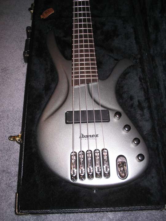

I believe when you say the 'Ultrabass' option you're talking about the shape filter as they call it.... it's the only switchable option as far as I can tell. Sometimes I use it, and sometimes I don't.... it's actually very useful to play with. Between the EQ, the shape filter, and the piezo-bridge pickups on my bass, there are a lot of options available for different tonal charactoristics.

As you mention "piezo-bridge pickups on my bass", I'm presuming you're not using an electric bass? - the piezo pickups don't work very well, and are incredibly prone to feedback.
My daughter has a four string semi-acoustic bass (as well as four and five string electrics), and she did an acoustic gig at Christmas with the guitarist from her band - I did the PA, and the feedback problems were TERRIBLE!. I've told therm both, NO MORE ACOUSTIC GIGS!.
Does this program take the special features of holes and slots used as reflex ports into account ? Their acoustically effective lenght is significantly longer than the actual wall thickness.
OTOH you could tune this cabinet to whatever frequency you want - it would never be able to reproduce even the low E of a bass properly - let alone anything lower !

Yes, BassBox Pro takes into account ports, and the port is only 3/4" long... yes, 3/4". I thought it sounded absurd, but from what I've been hearing, maybe it's not. Since most people have pointed out that it'd do no good tune the box lower, I'll probably just leave everything the way it is.
