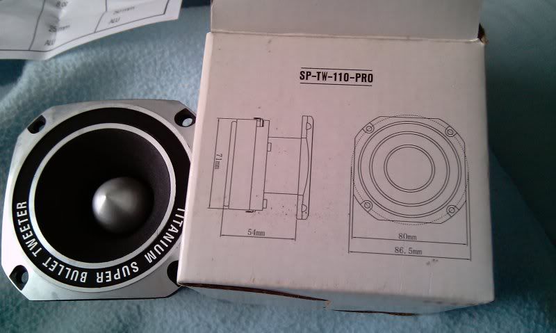

Now you see I have a pair of these -
8ohm 70wrms, 1500Hz - 20kHz according to the bumpf.
And I am unsure what to do with them! So overall I am of no help, unless I could test one and divulge the results, however I really don't know how to go about that as I am only just embarking on my DIY audio path to enlightenment!

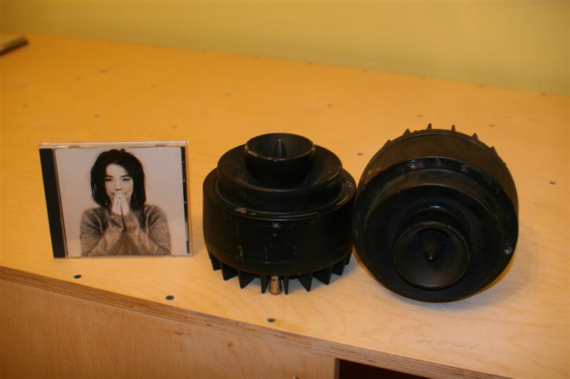

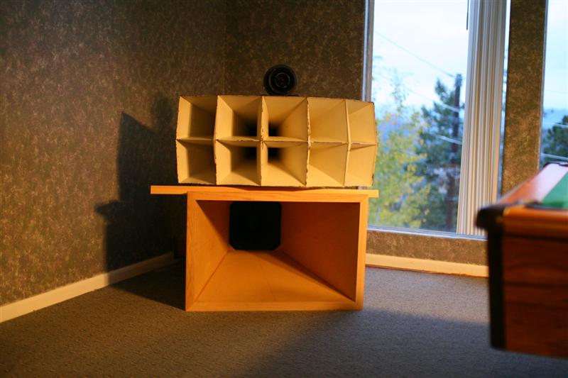

I have a handful of Gauss 1502 built tweeters that I'm using above 7.2Khz in a active setup with digital x-over.
There are some obvious issues, such as the C-C spacing causing lobbing and also I have not payed any attention to matching the polar patterns.
They don't seem to be very efficient above about 12Khz (IIRC). I'd like to try the fostex units, but they are pretty expensive.
For the most part I've been very happy with the sound, but I'm sure it could be improved around the crossover region.
They are a conical design with a 90x90 deg dispersion pattern.

Godzilla, this is a bit different than a compression driver mounted on a waveguide... I am focusing in (at least for now) on this particular style of driver.

I have a pair of those. Mine are called Goldwoods. The 1st thing you do with those is dissassemble them and using a scalpel & small files and clear up all the plastic castings -- i haven't gone further than that yet.
dave
haha excellent, I shall get out my tools and needle files!
Wonder what they are like? The visible bits of the circuit board at the back do appear to be of low quality, however I cannot complain as they were given to me!
I also love the name, TITANIUM SUPER BULLET TWEETER!!!!!!! Does not get any more boastful than that :-D

Scott L, not sure why you like these... phenolic diaphragms are not known for working well up into higher freqs and have more mass than a titanium, but otoh better internal damping... The freq resp isn't bad, but the way that the throat enters (or appears to enter) the conic section is a little odd... and also looks like it is full of diffraction effects. Otoh who knows, maybe it sounds great?
As far as the "Titanium Super Bullet Tweeter" when I looked at them my take was that the dimensions of the throat were larger than I would like - I am looking for ~10kHz. and up so the smaller the dimensions, the better the shot at it! 😀
