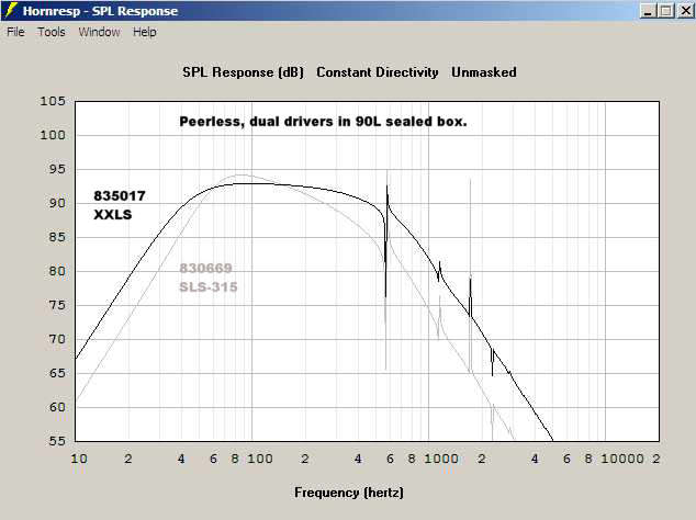

hello. built 2 boxes for 4 woofers. they are split in the middle with 40mm mdf.
size is 45liter. i know it wont be optimal to put other elements in them.
figured i could use a dsp. to make it a little better.
but the question is wich of these
would be best?
835017 - Peerless XXLS Xpanded Extra Long Stroke 12 inch subwoofer - Europe Audio
830669 - Peerless SLS-315 coated paper cone AL shorting ring in magnet system - Europe Audio
the boxes are closed...

checked curves and the xxls will be used instead of sls. will start with 2 xxls an buy the last ones later.
