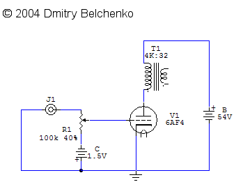

M mig-ru Member Joined 2002 2004-03-05 12:43 am #1 2004-03-05 12:43 am #1 I got one channel to work on first attempt. The transformers are Radio Shack 1K:8ohm units for $3 a piece, bass lacks, but for the price I am not complaining. Maybe add some NFB, suggestions on that? Anyway here's the schem. Attachments my battery headphone amp.gif 4.1 KB · Views: 458
