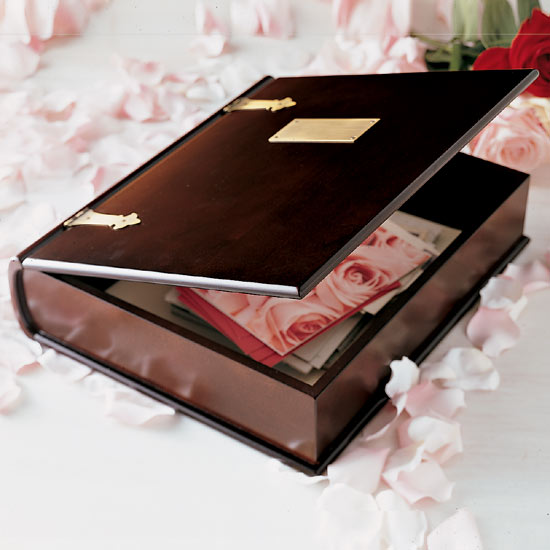

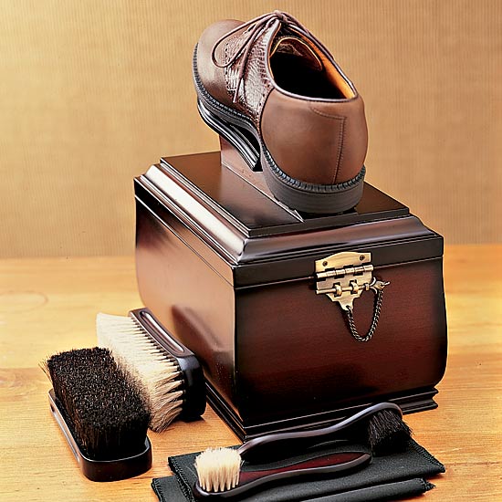

Apparently Bombay Company is quite good for getting a nice wooden box..
http://www.bombaycompany.com
Nice box on a special
http://www.bombaycompany.com/webapp...rId=-2000&storeId=10051&langId=-1&siteId=core
$29

I'd seen that AA thread, didn't realize it was you. Thanks for the Bombay Company link (yes, I'm in the USA), I hadn't considered buying a box from a store because I'd assumed they'd all be too expensive. I've been looking around at thrift stores too for a while, but haven't seen anything promising.
