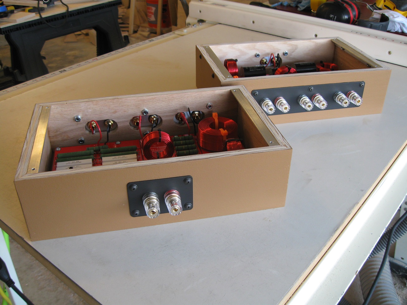

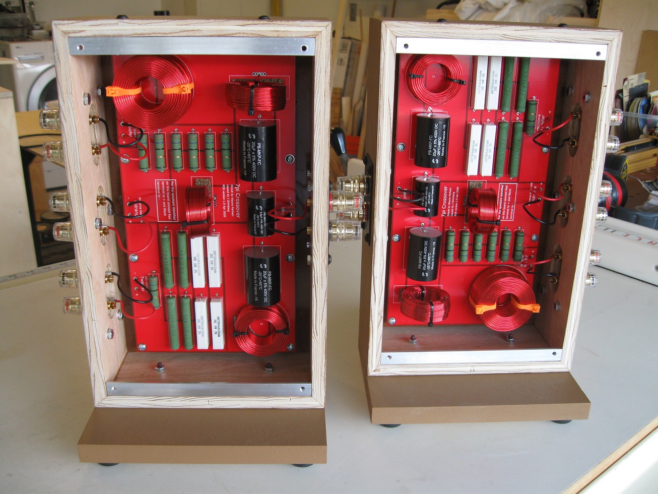

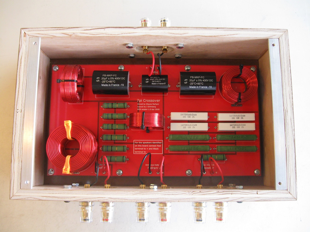

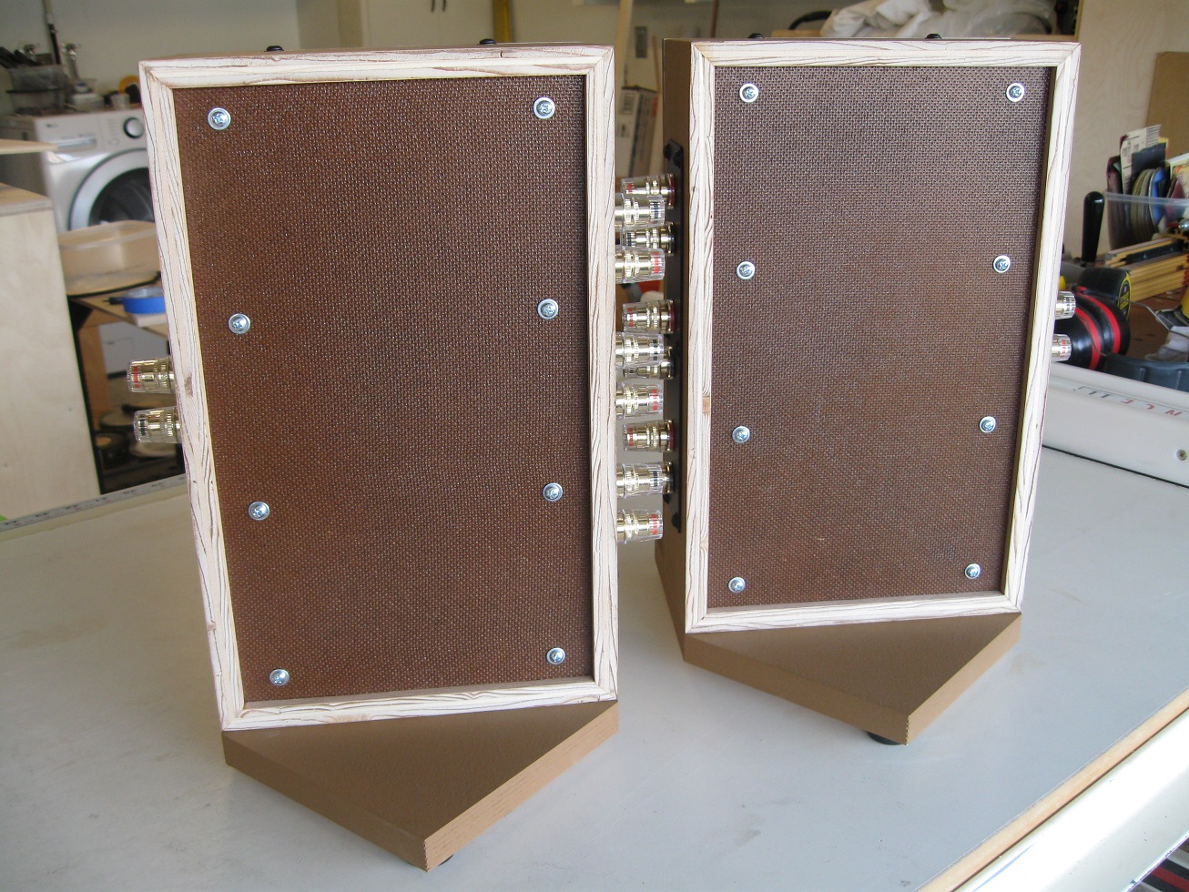

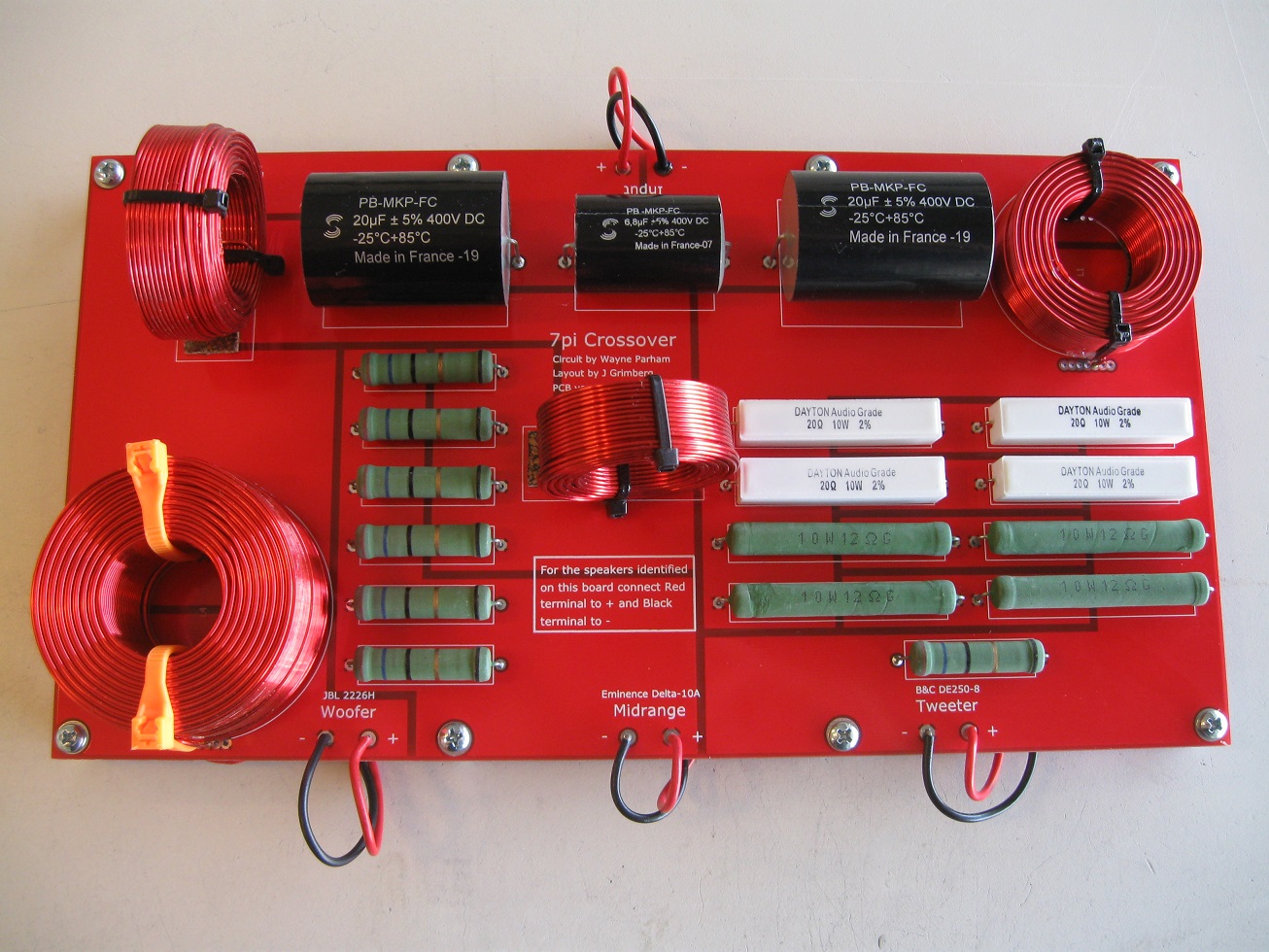

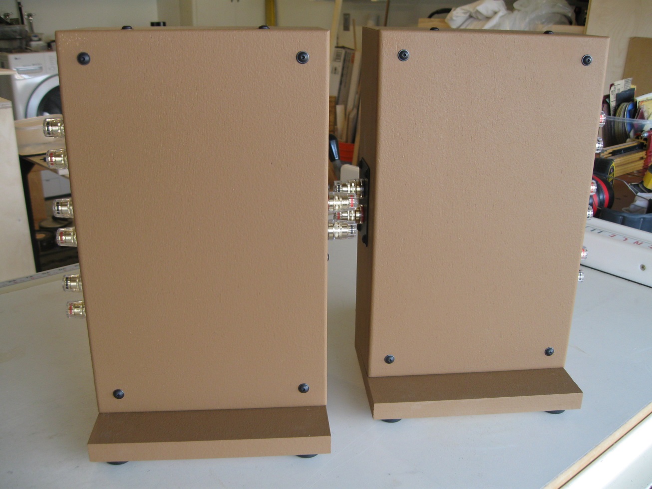

Here are some pictures of the build. I designed my own crossover PCB just as part of the enjoyment of building my own speaker system.
attachment.php
Also built a case for it.
attachment.php
Here is the crossover encased
attachment.php
attachment.php
To fit behind the mid-horn I added a base to keep it vertical
attachment.php
attachment.php
attachment.php

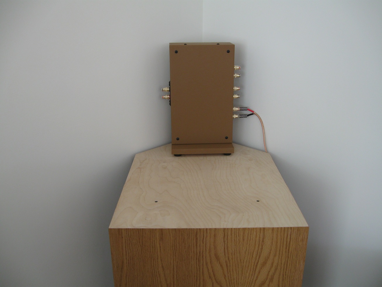

This is how the crossover sits on the bass unit
attachment.php

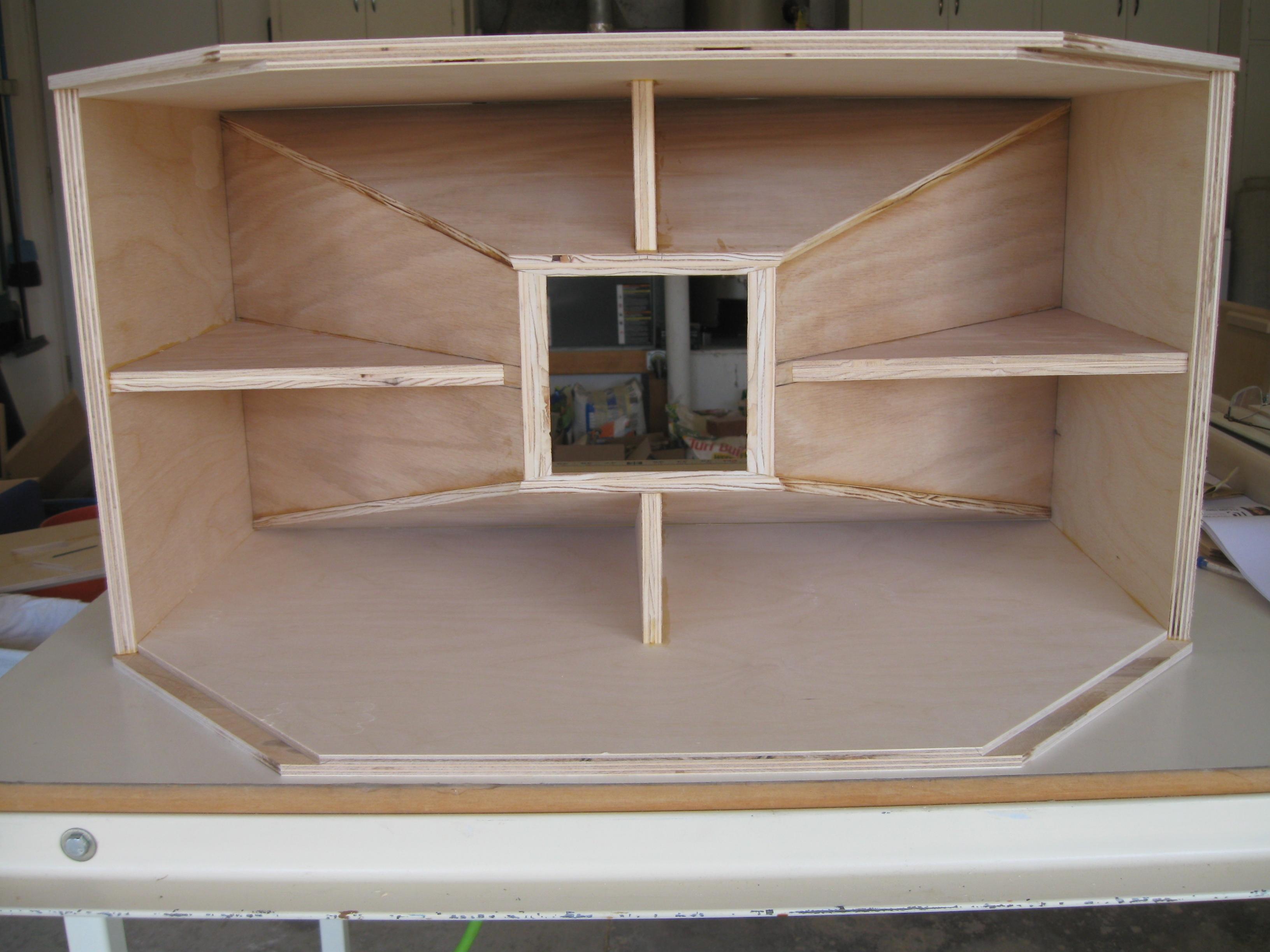

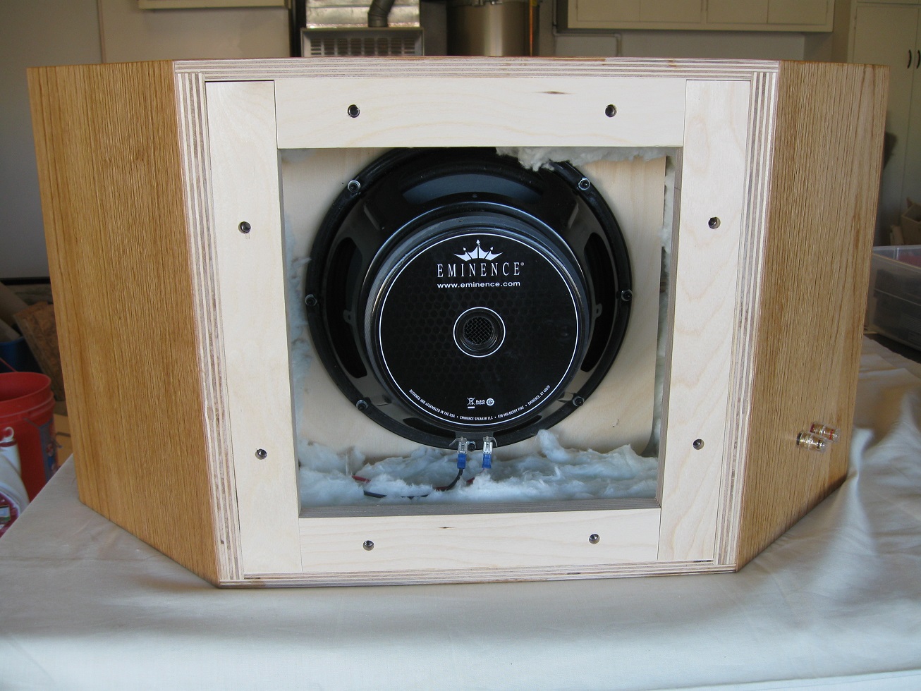

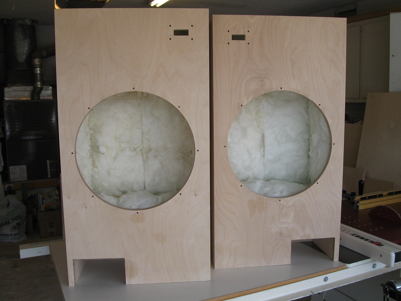

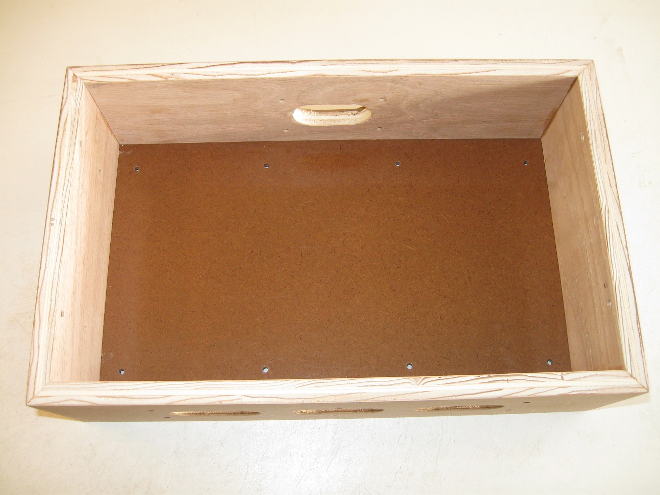

The bass unit
This is the bass unit during the building process.
attachment.php
attachment.php
attachment.php

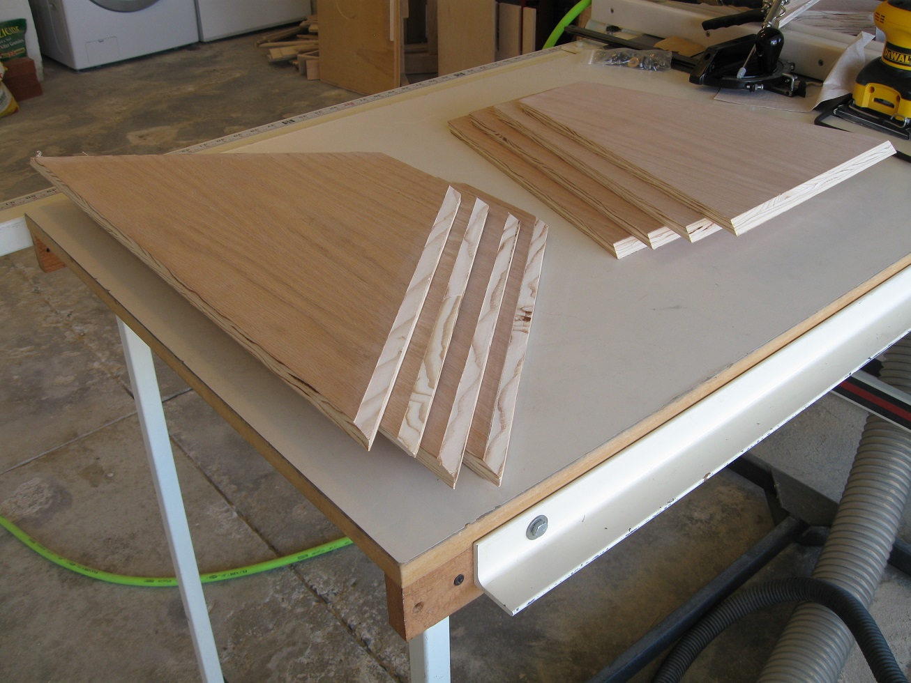

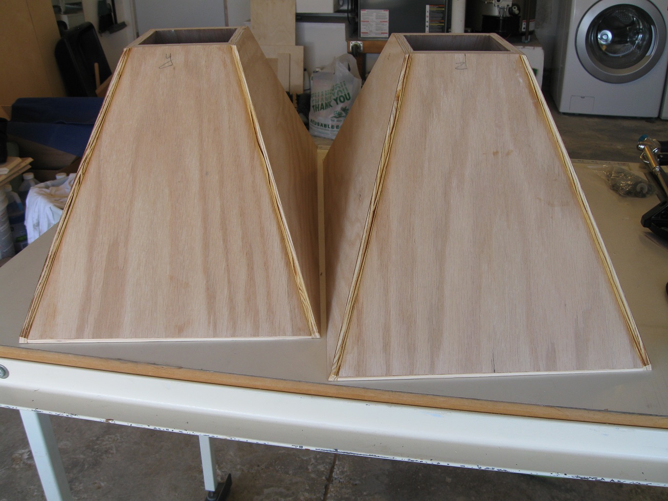

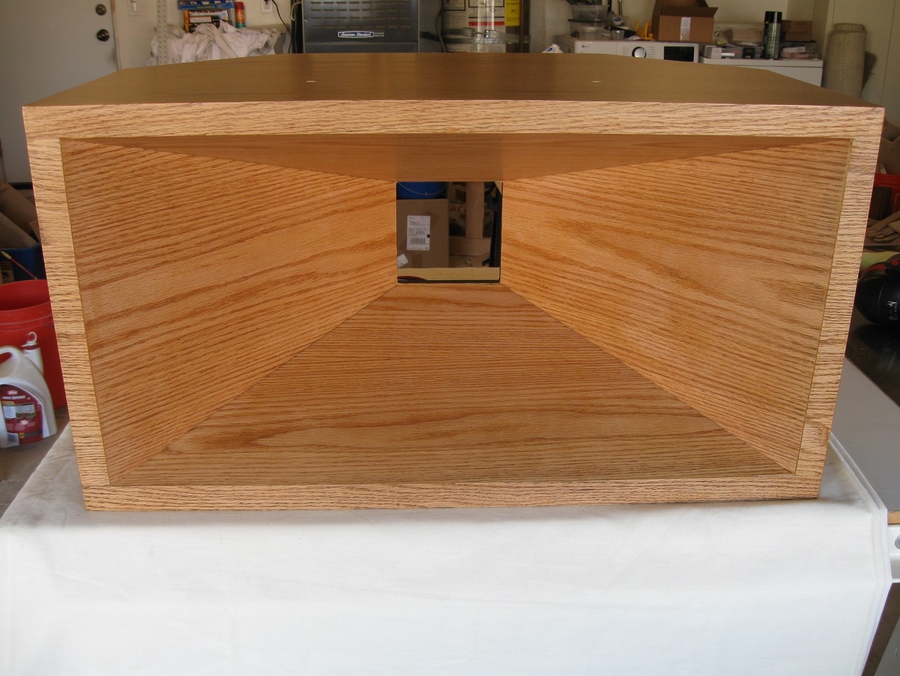

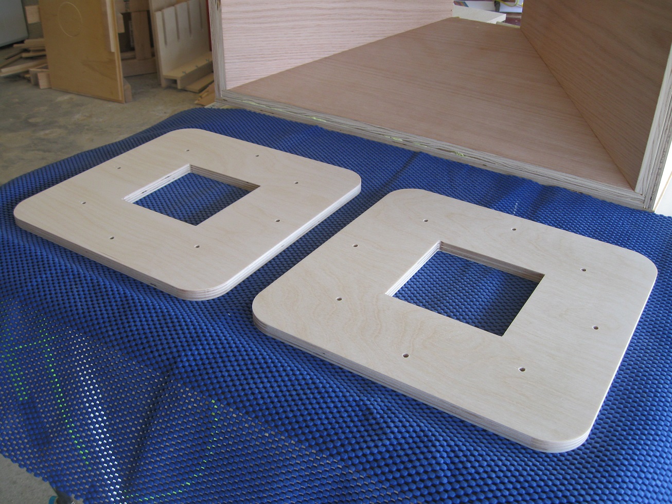

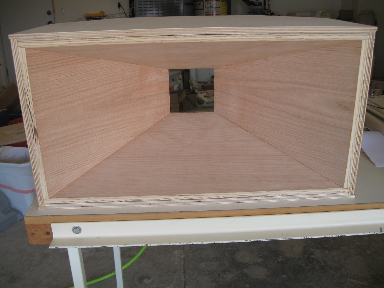

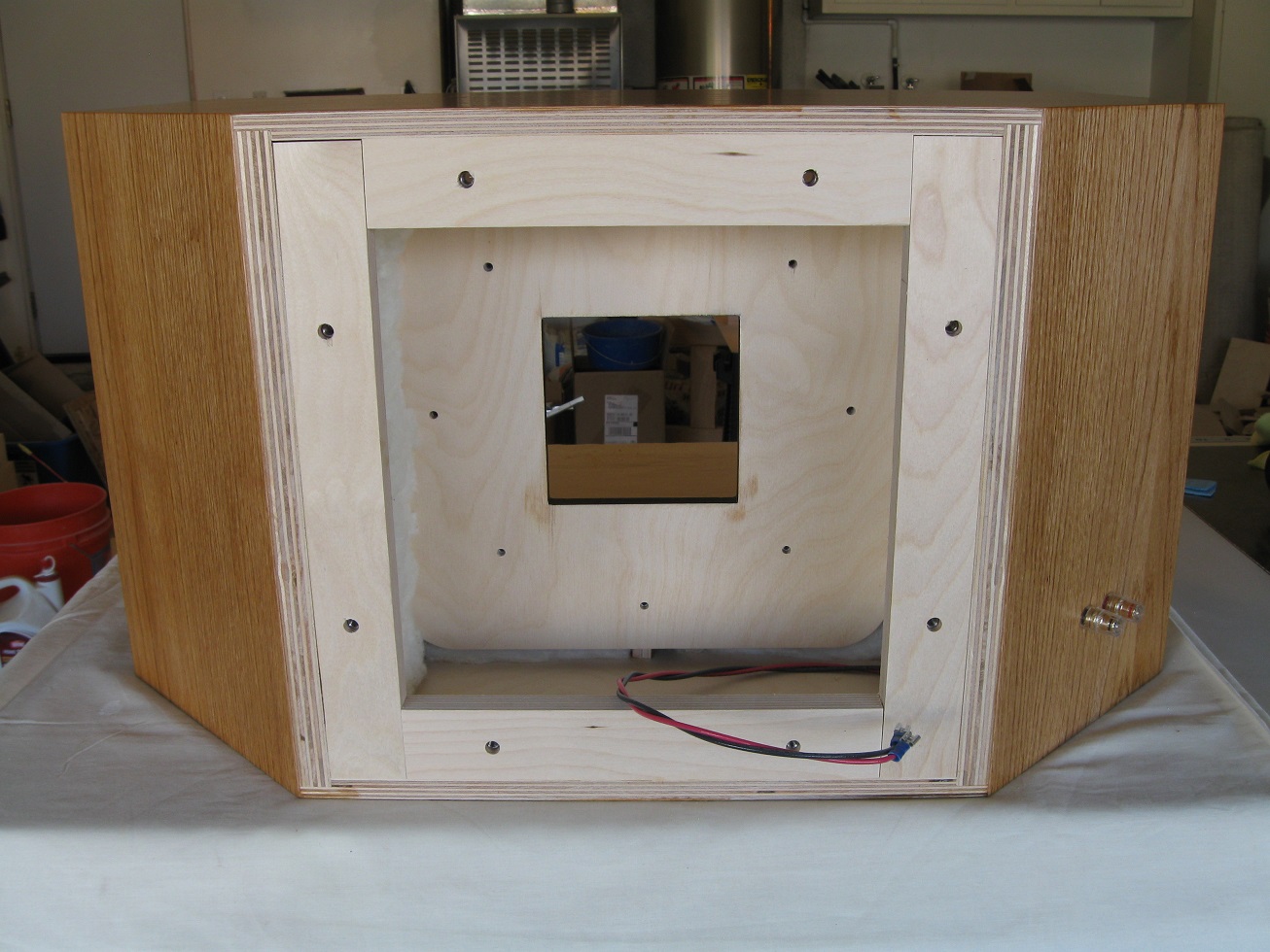

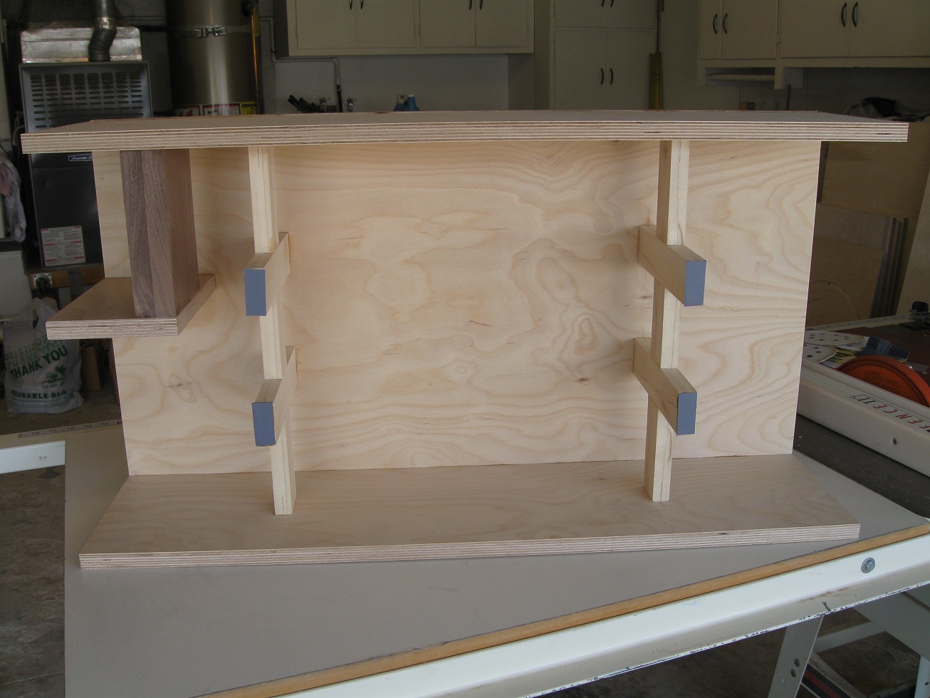

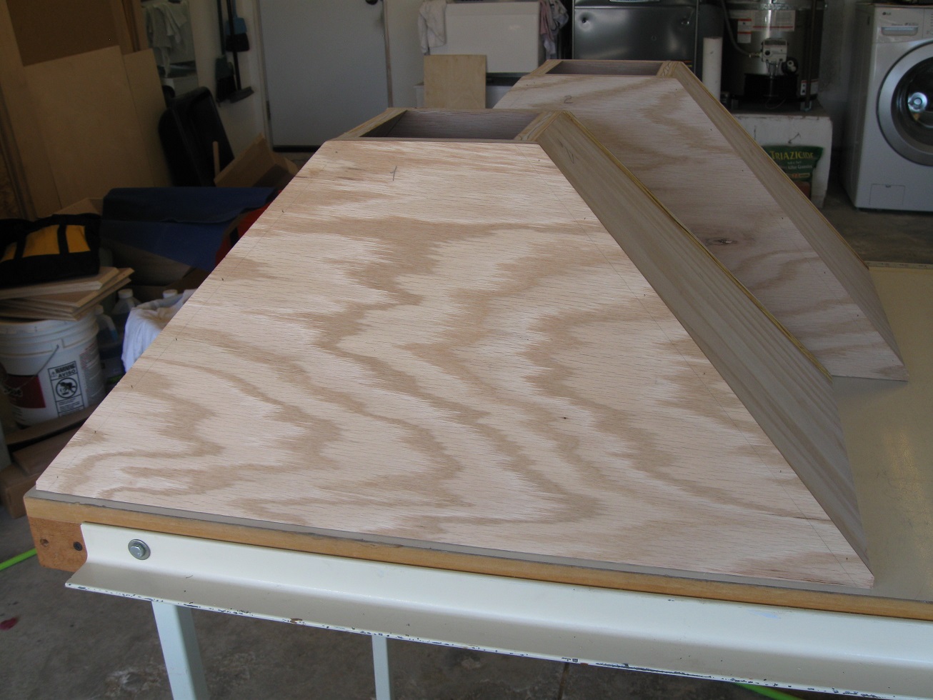

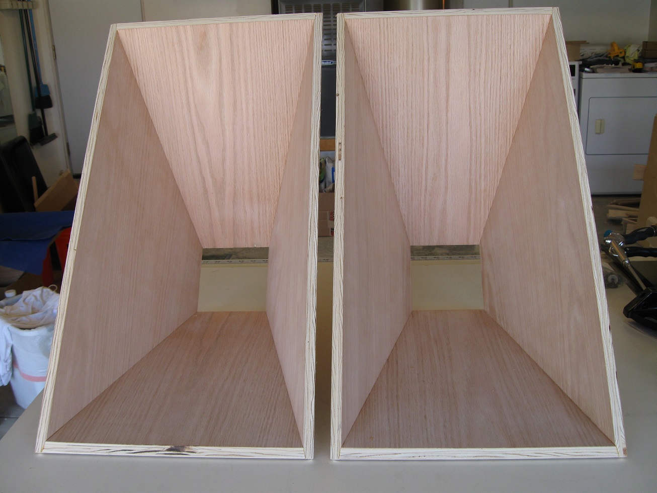

The mid-horn
The mid-horn was the most labor intensive and time consuming portion of the whole build. Here are the flare sides cut and then assembled.
attachment.php
attachment.php
attachment.php
attachment.php
attachment.php
attachment.php
attachment.php
attachment.php

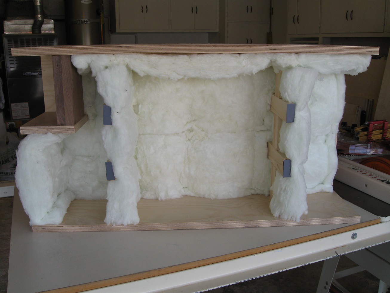

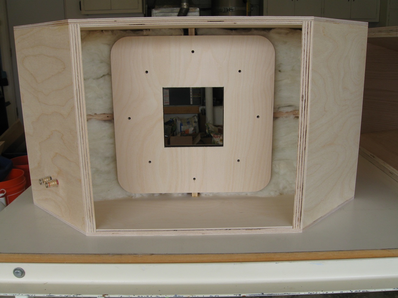

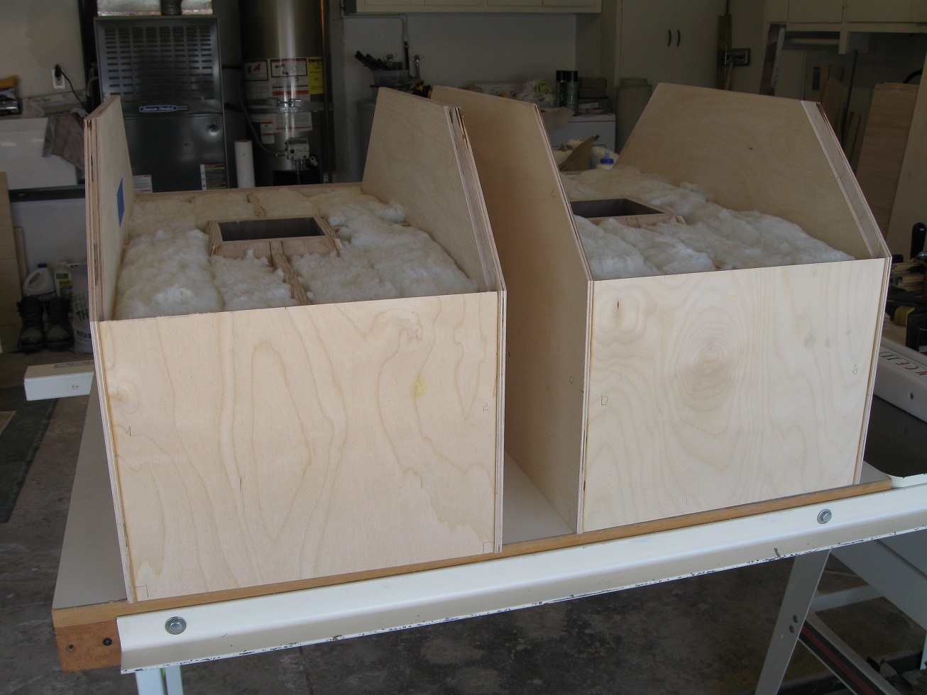

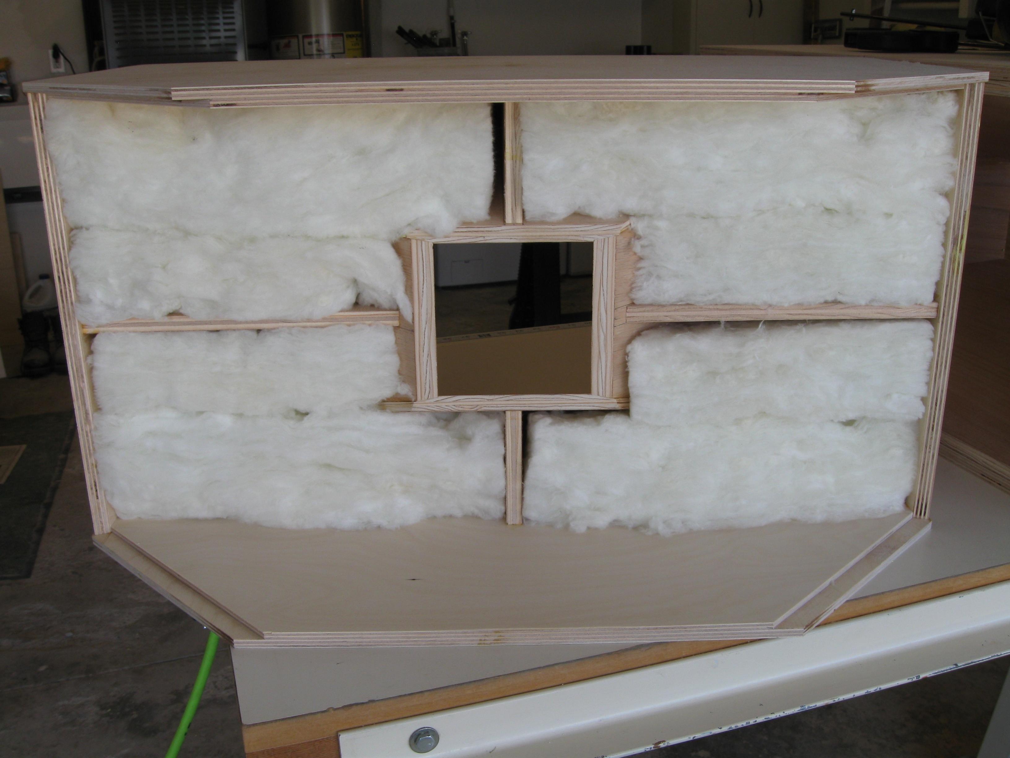

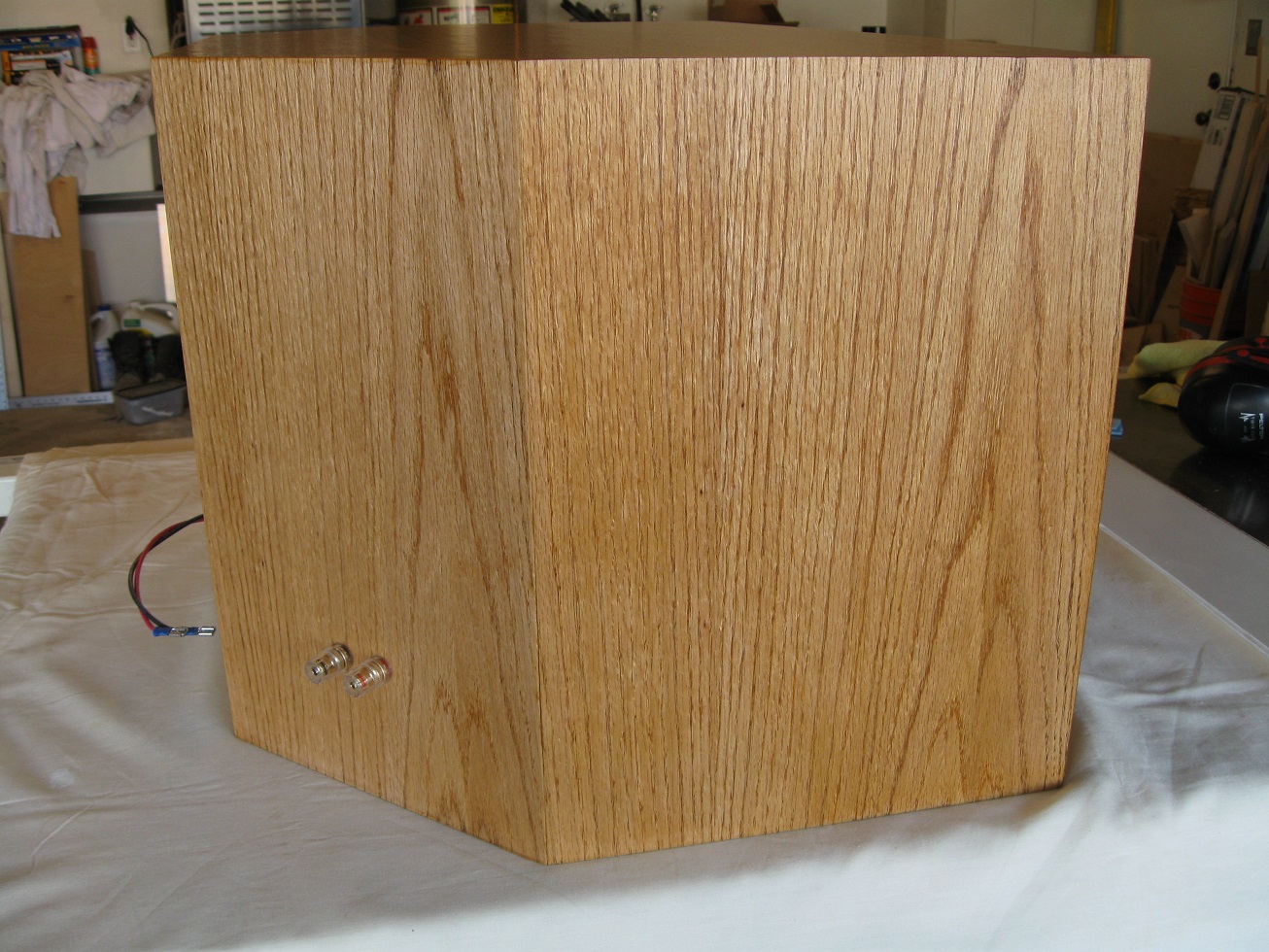

The mid-horn insulation and finish
The designer prescribes filling all spaces with insulation without compression. The insulation was cut in the proper shape to fill the spaces without being compressed.
attachment.php
attachment.php
Here is the mid-horn finished.
attachment.php
attachment.php
attachment.php
attachment.php

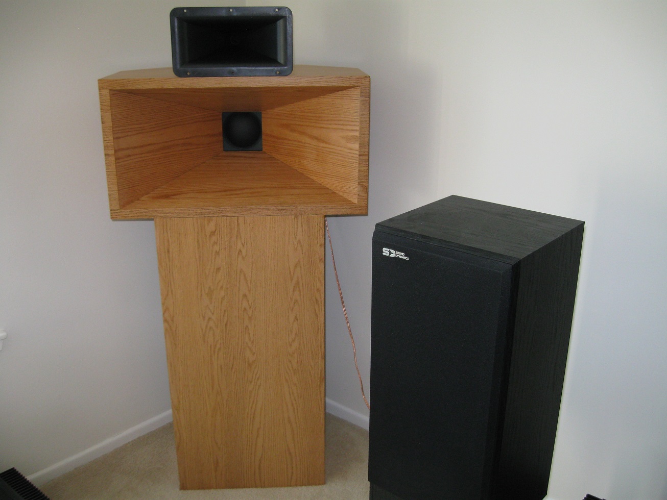

The complete speaker
Finally, here is the finished left channel sitting on the corner next to the box it replaced. I will build a case for the tweeter in the coming weeks. For now I am really enjoying my new speakers.
attachment.php
