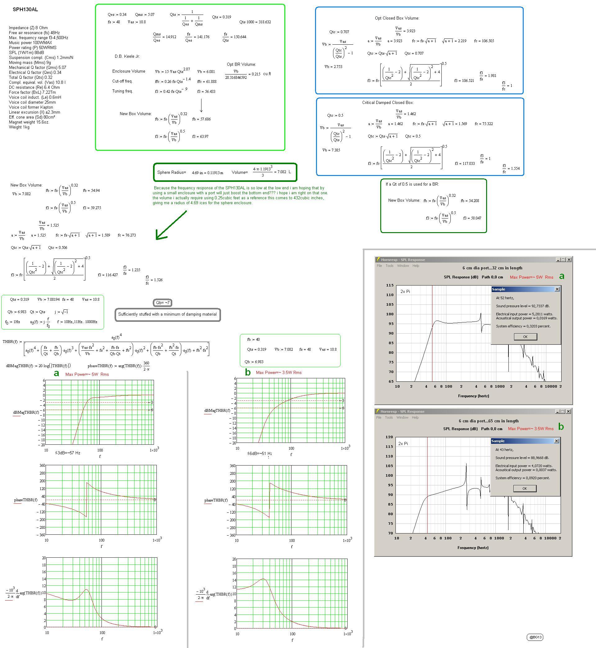

Ps: Supporting calculations : Posting a quickly made Picture:
