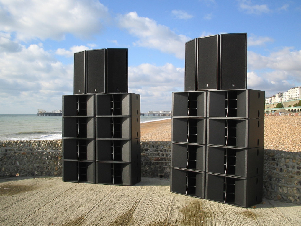

I am a french student and I plan to start building a big sound system with friends. I have some sound basics because I have several friends in the Dub/reggae scene who have passive sound systems like 2 scoops + 1 kick + Pavilion, tweeter etc.
I have always been fascinated by the world of sound because my father is lucky enough to own a pair of Infinity Kappa 8s. It was with these speakers that I really started to appreciate the well tuned sound systems.
I would like to broadcast House mainly on my sound system but possibly other styles like funk, disco, rock. I'd like to build something powerful enough. I would like to know which cabinets are optimal for this kind of music for parties of up to 250 people outdoors. I was strongly advised to use the Turbosound housings which sound apparently very good (Never heard).
I'm not quite sure about the configuration of the system but I would like it to look a little like this:
https://www.diyaudio.com/forums/attachment.php?attachmentid=752124&stc=1&d=1556188813
Of course I don't plan to leave directly on 2 "Walls" as in the picture, 1 is more than enough to start.
So here I am a little confused possibly about what box should I go for considering I want to play any music on my soundsystem..

Size comes a lot into play as larger subwoofers can generate a greater SPL and or go lower than smaller subwoofers for a given driver. EG:
Another Hopeless Attempt At Reverse Engineering a Danley Design
If you want to do this well the first stage is to define a specification. For example what area do you want to cover and what SPL at what frequencies. From this you will get the coverage angles and output capabilities of your system which then defines what speakers you need. As you want to play house music I would would say you need to go lower than typical (-3dB 30Hz would work) and need to have a sub bass system that can run for extended periods of time with sine wave input (low peak to average ratio).
FWIW, a lot of the rigs you'll see on the dub/reggae scene are far from HiFi. They have a particular "sound" and if that's what you're after, that's fair enough.
2500EU is a fairly low budget to be working with - a rack of Behringer NX amps (the cheapest I'd go for serious use) will eat half of that.
For most venues, a 3-way system works just fine:
1 or 1.4" HF, 10-12" mids, 15-21" subs. If you want to go bigger, take a serious look at Nexo Alpha - that is a 4-way system that's carefully thought out, and has a lot of good engineering behind it.
While a big scary stack of speakers looks cool, I'd advise against it for now - if you spread your budget thinly across many cabinets, you'll have a big pile of boxes that can easily be matched with a smaller number of expensive cabinets.
For instance, compare a B&C 18SW115 against an Eminence Delta-Pro 18. The B&C unit can take 3x the power, and has about 3x the excursion - the one B&C driver can do the work of 3x Eminence drivers. Which one would you rather carry and move around?
Once you have a few good cabinets, you can add more as your budget grows.
Chris
