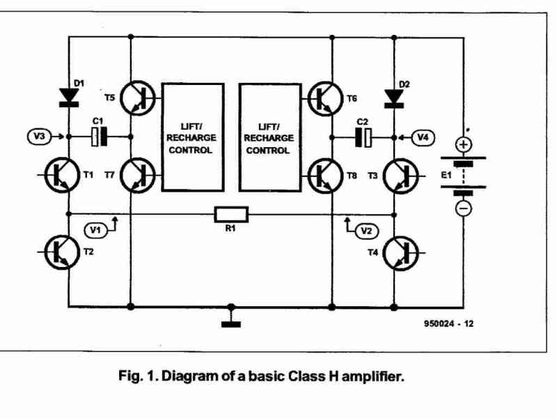

I've been thinking of adding a sub to my car system and after a lot of thought I decided that I need only slightly higher power than the main speaker amp which is about 20 watts (into 4 ohms) per channel. A chip amp being preferable as it cuts out the need for a smps. I find that there have been a few threads on this subject and the TDA1560Q ( whic is sometimes available here ) was discussed. However there seems to be some doubt about capacitor ratings and I had a look at the circuit diagram.
I found this comment in one of the threads :
".......C1 and C2 should be rated at more than 2x supply voltage ...."
The functional diagram of the TDA1560Q taken from the Elektor March 1995 article on the TDA1560Q is attached. The capacitors C1 and C2 are the ones used to enhance the supply voltage during peak signals.
Take for example the capacitor C1. Under normal conditions it charges up through D1 and T7 to reach a slightly lower voltage than the supply voltage ( say max 14 volts of the battery).
During music peaks the transistor T5 switches on and the capacitor C1 will appear in series with the supply voltage and the rail voltage seen by the output circuit will now be 28 volts ( battery voltage plus voltage across C1). D1 will be reversed
biased and so it will stay 'off'. However the voltage across the capacitor which was 14 volts will slowly deplete itself as the load draws current. Under music conditions the drop would be minimal. Under worst case conditions if the capacitor discharges fully it will get reversed charged by the battery but will be only up to the diode drop of D1 about 0.6V ( - V sat of T5 )as the condition will turn on D1.
So it appears that C1 ( and C2 ) do not need to be rated higher than the battery voltage and typically a 16 V rated capacitor is all that is required.
