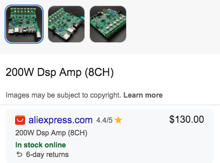

That said, multi-channel class D amps with digital processing are available cheap, one example:
DC-DC Voltage inverters are also inexpensive, so you are not limited to 48volts as the only operating voltage.

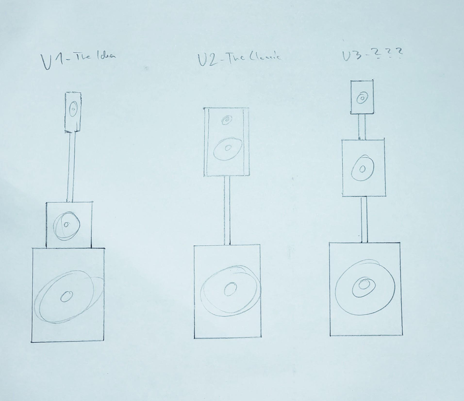

hey peeps,
thanks a lot for all the great ideas!
I finally found the time to fiddle around with the ideas and did some scetching:
Looks like i am going to settle with "the classic". This would give me room to have the following drivers:
Sub: B&C 12inch
Mid: Eminence 8inch
Tweeter: Same as above
This would put my total to more or less 300 Bucks for the drivers, which leaves a lot of budget for getting a suiting amplifier and DC-DC converters online.
If i do the crossover by myself, i won't have any power troubles with active crossovers (at least i figure so).
I'mma hop into the designer and will post, before i Build.

Just a little note that the B&C driver isn't much of a subwoofer. The tiny Xmax will result in distortion as soon as you put any real power in.
I'd recommend playing around in Hornresp or WinISD to figure out what's going to work well.
Chris
