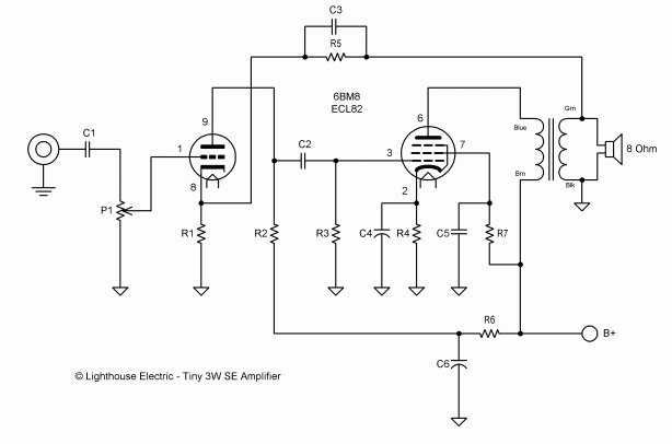

Long time lurker , I'm trying to build an ECL82 based tube amplifier based on this circuit.
I used an PT from an old EL84 based amplifier

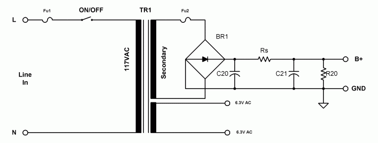

On the B+ I'm getting 380v at no load with a 1k 10w as the dropping resistor @RS is that normal? The secondary of the PT is around 270v. For C20 n C21 is a 47uf 450v cap.

Yes that is normal, the peak value of the AC waveform is 270 * 1.41 = 381V. The voltage will only drop when the amplifier circuit draws current.I'm getting 380v at no load is that normal?

It says 270 Volts plate voltage is what is needed.

If the amplifier consumes -for example- 50mA for each channel (100mA for both), on the 1k Rs resistor the voltage drop is 100V (1k*0.1A), so B+ -about- 280V (lower, because PT secondary voltage also decreasing if current increasing).
Try to test the PSU with 2k7 50W dummy load resistor and measure B+ voltage.
In this case Rs will be very hot, at least a 25W rating wirewound resistor were needed.

1k should work for Rs if there are two tubes -are you building in stereo? You'll need something like 2.2k for only one tube. Really your transformer voltage is too high for this project, but it will work.It says 270 Volts plate voltage is what is needed.

Remember the voltage rating for the tube, is across the tube measuring from the plate pin to the cathode, not from the plate pin to ground. Unloaded voltages don't really tell you much either. And honestly, tubes can handle being "over volted" pretty well within reason, excess current/dissipation is what kills them. I'd build it and pull it up slowly on a variac to be safe. Also the PSUD2 power supply simulation software works very well.

I'm surprised not to see it stated more often, but the easiest way to lower the B+ is to use a smaller first capacitor. The sensitive range is roughly between 0.47uF and 3uF. You can get a B+ range that is usually wide enough for most purposes. No need to take windings off the mains transformer.
