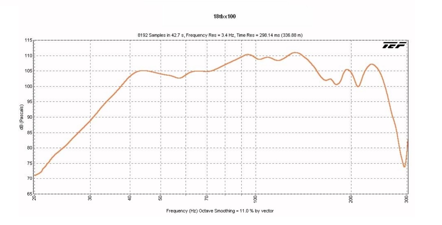

B&C 18TBX100
pognoot,
There are questions (for the same driver) that keep coming time after time.
You will be happy to know that the same driver is simulated here (some members already there). How would it be for a double sub?! You will need power for these babies (~ 1300W each@6Ohms, 2600W@3Ohms for both RMS).
B&C S18H - Subwoofer - B&C Component Options - 18” Woofer – 18TBX100 8 ohm
B&C 18 TBX100 - www.usspeaker.com
B&C Speakers
Compare response with the specs of the Dynacord Cobra-Subs >30/32/38Hz@-10dB.
DYNACORD – Cobra-4 Systems
http://www.dynacord.com/downloads/cobra_katalog_en.pdf
http://www.dynacord.com/downloads/cobrapwh_datenblatt.pdf
http://www.dynacord.com/downloads/PWH28-EDS.pdf

Thanks, as a first-timer, believe me I'm trying to do my homework before posting questions. I am aware of the G-sub design and the designs on the B&C website. I need dimensions that will work for my needs, and one of these needs includes packing in the equipment truck. I have Yorkville TX8s for my tops which are 24" wide, so I want these to be the same width so I can stack the boxes.
So, it looks like I will need to come down in external height to 48". I'll increase depth to compensate.
