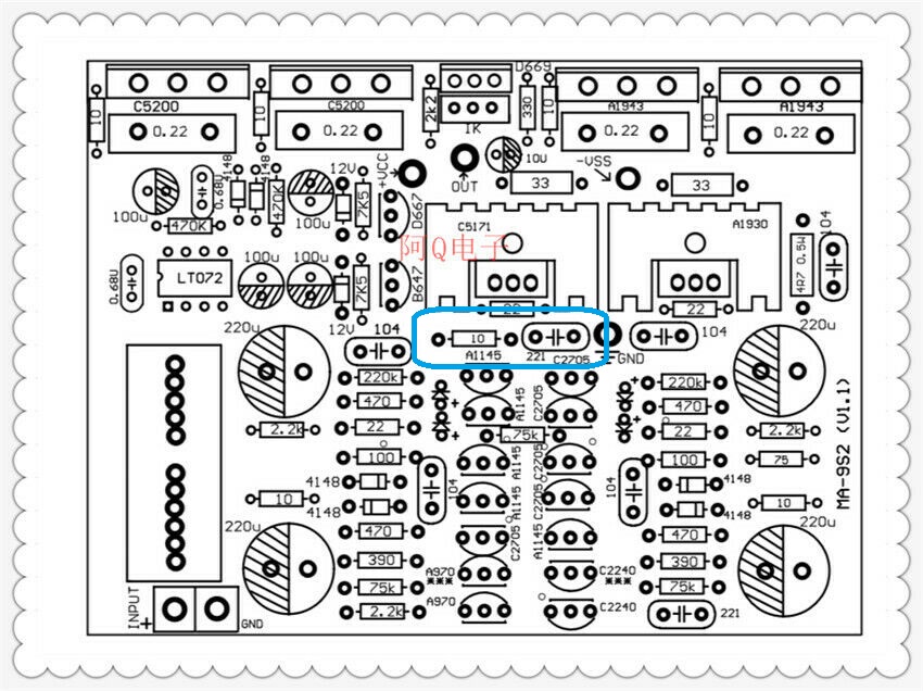

I just bought this pair of boards which implement a clone of the Marantz MA-9S2. They're all assembled and look more or less like the picture on the vendor's page at Wholesale Product Snapshot Product name is Assembled 150W+150W HIFI audio power amplifier clone Marantz MA-9S2 AMP C5200/A1943 free shipping. Each board is one channel.
Although I think I understand pretty much what to do next, I am getting the feeling I also might be in over my head as this is my first amplifier project, close to the first thing I've done with analog electronics, and the first project which requires that I build a power supply from parts. I am really just starting to learn and so there are gigantic gaps in my knowledge. I'm hoping that finishing this project will end up allowing me to banish at least some of the major gaps. I'm confident I can eventually puzzle this thing out, but would sure appreciate some help!
I understand that each of these boards wants a nice toroidal power supply to give it around 25v DC, so I figure I will get this toroid: 300VA Toroidal Transformers and then hook each output up through a bridge rectifier like this: Wholesale Product Snapshot Product name is KBPC5010 Bridge Rectifiers DIODE RECT BRIDGE 50A 1000V, followed by a capacitor or two for smoothing--that last part I'm less sure of how to do right since I am starting to think there are probably some important subtleties.
Does it sound to y'all as if I am more or less on the right track? I also still need to figure out where to attach things on these boards. The places that look like attachment points on the board, followed by what I think they're for, are:

Much of that discussion is beyond me but I finally did get back to this project and have a circuit that I think is probably close to what I need. (The link is to an online circuit simulator with what I have so far.)
Critiques most welcome!

OK, if you are uncertain what to do now but you've decided you need to start with a basic power supply built from parts you source individually, as your schematic suggests, you need to decide a few things like the numbers that will set the limits for your end result.
First though, if you check your schematic against other dual rail supplies, you'll notice you have used further split supplies for each rail, so much of what you have drawn is it is unnecessary. This circuit below isn't exactly what I mean but it's close enough to illustrate the elements and all you need for a basic dual bridge, dual rail supply.
A 2 x 25V AC transformer means about 35V DC power rails and that limits the amplifier to perhaps 50W/8R output. Going a little higher to a 2 x 35VAC transformer, gives about 50VDC and 100W/8R. No point going much higher unless your speakers are thirsty monsters and your room is large. A rule of thumb for a single toroidal transformer rating in VA, is 4 X the nominal 8R output power per stereo channel. So if you expect 100W/8R and 150W 4R, you need approximately a 400VA toroid. You could use less, like a standard 300VA transformer, assuming you don't use the amplifier at maximum power levels for more than transient signal peaks. Any diode bridges from 10-50A and 200PIV rated will be fine there. The smoothing caps should be 10,000 - 15,000 uF 63V and the bleed resistors larger, at about 2k 2W, IMV.

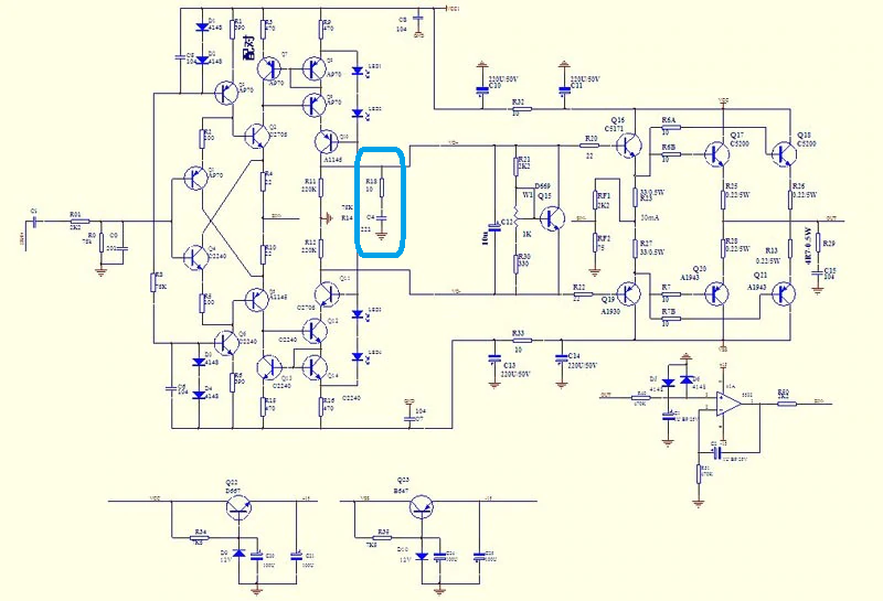

I made the MA-9S2 kit and I like it quite a bit. For a fun project I was thinking of building another with the gain reduced to 10 dB and making up the gain with one of the clone Marantz JC-2 pre-amplifiers.
I think the gain is set with the ratio of the 2200 and 75 Ohm resistors. Perhaps I should use 2200 and 240 Ohms?
What do you think? Does this sound like a reasonable project and approach?
Perhaps it will get a little closer to the original? I can not do much about the kit not being balanced. But perhaps this proposal brings the gain and number of stages much closer to the original?
Not as easy. It may oscillate, because the compensation was planned for higher gain.
Some simulation may help to check, if it is possible.

Yes, that is a real concern.
I was wondering how the MA-9S2 DIY compensation was done.
All I see as possible compensation components are the 10 Ohm and 220 pF which I have marked in the enclosed schematic and layout. Am I correct? Are those the components used for compensation in this design?
I wonder if anyone has a better schematic for this. I wonder if anyone has done any simulations on this design?
