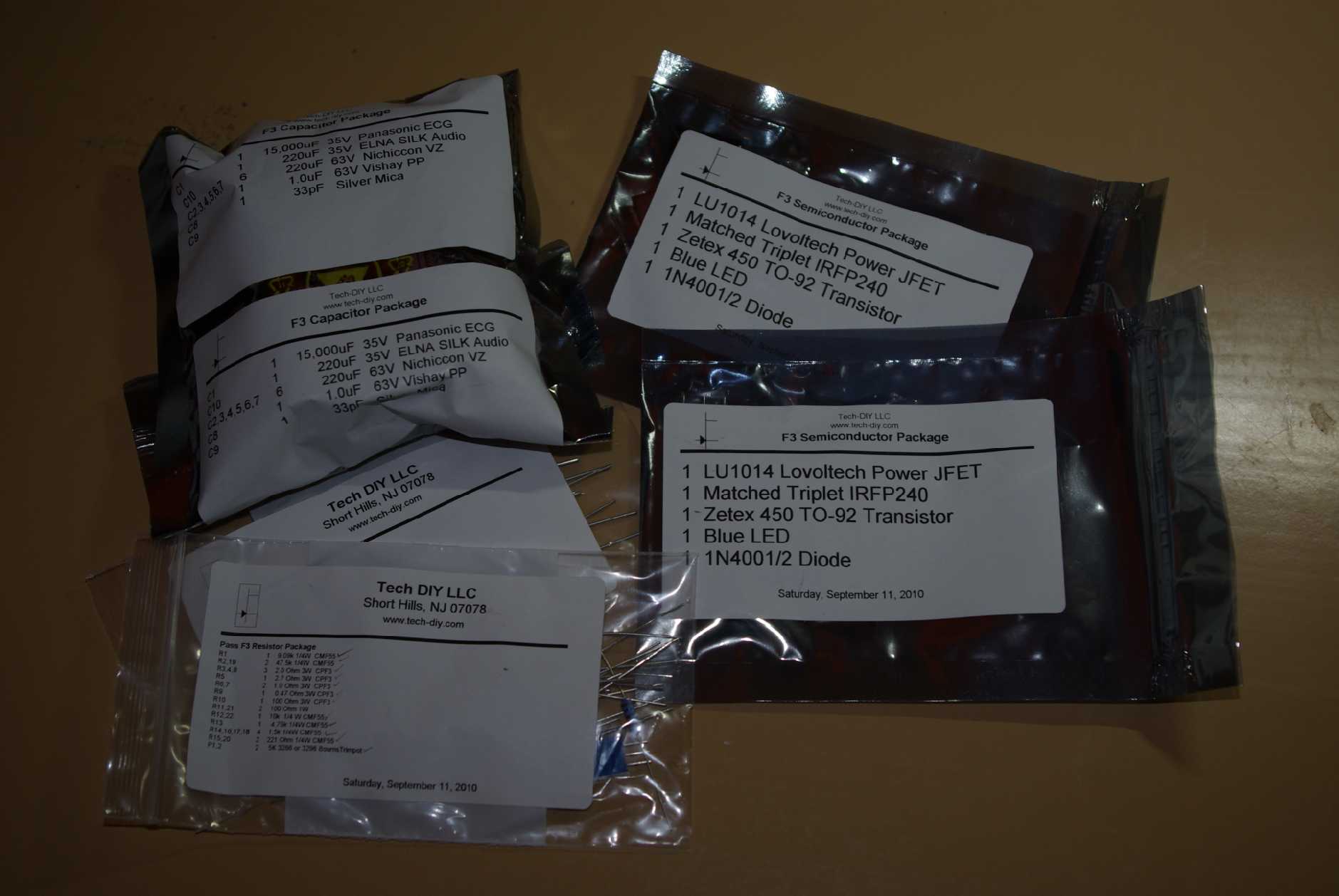

Hi Daniel,
not only that he (jackinnj) can, he will (see photo below)... 😉

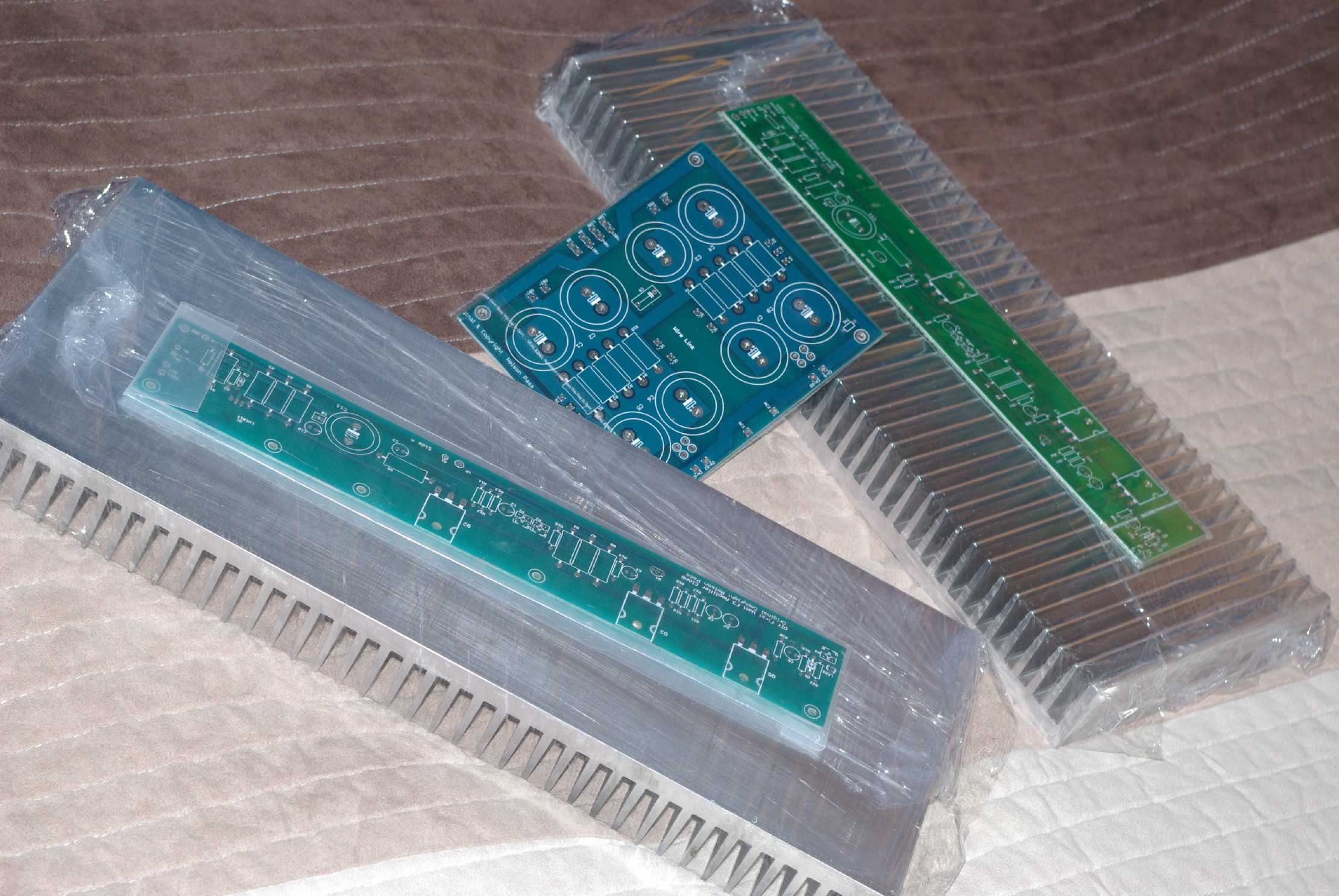

Second photo: suds PCBs & heatsinks 40x165x400mm (from other supplier)
:cheers:

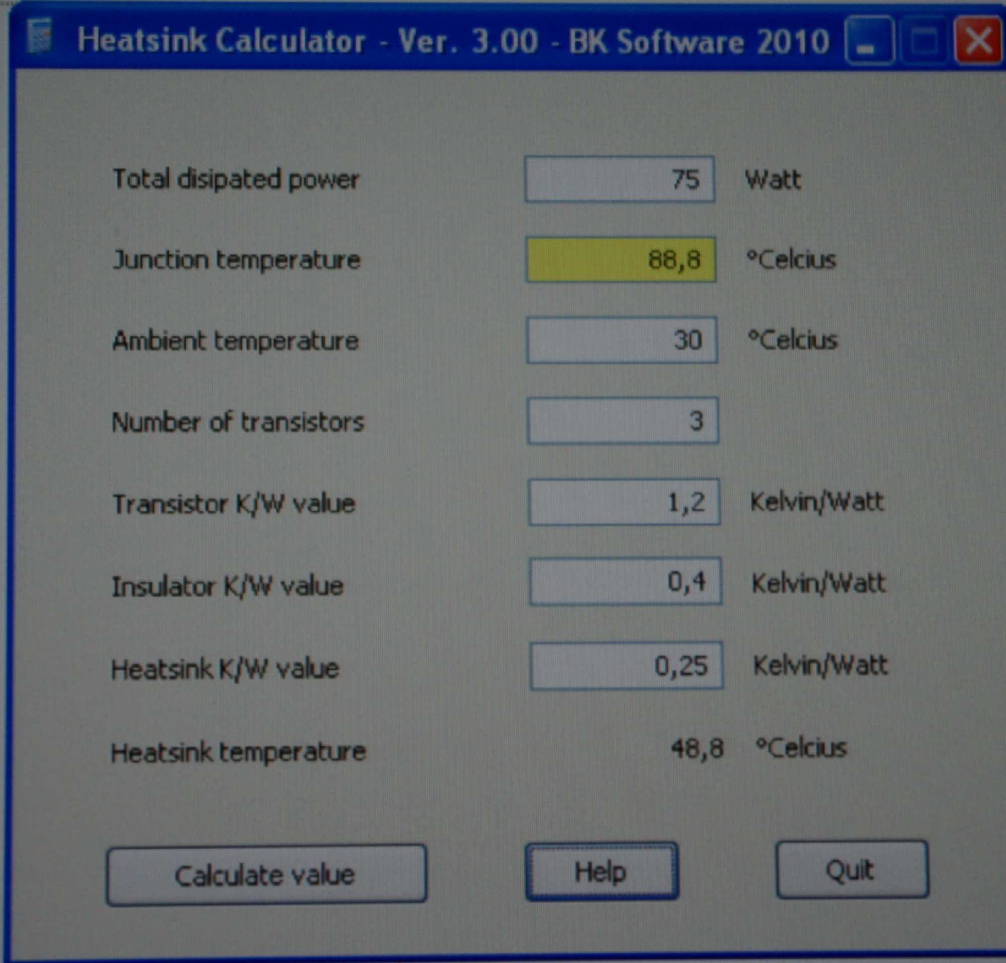

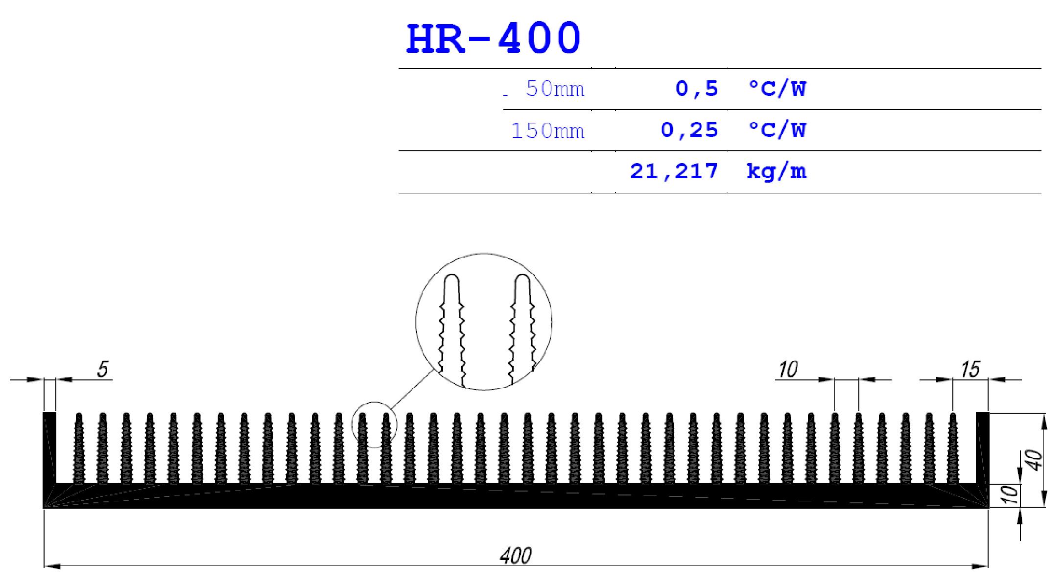

To the headsinks: 40x165x400mm do you belive that will be egnouth? for such amount of head?
Well, let's see...
Since F3 PCB is unusually long (300 mm) it's not easy to find appropriate HS.
My start point was info from Mr. Pass in original F3 thraed that minimum thermal resistance (TR) should be 0,25 Cel/W.
HS calculation (see below) confirmed above.
In catalogue of my HS supplier I've found that his HR-400 HS with 150 mm length has exactly needed TR (see below).
To be without any doubt on the safe side I've added 10% on length (from 150 to 165 mm).

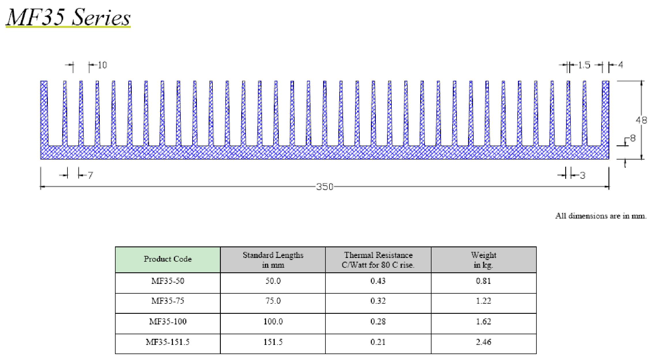

In original F3 thraed you can see different solutions. Some are very close to that criteria, some HS are significantly bigger. OK, i know & respect the statement (think it's from Mr. Pass) that there's no to big HS...

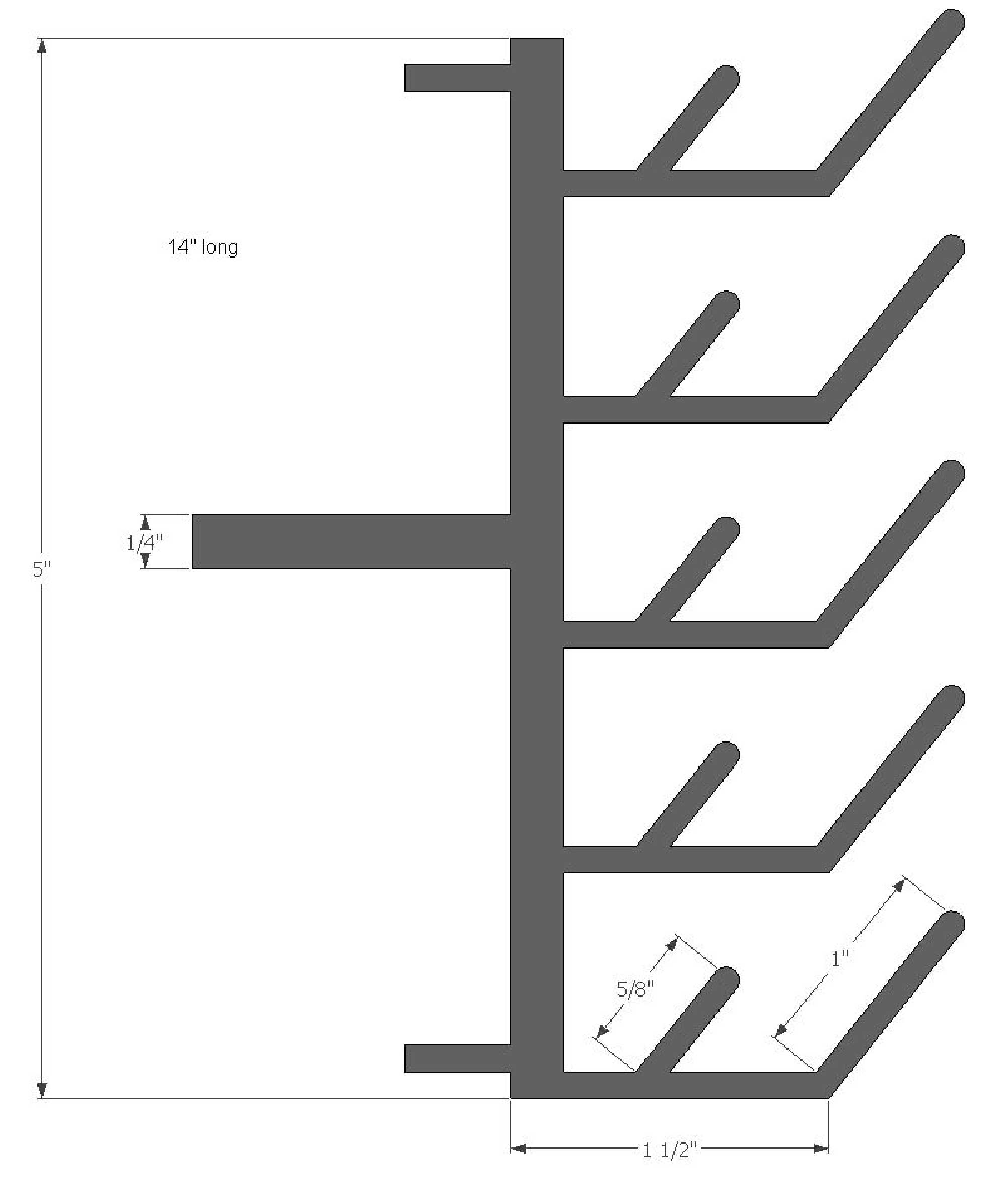

On below photos you can compare data of my HS with Conrad MF35-151.5 (used from member ZUM911). Not very different... Also interesting is to see and compare the original Nelson Pass FirstWatt F3 HS (see below). It's about 63,5x127x356 mm but with less efficient air flow.
My "gold reserve" is alu housing (i prefere skeleton building).
Any comment or advise is appreciated!

So the PCB´s arrived today a nice piece of work, unfortunately it one has a scratch on in, but its in a midle of a arrea of a resistor so I hope it dont makes a difference, its on the power supply part.
I would appreciate a diagram and parts list send as well, but only the boards arraived. Newer the less it took just a week to get them and they are pretty nice.
