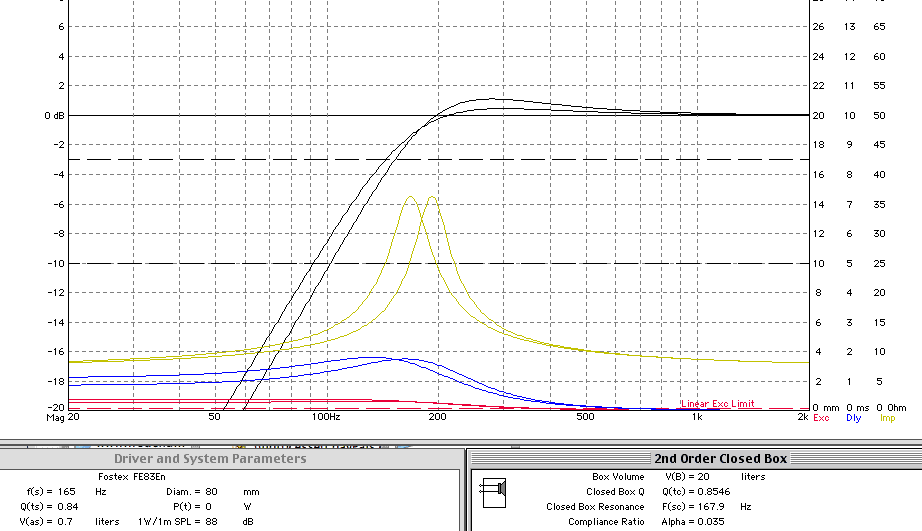

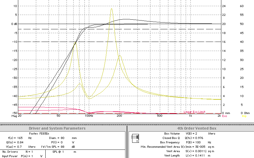

I did some sims. This driver sort of works in uFonken but rolloff is pretty ugly and xMax is exceeded long before 1 W input (2nd sim -- the well behaved curve is FF85).
2-20 litres sealed would be my recommendation... these sim pretty close, you get a slightly smaller bump at rolloff with the bigger box (1st sim).
dave
