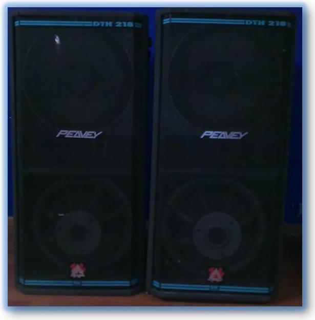

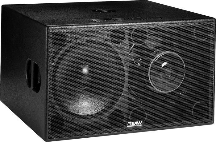

This arrangement ensures cancellation of driver non-linearity thereby reduces distortion. Some great examples of such boxes are EAW FR250,
Peavey DTH218 ..........
The EAW FR250 uses Eminence OEM 15" drivers.
I understand why it's done, but I don't really believe it makes much of a difference, when the space could be used for internal volume. I've built open baffle dipole subs with one driver reversed, didn't think it made much of a difference. You also get a bit of motor noise and basket chuffing off the back of the driver.
