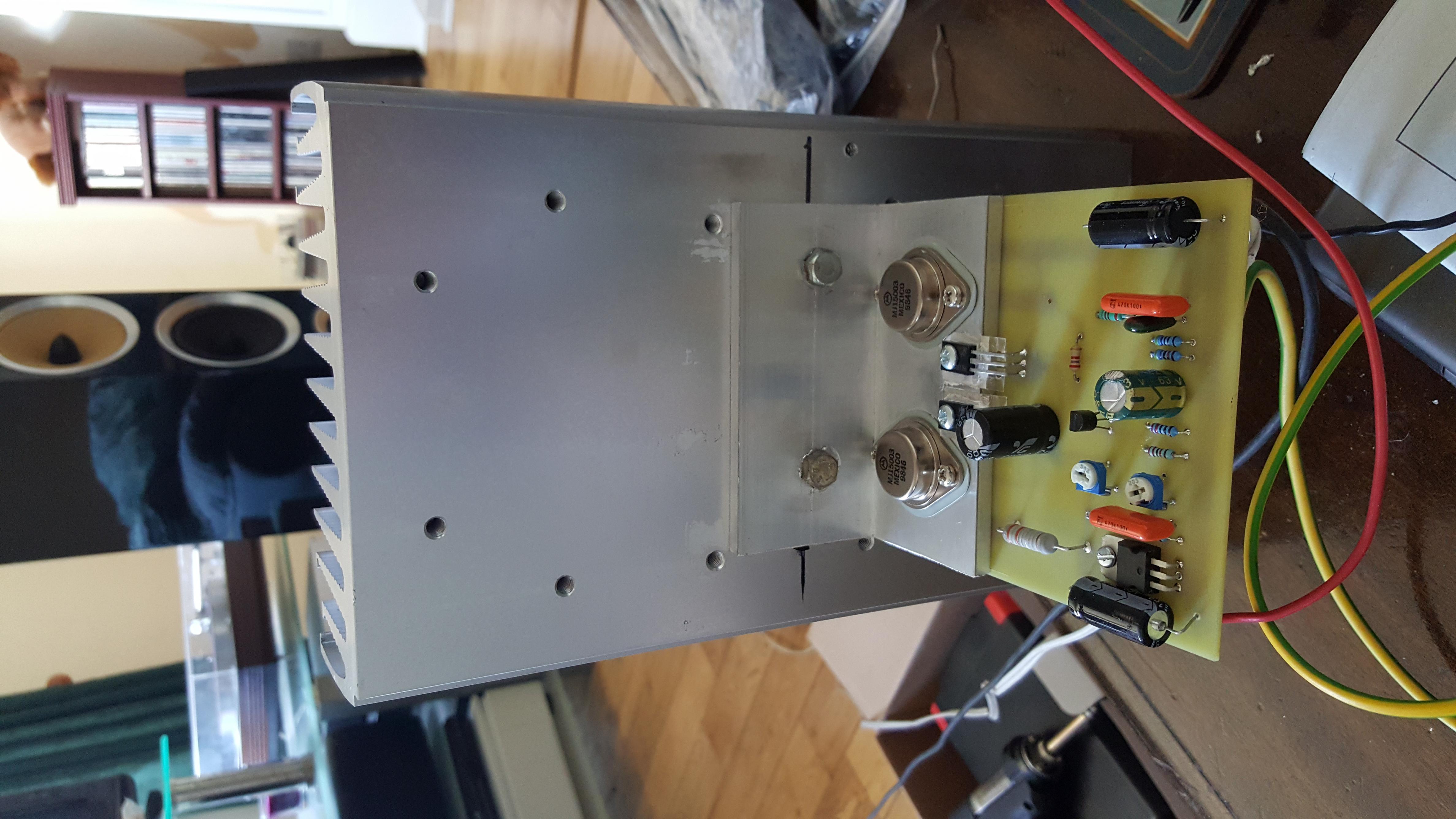

HOWEVER, what you call a huge heatsink might differ from what I call a large heatsink. This is what I would call a fairly large heatsink. In my example, that is a 25W Class A amplifier module.
The amplifier should be supplied with details of the power supply required.
It is not a wise idea to stack power supplies unless you know what you are doing.
If the amplifier requires +/- 35V at 1A then it is prudent to allow a margin of headroom above this (NOT VOLTAGE). Commercial designs sail as close to the wind as they can for cost reasons. In a DIY design you can be a bit more lenient. Allowing 50% - 100% extra current capability will always add reliability to the power supply. In this example you could aim for +/- 35V (NOTE THE VOLTAGE IS THE SAME) but with 2A capability.
