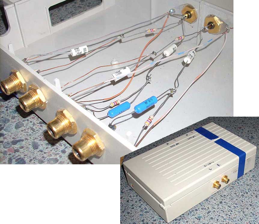

I presently have a pair of Cambridge Audio P500 Power-Amps Bi-Aping a pair of speakers (obviously).
I have heard through this forum that active cross-overs give a much more satisfying sound than passive cross-overs. I have also seen a few different ways of making active cross-overs ranging from what look similar in appearance to passive cross-overs to rather advanced complicated looking designs (to a beginner like me).
I would like to give active cross-overs a go at some point but would rather not have another separate box on the rack. As there is a lot of empty space within my power amps could I install suitable filters into the input lines of the power-amps?
Here is a random photo from google of the inside of the power-amps to show the available space:
I've seen planet10's creation on here that amounted to little more than a plastic box with a few components stretched between the input and the outputs, not a circuit board in site! 😛 Would easily fit but would it be an improvement?

It's the skill of the cross-over designer that determines how satisfying the sound is! There is a whole lot more to designing cross-overs than just putting some values into a design program.
Passive and active crossovers are equally good at producing crappy, lame sounding speakers. They can both result in excellent speakers, too. They are each just a means of executing the crossovers. Both types have to be carefully designed.
It sounds like you are getting your feet wet. I wouldn't build crossovers into your amp cases at this point. You might consider springing for a Behringer DCX2496 and see where that takes you. You can learn a lot along the way about crossovers.

For sure a DSP crossover (like the Behringer) is a good learning tool. You can program several different crossover slopes & frequencies into the unit and quickly switch from one to another and listen to the differences.
Getting back to your original question, the answer is YES. They can be quite small and you could easily fit either an active or passive (low level) section in your current amp chassis. You obviously google around and after a bit of that I imagine you'll be quite up to speed. There are some issues to be addressed like grounding etc but nothing insurmountable. Good luck, cheers Jonathan (ex-southern Blighty)

The passive crossover in your speakers will interact allot with the inductance an resistance of your speakers. When you mover the crossover to before the power amp you remover this ineraction. So you can't simply place a scaled copy of the crossover before the amp, you end up having to redesign.

The passive crossover is dealing with the complex impedances of the drivers. Hopefully to good advantage. I would reference the Zaph SR71 to see how few parts he can use. An active does not worry about that, but you may still need to deal with BSC, a notch or hump here and there, and rolling off the tweeter. I use my DXC exactly for that on the bench. Not cheap though. I can't say I have ever exactly translated one implementation to the other, but I can learn enough on the DCX to get a good start on the passive. Final voicing is always be ear. Even when I use an active crossover, I frequently still have some passive network. At a minimum, you MUST, read that again, MUST still have a blocking cap on the tweeter. MUST. If anyone says not, they are a fool, ignorant, or own stock in a tweeter company. All three are represented within these pages.
A line level passive crossover can work only if it does not mess up the amp input stage. Oh yea, it will. Some strange things can happen as you are playing with the input impedance of the amp. If you model it in Spice, you can see it can do very bad things for distortion. I did not understand this until I got a thrashing over in the Lounge on amplifier design. Easy to give it a try.
I think most would suggest an active crossover. You can tap the mains power for a good low voltage power supply for op amps, or even build one using FETs that runs off the same power as the input stage. You have the space for a fully independent supply.
