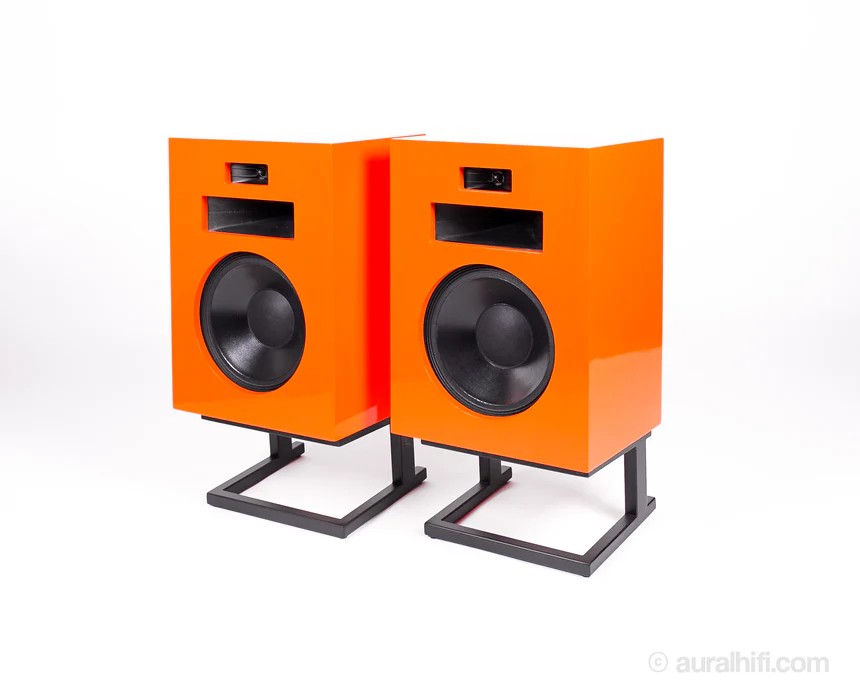

Just to show one example, here some pictures of the Klipsch Hersey but I'm not fixated on the Hersey or Klipsch in general.

If you want to use the heresy as an example, I'd probably bring the HF and MF to the front of the baffle.
That would be something I would 'automatically' fix and not even thought about mentioning and I wouldn't want to keep that close to the original to repeat such a bad error, so I couldn't agree any more! Mounting the horns from the front wouldn't be a drastical design change in my opinion but that alone would greatly improve the sound. I've posted the Hersey as example but I'm not a great fan of the EV T-35 tweeter, it's not a great task to find a CD which performs a lot better, even among the cheap stuff I will probably use.

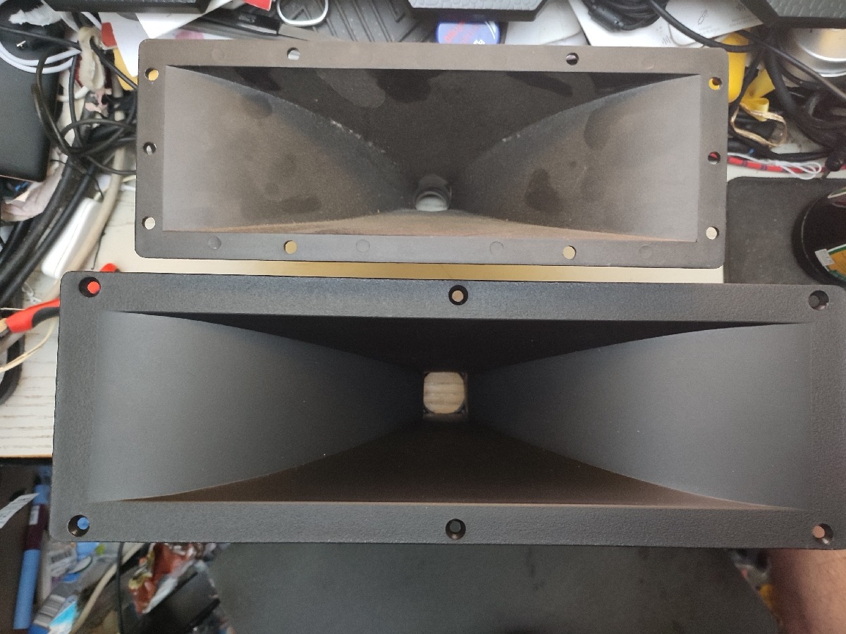

What sparked my idea to build a vintage style speaker (besides having too much laying around, being bored and running out of space) was these horns:
Please don't mind the clutter on the desk - but don't they look extremely vintage? I mean, like out of a 70s Klipsch Heresey? I don't like the P.Audio tweeters of the recent Klipsch Heresey even if they are a lot, SOOO MUCH better than the EV.
Yes, these horns don't have a great dispersion, dropping off off-center horizontally, vertical is worse. I've got Pyle, Celestion, Monacor, Kenford, Oberon and no-name CDs I could use for the tweeter horns. I've got Selenium, Kenford and no-name CDs I could use for the mid horns or Kenford or Celestion CDs from the mids and highs. Or use completely different horns to cover mids to highs from 15" to the top end.
