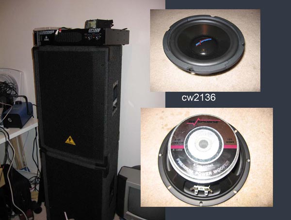

Hi I'm a mobile Dj,
first of all i know jack about all this.
I use a behringer europower ep1500 amp with two behringer 200watt b1520 loud speakers.... but.. i want more bass... i'm 40% deaf (natural Causes).... i like to feel the music
i have 6 cw2136 speaker drivers lying around the house.....
i bought them 8 years ago... they are 8 inch 120rms woofers response cat:CW2136 and i want to make a subwoofer..
with still 8 ohms impedence.. 4 of these drivers are still in boxes.
I made subwoofers with two of them, eight years ago from a guide in the elctronics australia magzine. And i bought another four drivers the same... but i never got around to using any of them them.... i only started to use the two subs i made a year ago in my lounge for my cinema... shakes the room.. great bass..
so... what is the best set up? i want bass, bass and more bass.
I have subwoofer crossovers..... i have tweeters and i have mid range drivers. i can buy a pezzo horn driver if need be... but i just want to use these damn drivers for something..
I don't totally understand all this stuff but the amp is 2x700 watts.
I don't even understand the make up of a sub.. the ones i made the driver faced the floor....
is adding 6 120 wrms 8ohm woofers in a parallel or circuit ever going to work?
i did a search on this sight and didn't find much. please help.
something like the behringer bb410 except with 8" woofers
regards
Dale

maybe a huge vented box for the couch to sit on? That would give you tons of volume, and the couch could provide mass and damping, and the vibrations would travel to your rump quite well. I would download and mess around with winisd, and try to tune the monster for a peak around 28-30hz. if i recall correctly your chest cavity resonates somewhere in there, that could make for some fun!

For max bass, go with a vented box,
but for high power use a larger speaker would survive longer...
A set of two speakers in parallel gives 4 ohms impedance.
Then put wo sets in series to give the eight ohms you specified.
Total of 4 speakers gives 120 x 4 watts = 480 watts.
Note the post above gives box size for one speaker. Muliply by four gives an indication of what you would need for four speakers.
You could use isobarik mounting to reduce size of box. Refer Win ISD-pro
But why the requirement for eight ohms?
not really subs
Above cab volumes are for 1 speaker, multiply by the number of drivers you're going to use per cabinet
of course these aren't really subs, going down to 39Hz, but should be adequate for most music;
and you can't wire up 6 to get 8 ohms,
3 in series per side will give you 12 ohms, which will cut down available power (but probably save the speakers)

The drivers that you're going to use are far less efficient than a typical PA-woofer.
To get an idea: 4 to 6 drivers in one bassreflex cabinet combined would add about the same oompff as only 1 B1800X would (with active crossover). Depends on Xmax as well, which I don't know exactly for your speakers but 5 mm as I used should be a close enough guess.
Closed boxes are seldomly used in PA and for good reason.
Since you already have the woofers lying around you could give it a try but I wander if these woofers would really handle the 120 Wrms long term.
A 1520 with a B1800 per side would be a good setup for 150 people indoors (with 2 amps and active crossover).
Remember: By placing a sub against the wall or in a corner you will gét louder bass for the same input/power, compared to a sub standing away from the wall/corner.
