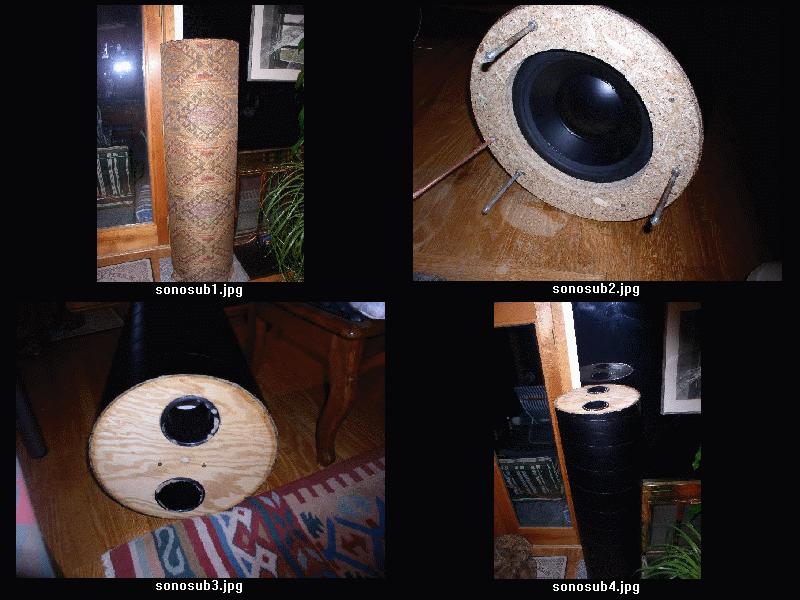

here's a 12" partsexpress Titanic MkII sonosub from ~2001
The hardest part of building is the endcaps, I turned mine on a Shopsmith lathe, but with a large sander you can clean up a jigsaw cut, or you can make a circle template for a router and cut them...

thanks for the advice
i'm pretty good with woodworking and my questions are
more towards how do i determine the dimensions of the sonotube?
there must be a formula where you enter the driver charectoristics
and you end up with the tube diameter, length, port diameter
and lenghth.
that is what i am looking for.
thanks again.
my searching skills are not turning up with much.
any recipes on line?

You enter the subs characteristics into a sub modelling program to determine the volume needed. (WinISD comes to mind). Then you use the sonotube calculator to determine the diameter and length of tube that you need.
http://www.quux.net/roo/diy/sonosub/sonocalc.html

There's a TON of information out there. The volume of a sonotube is 3.14159 X (inner diameter/2)^2 X height.

You design the enclosure just like you would any other ported/sealed/TL/bandpass. Then you just build the sonotube enclosure with the correct volume/tuning/port area/etc.
