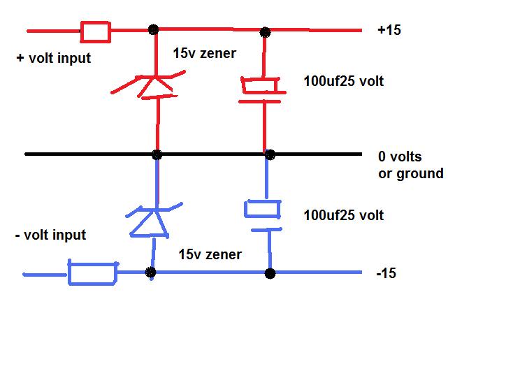

Also on the dual power supply, A resistor/zener diode can be built to power my preamp? It requires an AC-0-AC supply, can we do it?
Like this... you feed it from the main -/+ supplies to the main amp.

The PSU I posted a few minutes ago... it really is that easy.
The ground is the main ground in your chip amp. The - and + inputs are from the main reservoir caps... so it just connects across your -36 - 0 + 36 rails.
The resistor is chosen to allow a few millimaps to flow through the zener... if you tell us how many opamps it's feeding in the preamp we can work the value out. It's very non critical though.

The PCB has on board regulators. So we can still retain those. It says they are 78/7912 type.
The only difference to my circuit is that we would choose a higher zener voltage, say 18volts and feed the original connections on your board. You can feed DC into the bridge rectifier with no problem.

The zeners... it works like this. 36 volts to begin with. The 7812/7912 regulators need around 15 to 25 volts input. Each reg draws around what ? 3 milliamps at a guess. The 5532 draws around 10 to 15 milliamps. So thats around 18 milliamps per rail. Call it 25ma for a good margin.
So for the resistor we have 36 volts less the zener volts (lets settle on an 18v zener) which gives 18 volts. Thats the voltage the resistor has to drop. We allow a zener current of around 10 milliamps.
So the resistor needs to handle 18 volts at 35 milliamp maximum. That is R=V/I which is 16/0.035 giving 514 ohms. Call it 470. Wattage is (v*v)/r which is (18*18)/470 giving 0.69 watts. So a 1 watt carbon or metal is ideal.
The zener wattage is the same. 18 volts at 35ma.
That is worst case calculation for the zener meaning no current drawn by the preamp (not connected). When the preamp is connected then the preamp current is subtracted from the zener current. The zener current falls (still always with 18 volts across it) and so the zener wattage drops as the load current increases.
The above values are very conservative... and worst case. Typically a zener current of 5 milliamps (rather than 10) would be more than adequate and the preamp load current will be less than the 25ma I allowed.
So that means you can increase the value of the resistor to reduce current and heat.

And for the zener your saying a 470ohm 1 watt resistor will do the trick. I just had a look at your paint brush diagram, and the resistors are in series on the rails, with the zener and cap shunting, is the cap a polarised type, running same polarity as the zener?
