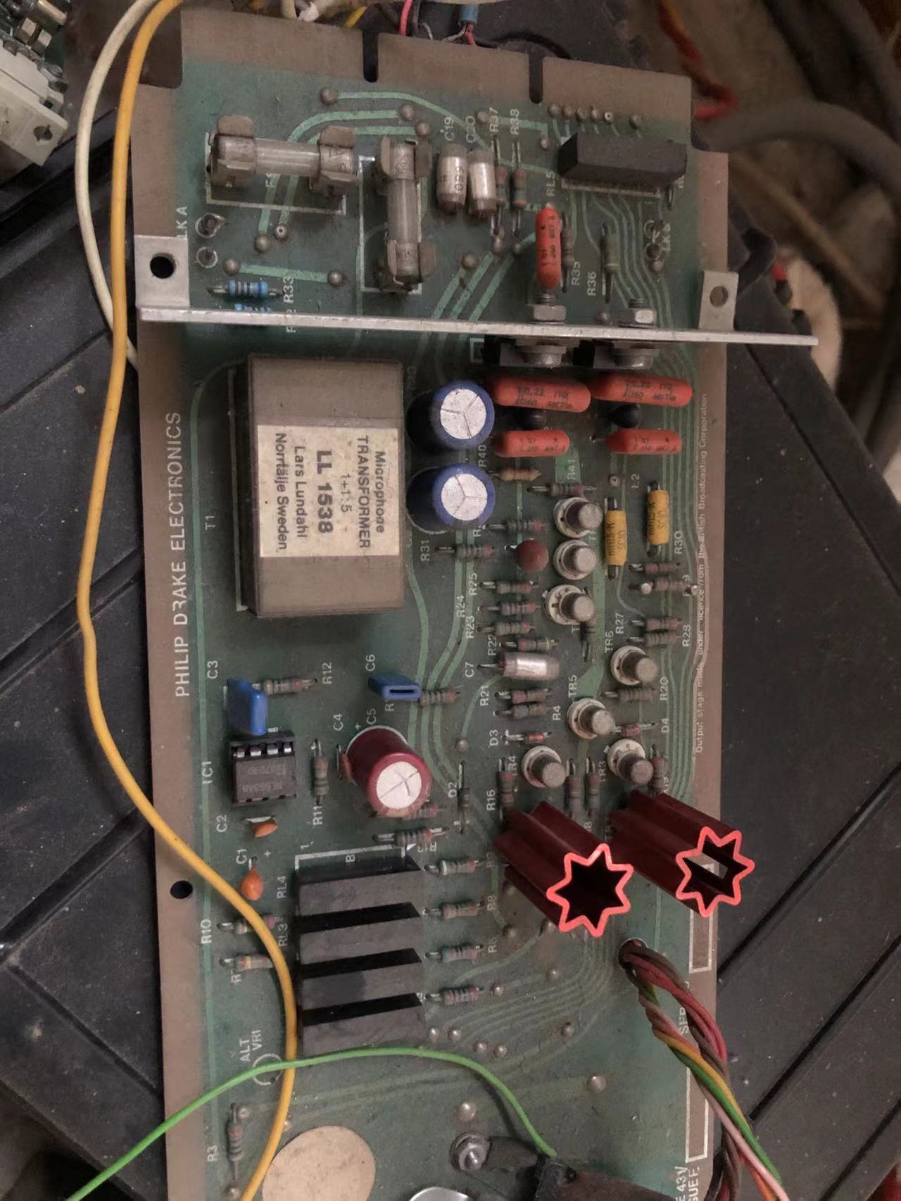

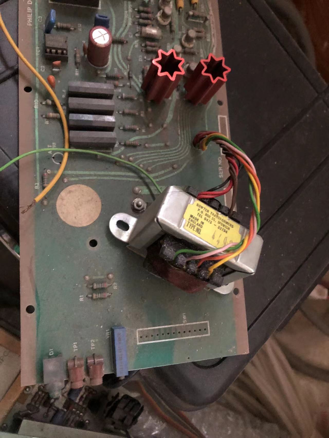

I have a retired microphone amplifier motherboard from BBC. It has ll1538 input transformer, sowter output transformer, class a driver circuit and 5534 amplifier.
Now I want to put it into the chassis to continue its service, but I lack a 48V phantom power supply. I heard that this 48V power supply has a great impact on the recording quality, so I want to build a low-noise 48V phantom power supply, but the commonly used LM317 can only output 40V at most. Is there any other scheme recommended?

It is probably more important to have low noise than low ripple for a phantom power supply. This is because the supply is presented to both the (+) and (-) differential inputs of the preamp and supply irregularities (hum and noise) cancel out to the extent of the common mode rejection ration of the preamp, which is always better at low frequencies than high. An RC/RC/RC filter, not a chip regulator, is a better approach. See the link below for ideas:

Actually an LM317 can handle 40 V between its input and output, so you can go a bit higher as long as the output is never shorted and you don't make the output decoupling capacitor too large. Besides, there is an LM317HV that goes up to 60 V between input and output.

You are not going to keep the unloaded phantom supply voltage in its specified 48 V +/- 4 V range with +/- 10 % mains variations without some sort of regulator, but combining a regulator with an RC filter can be a very good approach.

Thank you for your suggestion. I read the manual of 317hv. Its 10hz-10khz output noise is 0.003% of the output voltage, 48V x 0.003 = 144mv square root Hz. It seems that the output noise is still very large. I don't think IC output seems to be a good scheme. Maybe I need to consider the scheme of voltage reference + power tube current expansion?

Sorry, I forgot to count the percentage. Actually, it should be 48V * 0.000003 = 144uv square root hertz. Is this correct? Adding RCRC filtering is a good suggestion.

It's 1.44 mV over 9990 Hz, so on average just above 14.4 uV/sqrt(Hz).
With, say, 60 dB of common mode suppression, that's a totally unacceptable 14.4 nV/sqrt(Hz) of differential noise. You indeed need a filter.
One approach would be decoupling the reference resistor of the LM317HV, adding diodes if needed to prevent damage at switch off. Another is to put an RC filter between the regulator and the microphone.
A 48 V phantom supply is normally connected via two well-matched 6.8 kohm resistors to XLR pins 2 and 3, or via a single 3.3 kohm resistor to the centre tap of the primary of the input transformer of the microphone amplifier.
In the latter case, instead of using 3.3 kohm, you could use 2.7 kohm in series with 680 ohm, with the 680 ohm on the side that connects to the regulator, and put a 100 uF electrolytic capacitor from the point where the resistors are connected to each other to ground. That will suppress noise from about 3 Hz onwards.
