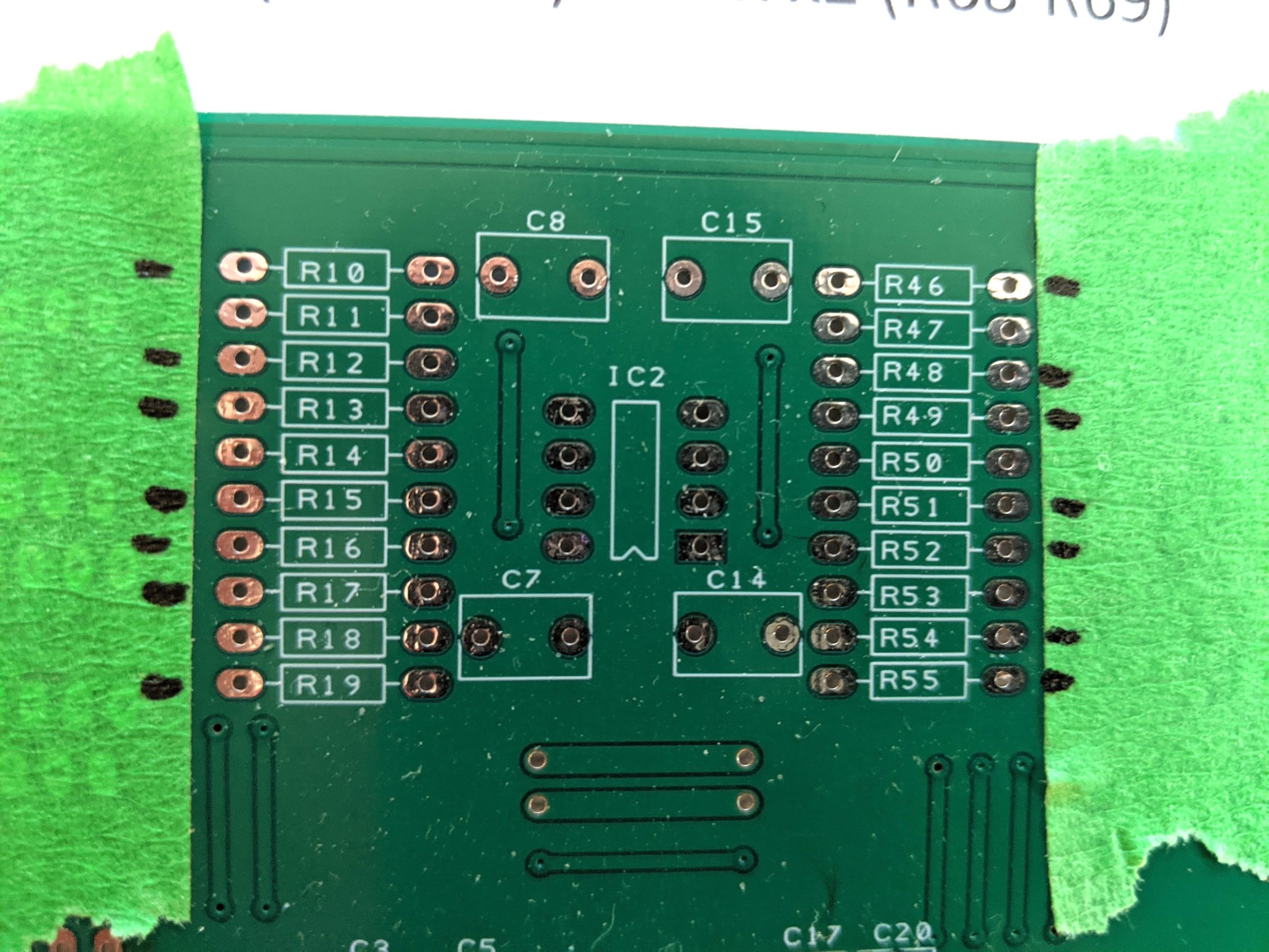

Has anyone here ever built your own KEF KUBE 107, or used the kit? Since it’s extremely rare. I once found it but couldn’t afford, cost is about 600 USD. Anyone has its schematics, pcb layout, part lists, could you please provide us? I’ve already owned a KUBE 104/2. Its power supply is 220V version, part no. SP2123. If I built the KUBE 107, can I use it with my 104/2 Kube’s power supply?
That is exactly what I am doing. I am producing clones of the KUBE 200 from KEF white papers, and also making a 107/2 by applying the 107/2 Bass Extension Correction on a KUBE 200. 7 resistors per side. A KUBE 200 can be turned into a KUBE 107/2, but will retain the KUBE 200 LF and HF Contour.
I am very advanced in the process. I will offer kits for people to solder themselves.

I understand the need for some people to have complete units. Which is why I will most likely ask some tech savior members of this group if they want to do the assembly for others. Unless I can find locally a Indian or Chinese techie working for a lower wage than the usual snobie audiophile rate ;-)
BTW I 3D printed a fascia to test fitment and it is perfect. I even improved over the original design so that the fascia lines up perfectly on both X and Y axis by integrating a lip.
Final casing and fascia shall be CNC machined aluminum if I can manage to group a production for at least 20...
You can also buy a cheaper KUBE 200 and swap 17 resistors in the Bass Extension Correction section of the PCB and (almost) end up with KUBE 107/2
