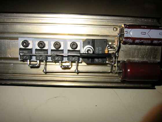

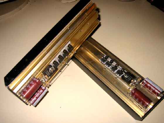

Yes I have already try it with a small torroidal transformer (2x20v 100 VA) just to to chek if everything is ok. Fortunately both channel are working perfect an i dont have any self oscillations Hummm etc.
In a few days I will have also the aluminium parts for the chasis and then .... 🙂
I will post some pics later .
The whole story started because I have a Pass Zen 4 and Im very satified with it but sometimes i would like to have some more power. On the other hand the GC is cheap enough (some versions not) and very easy to built so i said to my self "lets give a try", thats all.
