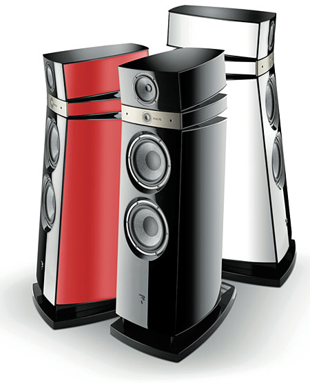

I am doing the reading to bring myself up to speed enough to start my first speaker and tube amp project. I have a ways to go, but I thought I would post this as an academic exercise.

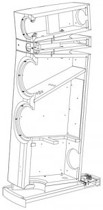

I just ran across these speakers, and they look quite nice, and the review I read was quite favorable (they should be for the price!). The drivers are available (I didn't see the tweeter, but I didn't look too hard), and there is a diagram that could be examined to get ballpark dimensions. The crossover points are specified.
Questions:
Is this project relatively feasible? In particular, with the info provided, is the construction a shot-in-the-dark, or could this be modeled relatively easily to promote a favorable result?
Is this project even a desirable one? That is, the drivers are expensive and there could be equally "good" speakers designed and constructed for far less. I realize this is a super subjective query.
Lastly, being new to the DIY community and generally ignorant, what are the general ethical views and considerations regarding the use of a commercial design as a starting point for a project like this?
Thanks!
Focal Maestro Utopia III loudspeaker Specifications
Description: Three-and-a-half-way, reflex-loaded, floorstanding loudspeaker. Drive-units: 1.1" (27mm) inverted beryllium-dome tweeter, 6.5" (165mm) W-cone midrange, 11" (270mm) W-cone woofer, 11" (270mm) W-cone subwoofer with Damping Control System. Crossover frequencies: 90Hz, 220Hz, 2.2kHz. Frequency response: 25Hz–40kHz, ±3dB. Impedance: 4 ohms nominal, 3 ohms minimum. Sensitivity: 93dB/2.83V/m. Recommended amplifier power: 80–600W.
Dimensions:
57.9" (1470mm) H by 17.9" (455mm) W by 30.3" (770mm) D. Weight: 255.7 lbs (116kg).
Price: $49,995/pair!!!!

It would be...
a big and expensive project - you can buy Focal drivers but they are very pricey, and many people feel they are outperformed by other, often less-costly drivers.
The cabinets are going to be a chore, and IMHO should only be undertaken if one is absolutely obsessed with having a commercial lookalike.
Then there is the crossover which, unless you can find a diagram for the real thing, you will have to design from scratch.
What is your budget, and what is your goal? A clone for the sake of a clone is to me is going down a somewhat misguided path, especially for a beginner. If your primary goal is clean, accurate sound there are dozens of established designs already out there that may suit your needs and at a far lower price point.
I stronly recommend looking at the designs of Zaph, Troels Gravesen, Humble Homemade Hi Fi, and lots of others that are all over this forum for your first venture into DIY speakers.
The Focal drivers that are available to the DIY world are at least one generation behind Focal's current product. You can get a 6" W cone woofer, but it won't be the flower power version. The Be tweeter and 11W drivers are not available anywhere I have seen.
I like that look (The older versions were better looking to me), but it's a heck of a first project. If you want the look, how about starting with a two way that looks like the diablo utopia? I like the Seas W15CY001 better than a Focal 6W4254 except for the bottom end. The Excel is a bit cleaner.
As it happens i'm actively looking to buy a set of Utopia III, used.
I've audited the entire range, except the smallest Diablo model.
Cloning a JM Utopia will be a whole lot of work, and costly, without a chance of getting even near the real thing, imho.
As a first DIY loudspeaker project i'd guesstimate it would turn out a disaster, i've witnessed awesome clone builds, but none were 1st time loudspeaker builders.
As a side note, LSP's as these Focal models beg for one heck of a system upstream. If you don't have that yet, your Jacques Mahul clones will be written off by the time you do.
