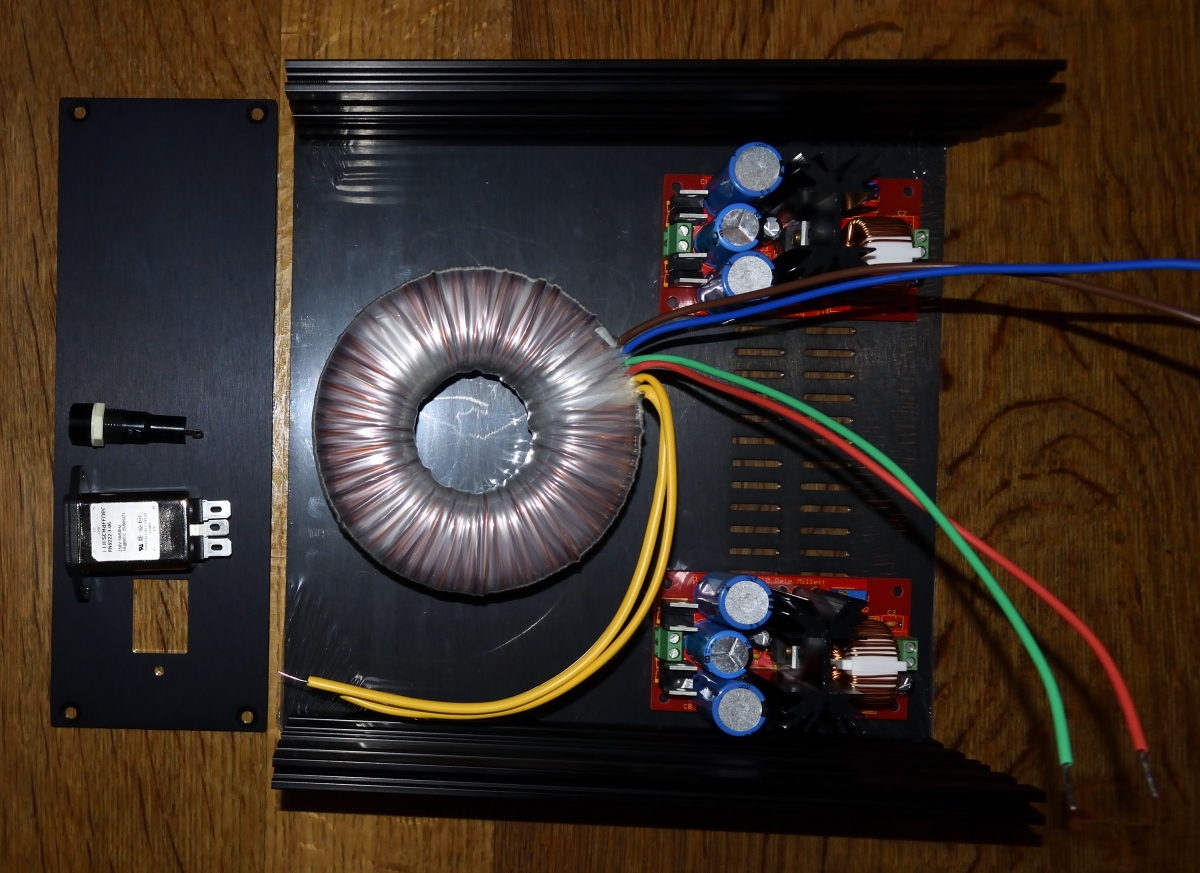

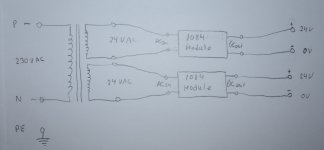

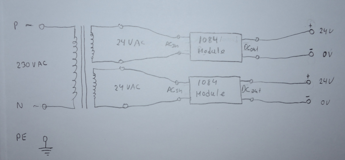

I am building 24 VDC regulated PSUs for preamp use in the moment and need some good advice for using the chassis for "grounding" on 24 DC side. One PSU chassis consist of one trafo with 2 x 24 VAC outputs. Each 24 VAC output goes to a 1084 regulator based module and output of each is 24 VDC (can be adjusted). I will build two of those as I have four 1084 modules (so two chassis). I want a flexible PSUs so I can either configure each PSU chassis as:
2 x 24 VDC (individual without any galvanic connection)
1 x 48 VDC
1 x +-24 VDC
…..all depending on where I define the voltage reference (virtual zero point). There will be four electrical isolated banans at the front. The question is if I can let the chassis float or it will be better to be able to wire the "virtual zero point" to the chassis depending on the configuration so I should add an extra banana which is connected to the chassis so I can use this connection to either make a galvanic connection or via a film capacitor?
A couple of pictures attached which shows what I am building.

Connect AC mains safety earth directly to chassis.
Connect the chassis to the zero point of your bipolar PSU through a CL-60 or similar NTC, that will elevate the PSU in relationship to the chassis/earth, but still let current flow if there is a fault.
OK.....thank you….I will get some CL-60 and add an extra isolated banana and make a connection to the chassis via a CL-60. Then I can make a jumper from the zero point to that banana.

Are there any noise suppression advantages by "using" the chassis at the DC output side? …...or is it "only" a question of added safety?
The other way around: there are disadvantages. Your PE may have noise on it, which will then be transferred to the chassis. The chassis also acts as a Faraday cage which nulls out the electrostatic fields inside the cage by producing the opposite field on the cage itself. You don't want that in your audio ground either.
That's why you "lift" your audio ground above your PE/chassis ground with the CL-60.
You do however need a 5th banana which is PE/chassis ground going to your preamp chassis.
If you have a failure in your power supply that raises one of the rails to the AC mains, then that voltage is going to your preamp, so its chassis also needs to be tied to protective earth.

Ok.....so chassis which only has the preamp inside and will only have the +-24V and virtual Gnd from the PSU also need the PE connection to chassis even that no main (230 VAC) voltage goes to the preamp chassis? …...it that if a theoretical error occurs so 230 VAC goes via the low voltage regulated outputs......or it is because +- 24 VDC (48 VDC) is considered "lethal"? ….or both?
The "funny" thing is that I have no PE in the outlets in my living room…...but still like to make things right...….
48 VDC could be lethal, but not at the currents we're talking about. It's in case of a failure which delivers 230VAC on one of the outputs.
