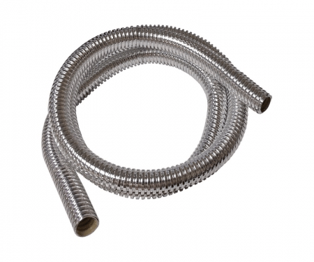

Then there's a making a loom... That case I use that plastic wire loom crap you find in cars (split loom).
They also have an aluminized version: https://www.cabletiesandmore.ca/convoshield-aluminized-tubing

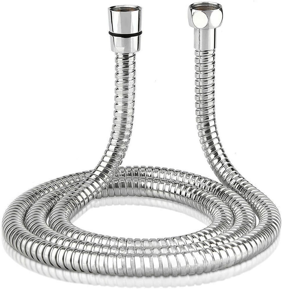

Also depending on the length and size of wire, you could use a shower hose.

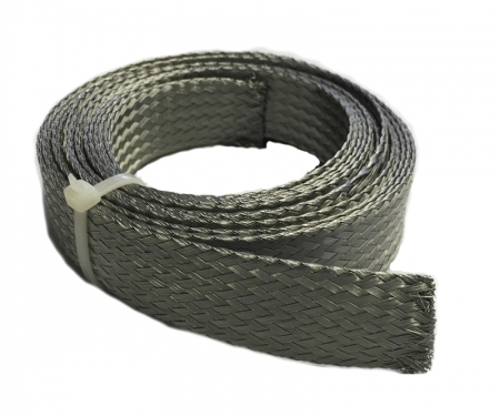

You could also just use stainless steel instead of nylon...
https://www.cabletiesandmore.ca/sta...Hw9cOeFqPxVPsP_pmg9beXcLbG-fzfIQaAtr5EALw_wcB

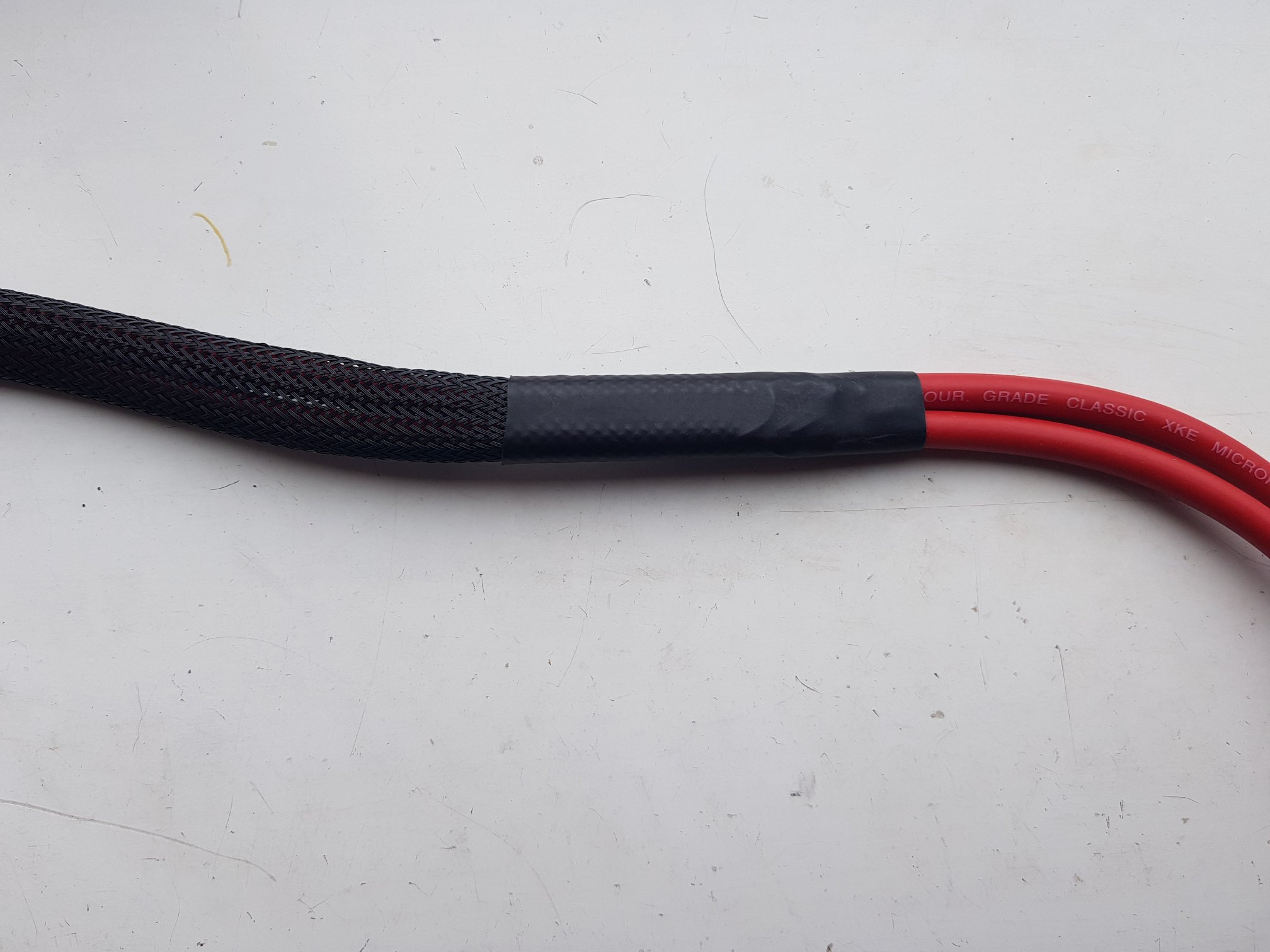

Hi Jan,
For what it's worth: It does not need to be glue-lined. This is a two-cable version I made a while ago. I guess a cable tie would work too, but the heat-shrink is neater.
Another tip: Use bigger than expected nylon braid, and keep it fairly wide/loose on the cables so that they still flex.
Ant.

I really don't want to do that, I want it to stay flexible.You could also just use stainless steel instead of nylon...
@Scott - OCD or not, that's a very good looking cable! But your description is a great help, I'll show my first cable as soon as I have time to do it in a single run. Maybe tomorrow.
@ANT - good tip too. This is for a 3kV cable and REDEL (the LEMO brand that makes my 5-pin connectors) says to use glue lined shrink tube over the pins to maintain HV isolation and creepage.
