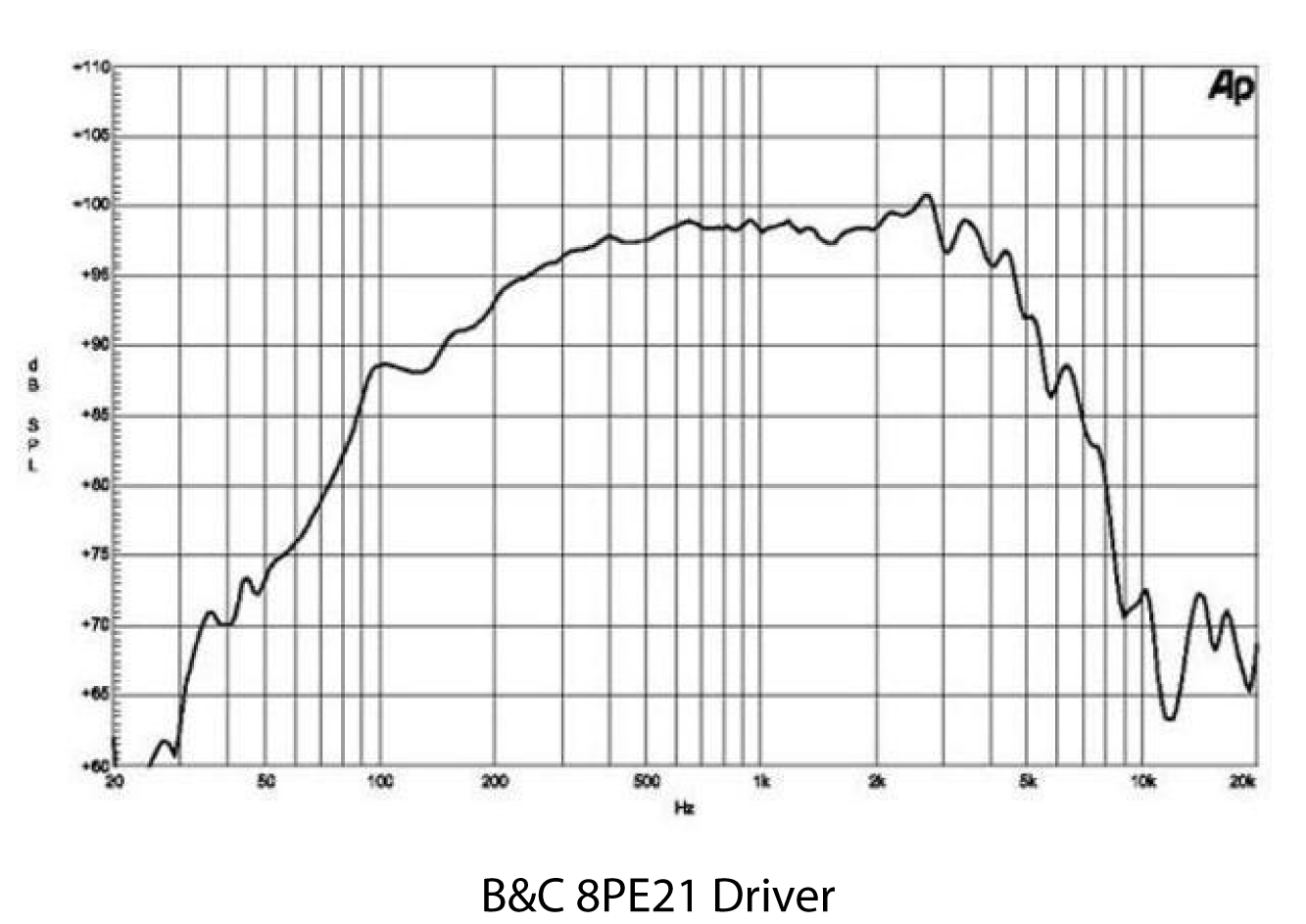

The B&C 8PE21 is efficient and suitable for horn loading.

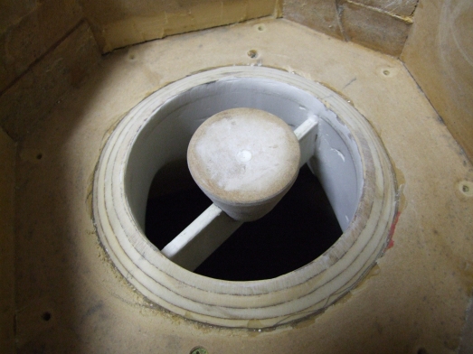

* Midrange phase plug

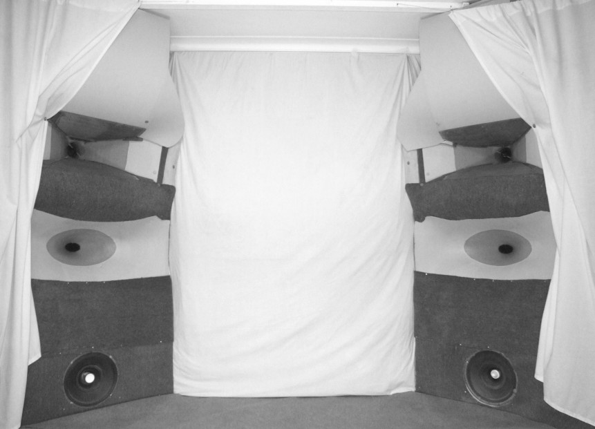

Corner placement has a later far side, and floor or ceiling reflection and can negate the other three walls. Stereo separation is increased and each speaker is toed in front of the listening position.
* The toe-in, and the approximate centre depth of the soundstage.
A multi-way system
I've been listening this way for about a year. At first the midrange would come from above the tweeter. Fixing the crossover blended them but the source sounded elongated. I damped some resonances in the mid horn walls and have also changed the vertical profile, now mono sound locates strictly between the tweeters.
Now I can walk up to it. The region away from the middle is silent.

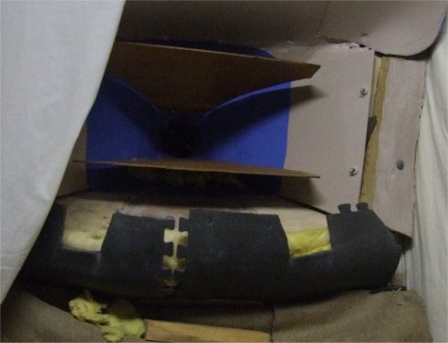

The woofer is baffled out of the corner but I want to push the woofer acoustic centre back. Behind the speakers and along the back wall has been lined with 100mm acoustic rockwool.
Tweeter
* Before using expanding foam.
The vertical profile is 45cm long, horizontal 30cm. The mouth width after the first roundovers is about 75cm around the ellipse. They are intended to be OS but I needed to interpolate some of the profile.

Acrylic (plexiglass) was used for the first 36mm. The next 20cm has a solid wooden outer layer with the profiles formed over this. At the start they are filled with plaster and further out by using ply and expanding foam. At the edges I'm using poly floor mats with rockwool packed behind them.

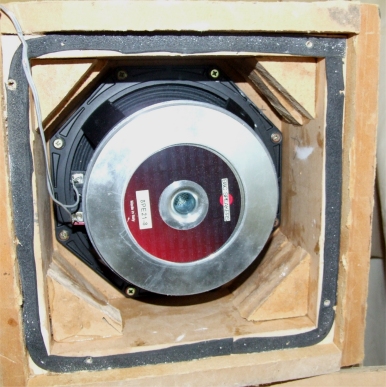

The horizontal profile is hyp-ex, and vertically they are T=0.8 LeCleach. Efficiency is around 107db/W/m.
The first part of the horn and the rear enclosure have been made from 36mm MDF. I used two 18mm sheets for this so I could have a constrained layer of PVA glue. The later parts of the horn use a plywood outer former with thin ply used for the profiles which I have filled with expanding foam.
The B&C 8PE21 is well made. I'm using a compression ratio of 3:1.

The B&C 8PE21 driver is capable of covering the entire speech range decade. [1] Setting c/o frequencies outside this range, avoids bifurcation of program content where the ears are most sensitive. To implement this coverage using a horn, a multi-slit phase plug must be used. [2] An example of this is addressed in the JBL Tech Note [3]

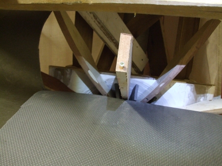

This is where I combined the elliptical tweeter profile with the existing axis-symmetrical waveguide. I started with H & V.. four of the twelve pieces of formwork are just these.
The four at 30 degrees either side of the horizontal were made as a 50 percent compromise between H & V, and the other four are biased further toward the vertical.
Establishing the need for a phase plug.
First phase plug prototype (borderline performance)

The corners are 3.7m apart.
About imaging.. My focus here was towards no diffraction or early reflections, and directivity to be consistent. Imaging is about as good as it was intended to be. As an example, if I put these into mono, the sound appears to be coming from out in the yard through an imaginary window in the wall, and none originating inside the room, which shows how much the speakers are getting out of the way. I could walk up to that place and from left to right and this didn't change. I could have the sound up loud and go put my head in one of the horns and it was still silent.
Corner speakers can do so much with the space if the speakers are designed to use it. If they are not, they can conflict with the corners a lot more than if they were positioned out into the room.
