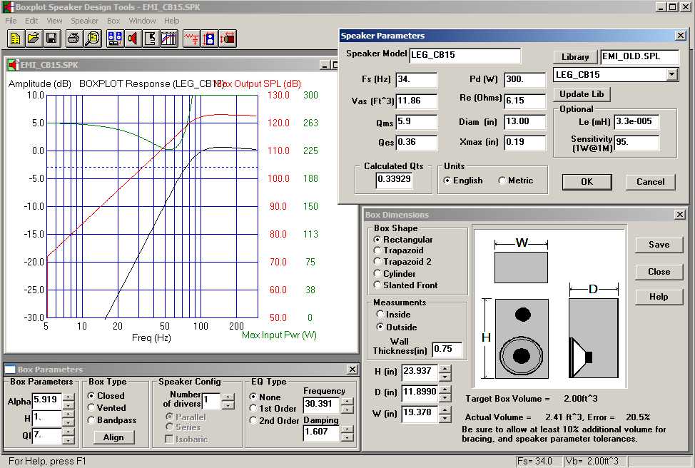

Hello,
I'm a real newbie at this site. I've been surfing around on forums to learn as much as I can to build a (Guitar) bass cabinet. The more I read the more I get confused.
Any way, I am planing to build it. And I would like to ask the people with experiences to give me guidance. Here are my thougth:
1) I would use 3/4" thick Plywood
2) I will use (speaker) LEGEND CB15 - 8 Ohms, 300 Watts
this LEGEND CB15 requires only 2 cubic foots closed box.
Questions:
1) Could you provide me (closest) measurement of the cut-wood to build 2 cubic foots.
2) Do I have to make cross over within this box? (I don't even know that the cross over is).
3) what I need to included the cross-over in the box?

select the Dimensions on box wizard that u want. and adjust until Internal Vb is 2 cuf

For bass guitar you do not need a crossover unless the driver specifies. A crossover is a circuit that splits up the frequencies and sends them to different types of speakers in simple terms. There are many free calculators online that will be able to calculate the box for you.

if you dont know how to calculate simple box dimensions, may I ask where do the 2 cubic feet come from ?

Properly porting (holes or duct tubes) your cabinet could make it louder down low, too much power will burn the speaker or rip up the cone whether ported or sealed.
A resistor alone will not protect a tweeter, at minimum you will need a capacitor and a resistor wired in series with the tweeter, unless the tweeter is the same sensitivity as the woofer, then the resistor may be left out.
Amp+ to capacitor in, capacitor out to resistor in, resistor out to tweeter +, tweeter - to amp -.
The capacitor and resistor values are dependent on the tweeter you choose.
I've never heard of a sealed or ported cabinet tear up speakers. So far as I know, only certain horns can tear them, and that's down to the pressure difference across the cone.
Sealed or ported are pretty constant across the cone, so I can't see any problems here.
