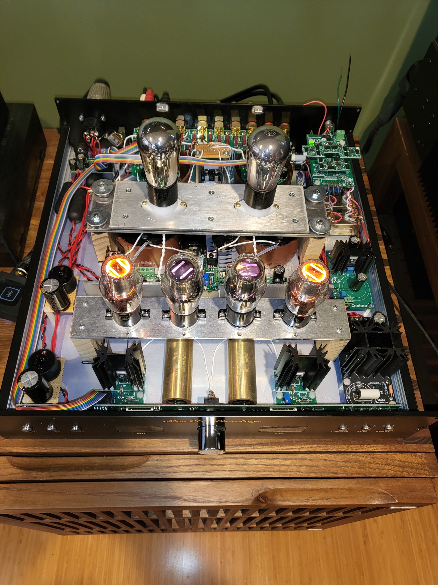

With a little help from Lyuben at JL Sounds it's now working fine! Turns out the LRCLK and Data lines were swapped. The biggest clue was that it played DSD correctly, but not PCM.
A simple cable swap fixed it!
Thanks also to Brian for pointing out the volume control jumper...I'd still be banging my head on the wall if not for that!
The sound is excellent by the way. Here's a pic of my DAC/preamp with the lid off, the DAC is in the upper right corner. 01A output tubes fed from the DAC through Lundahl LL1676 1:1 transformers.
