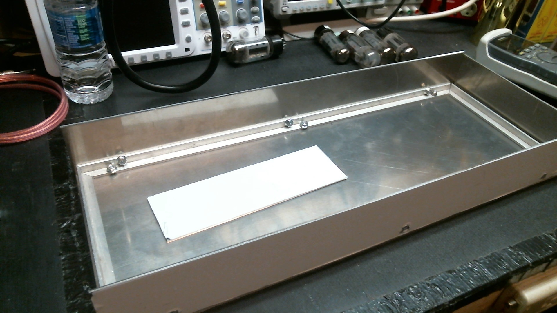

I want a amp to experiment with. A basic design that I can change out tone stacks and use different tubes, and make other experimental modifications to.
I have a chassis built that is 8" X 21" that fits a Cabinet that I have. That gives me a lot of room to make changes.
I have most of the parts on hand to build most any design.

I decided to build the JTM45 circuit first. Well...I had in mind to use a Mesa style twin rectifier and a switchable solid state diode power supply. I will most likely build a Fender style circuit next.
I think I have enough room to cut holes for 6 pre amp tube sockets and cap three of them in the chassis I just finished for future changes.
I don't have in mind to use KT66 output tubes so it will not sound just like a Marshall to begin with.
This amp will be something to experiment with. The idea is to build a sort of universal chassis with as much room and ease of change as makes sense. The chassis is made from 1/8 aluminum and screwed together with angle aluminum so any part of the chassis can easy to replace. This amp will not get moved around much so "road worthy" is not a big consideration.

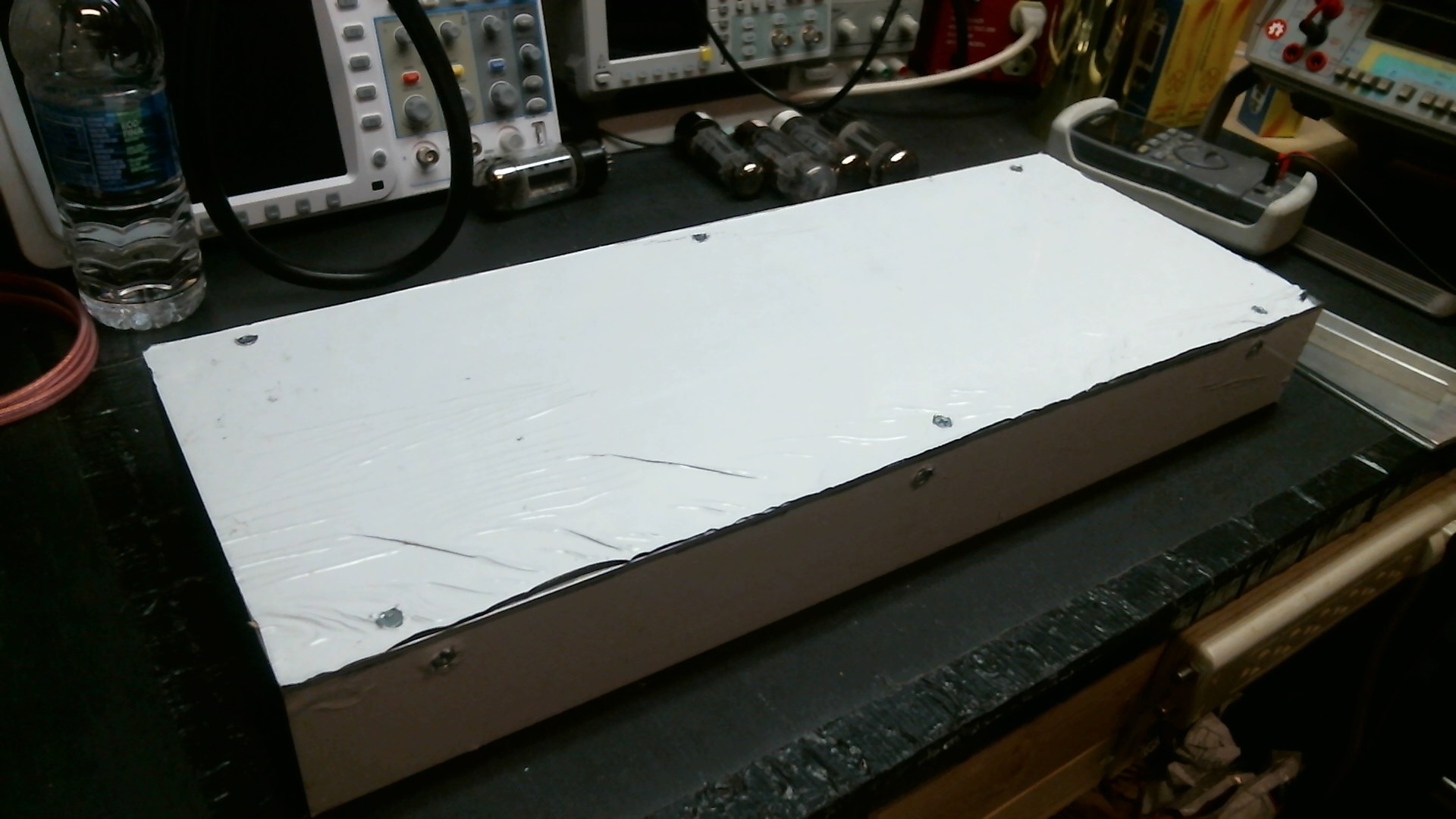

I am finishing up the chassis now. It is made from 1/8 inch aluminum,perhaps a bit thick but it is what I had on hand. I still need to put it in the milling machine and cut the holes. All the panels are removable so it is easy to change things. It was a good bit of work to make it like this. I also have a TIG welder so I can spot weld it at any time.

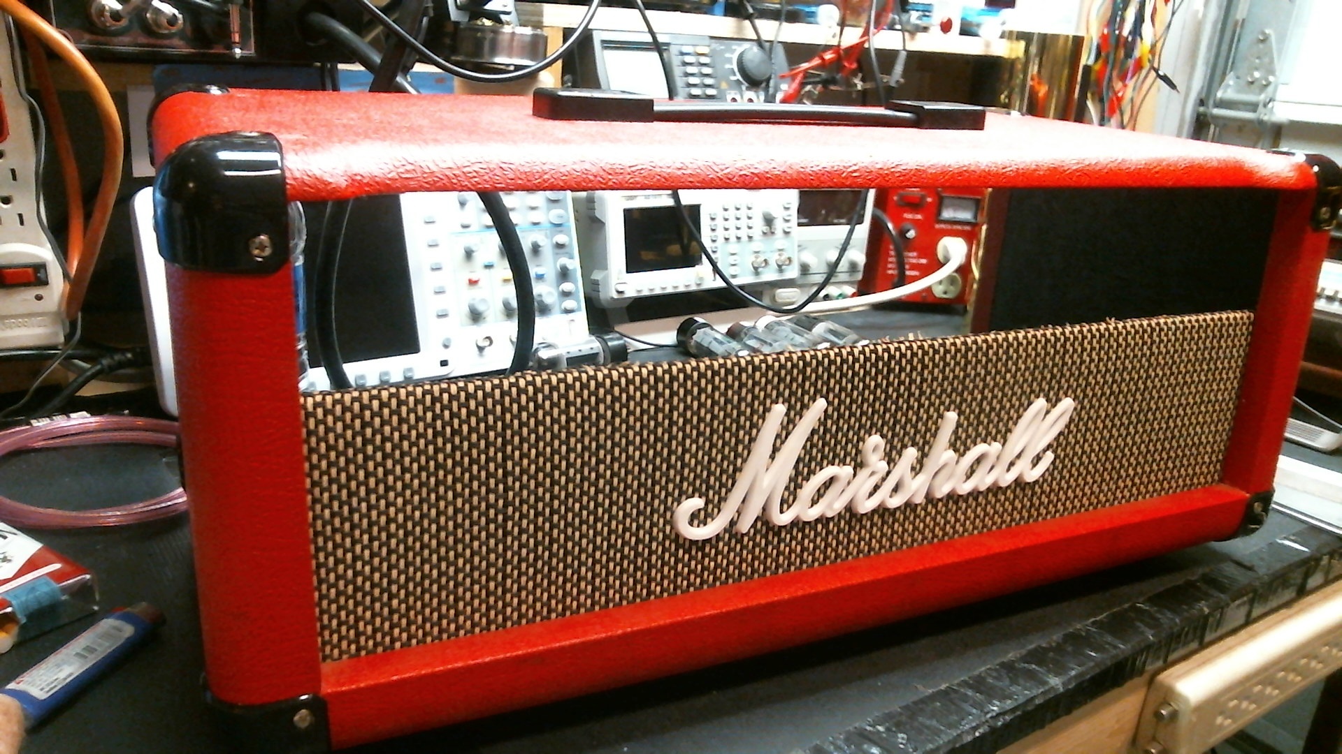

I also had this Marshall head cabinet someone gave me,so I made the chassis to fit it. I am not in love with the red tolex but, oh well!! It is in nice condition.The Marshall logo is easy to remove.
