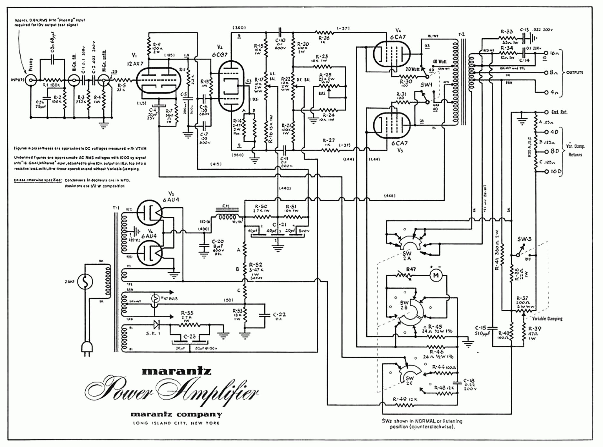

Hi, I'd like to build a diy El34 pp amp. Is it worth building a clone of the marantz model 2, or are modern schematics "better"? Such as the Ank amps.
I have the transformers and I'll be building it from scratch.

Thanks, I have the model 2 schematic. I just wondered how it would compare to more modern El34 designs

You have the original vintage transformers?
If you post the schematic, some of us can look at it, and analyze it versus some other [modern and vintage] EL34 amplifiers that we might already know something about.
Or, we might analyze the amplifier on its own merits.

Whatever the schema you 'll use, vintage or modern, you will have to adapt the CR and the stabilization networks to the transformer, your amp must be stable with eatch load.

Ok thanks. So is it better to build a different el34 amp? Any recommendations?
Member THD+N has designed an Eico HF-87 clone with Hammond transformers that is well-tuned and stabilized. No need for concern about performance. The Eico is very similar to the Marantz, actually, minus the damping controls. It was a lovely amp and I'm guessing the clone is equally nice-sounding.
