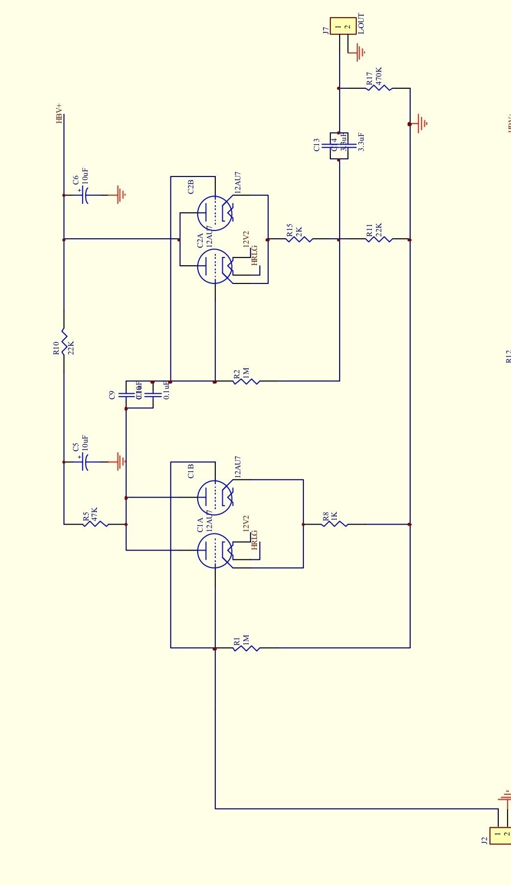

Hi guys,
Is it possible to change this buffer to have about 12db gain without sacrificing sonics.
One channel shown.

This is not a buffer. It's a common cathode stage into a cathode follower. It already has gain of around 11x. This seems way more than enough for a line stage. What are you trying to drive?
Yep you could make R5 say 100K and increase R8 to get about the same plate voltage on C1A/C1B. If that not enough change C1A/C1B for a 12AT7 and again adjust R8 for the correct voltage.

Are you sure it has about 11x gain.
I connected it directly to the 2v rms output of my DAC and it is at most 6db louder than going from the DAC straight into the amp.

Gain should be around x11. The output impedance is around 2k.
What is the input resistance of the amplifier? It may be loaded down.

Tubes used in the 1st & 2nd stage are in the wrong position to drive the load properly.!
AU7 should be used to drive the load, AX7 as a simple gain stage. 🙂

17.5 dB is more than the required 12 dB so something is not right. Signal level should already be what normal power amplifiers usually can deliver. I am afraid necessary information of the other gain blocks to determine what is not OK is lacking. Usually not keeping to standards plays a part in such issues.
Whether the circuit given has a gain of x11 (21dB) or x7.5 (17.5dB), both are much more than the requested 12dB.
