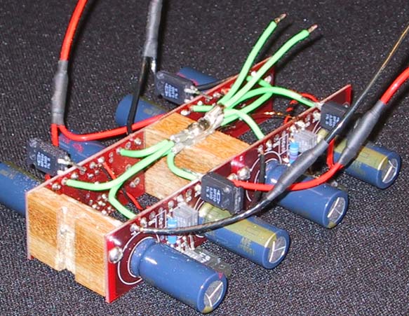

most solid state devices, such as Your IPOD and CD/DVD player will get along fine with the relitivly low input impedence of the GC. However if you want to run multiple boards per channel for a bridged or parallel set up (for more power) you may want to look into adding a buffer to increase the impedence that the source sees. also, some tube equiptment is designed with higher impedence in mind, so if using a tube preamp a buffer is in your best interest.
Now for the buffer vs. preamp issue. Basicly a preamp is variable in its output and a buffer is fixed, but a buffer can be made variable by simply putting a pot in line after the source and before the buffer. I also think it is kosher to put the pot after the buffer. I am running 2 amps per channel, without a buffer at the moment and a 100K pot as my volume control. because I dont need any more gain than I already have, I will probably go with a buffer to combat the low impedence.

Buffers were originally used to isolate the input of the Inverted Gainclone from anything preceding it. This is because with the IGC, the electrical properties of items like pots, interconnects etc affected the working of the amp.
The original IGC circuit also has a fairly low 10K input impedance so a buffer with a higher input impedance often helps.
A preamp is really just a buffer (or gain stage if it is needed) with a means of selecting and/or controlling the level of the signal.
I have recently posted a design for a suitable preamp
here on my Gainclone pages. 😉
