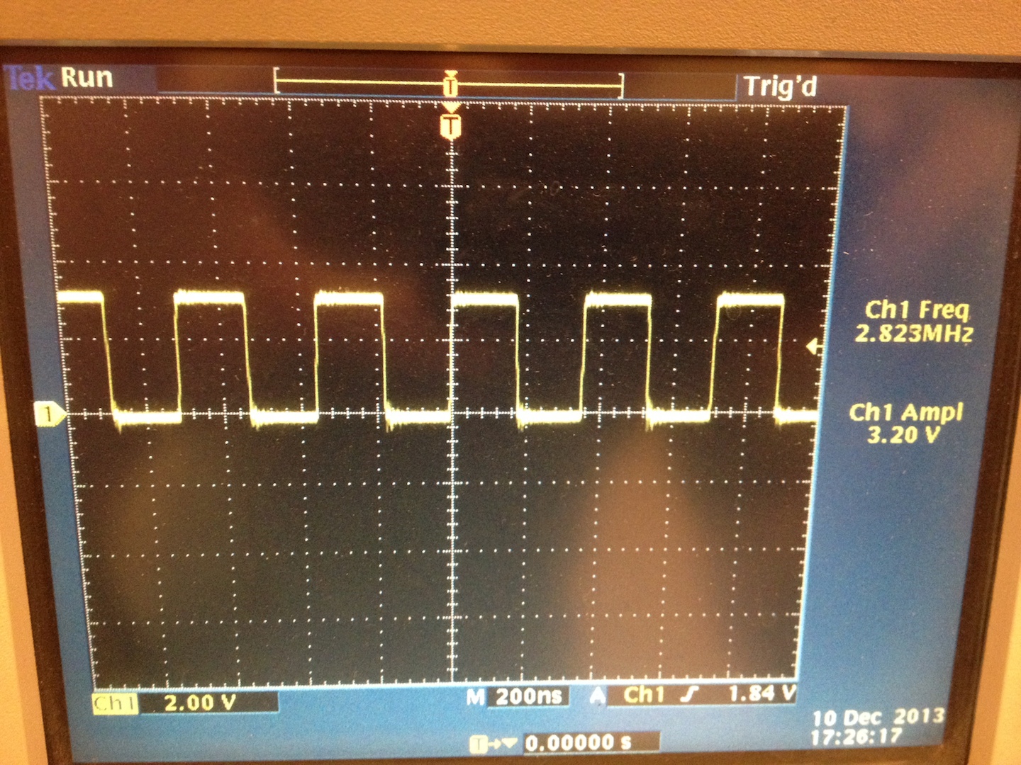

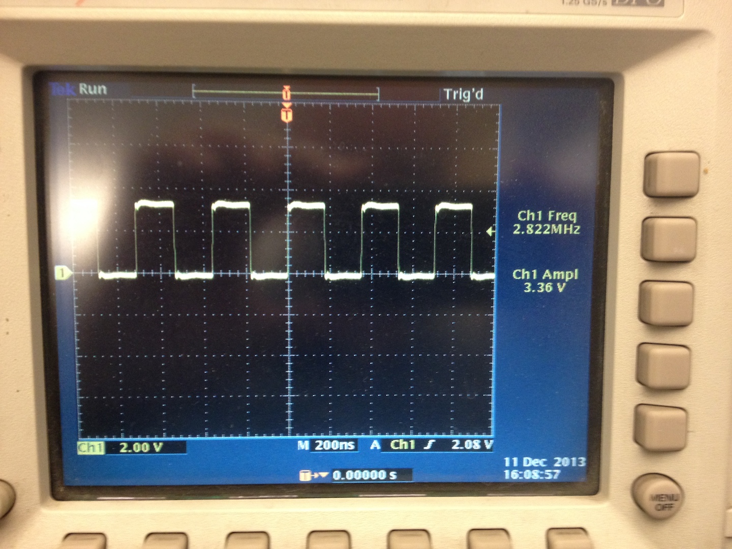

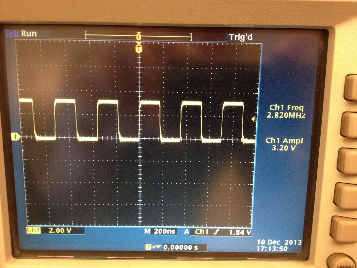

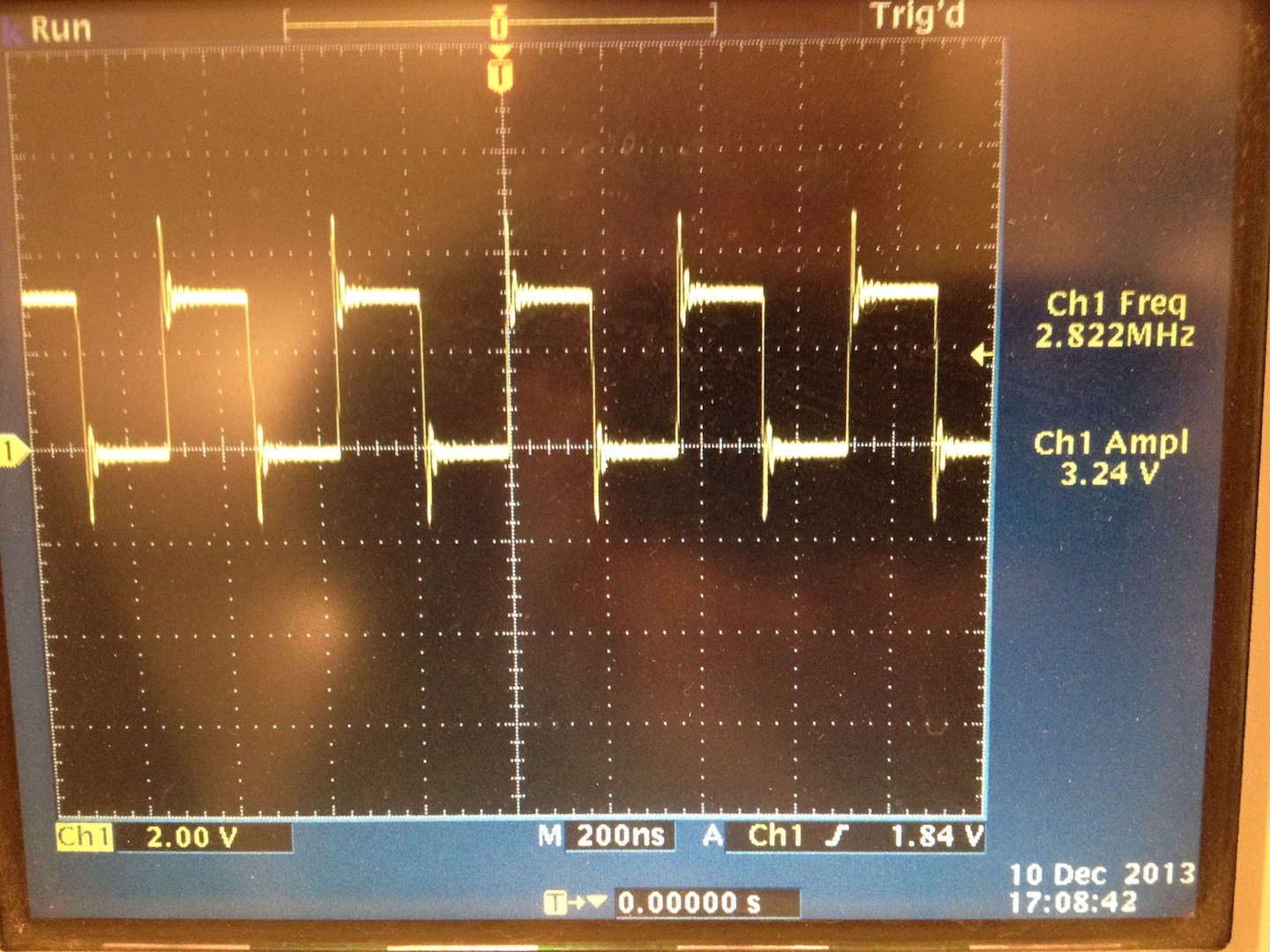

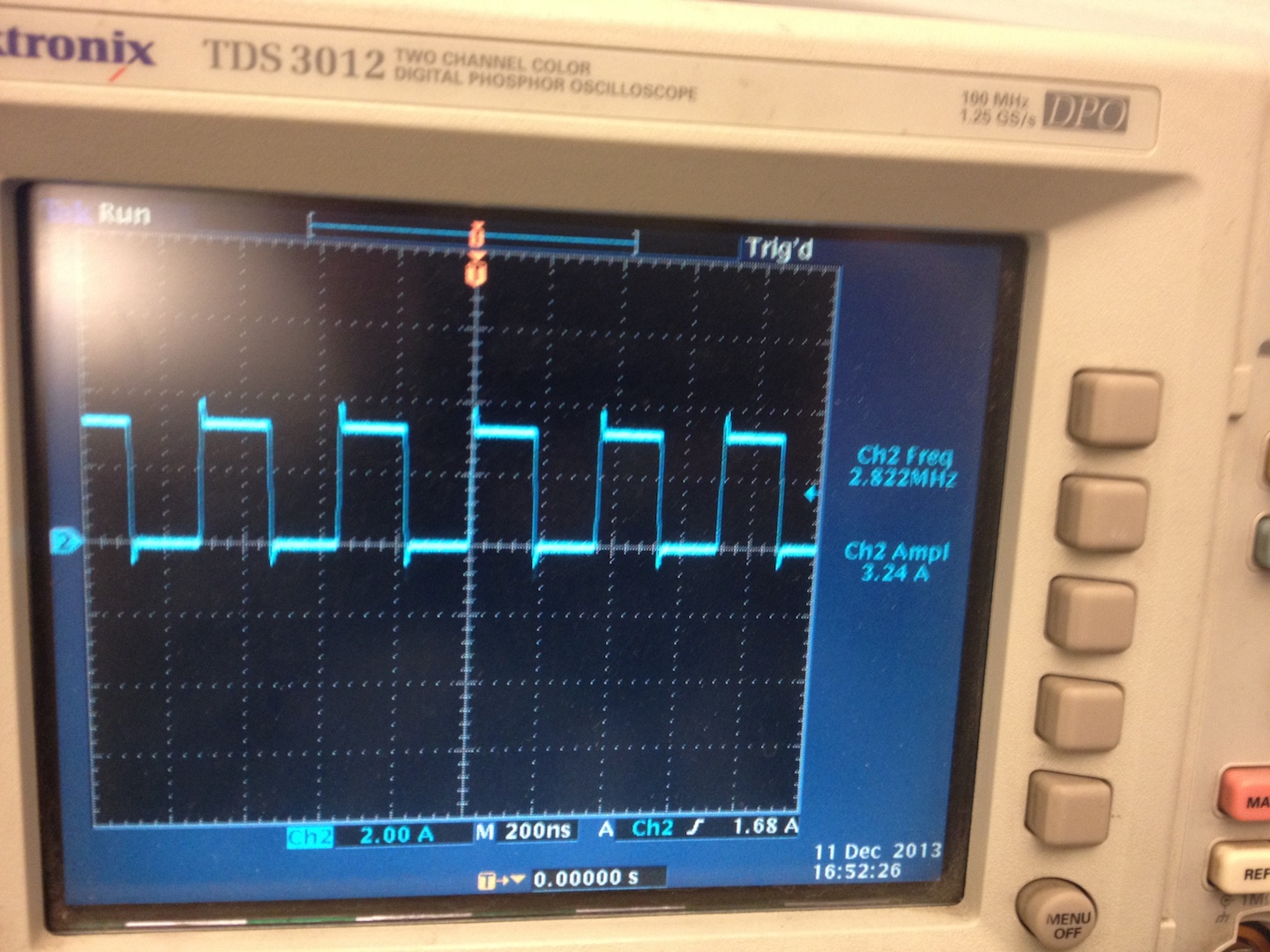

The I was looking at the serial clock and there was some overshoot ringing so I applied a variable resistor to find the best value for a clean square.
About 68 Ohm seems to be a pretty good value so I went for a fixed resistor and this did help on the locking problem but it did not eliminate it totally, so i am asking you guys what is wrong with the clock signal showed in the pictures.
One picture is without resistor on the serial clock.
The two others is with 68 and 87 Ohm on the serial clock.
I am out of ideas and need some input for other tests.

Today I have tried with this :
MPZ1608D101B TDK | Mouser
Instead of the 68 Ohm resistor and in serial with the resistor and it did not make any difference.
However the result was the same without the 68 Ohm resistor, so the TDK did help compare to no damping at all.
It seems like the locking problems in the beginning is better with the TDK but it loose lock several times over a minute test.
The first picture is the TDK and the 68 Ohm in serial.
The other picture is the TDK alone.
Any thoughts ?

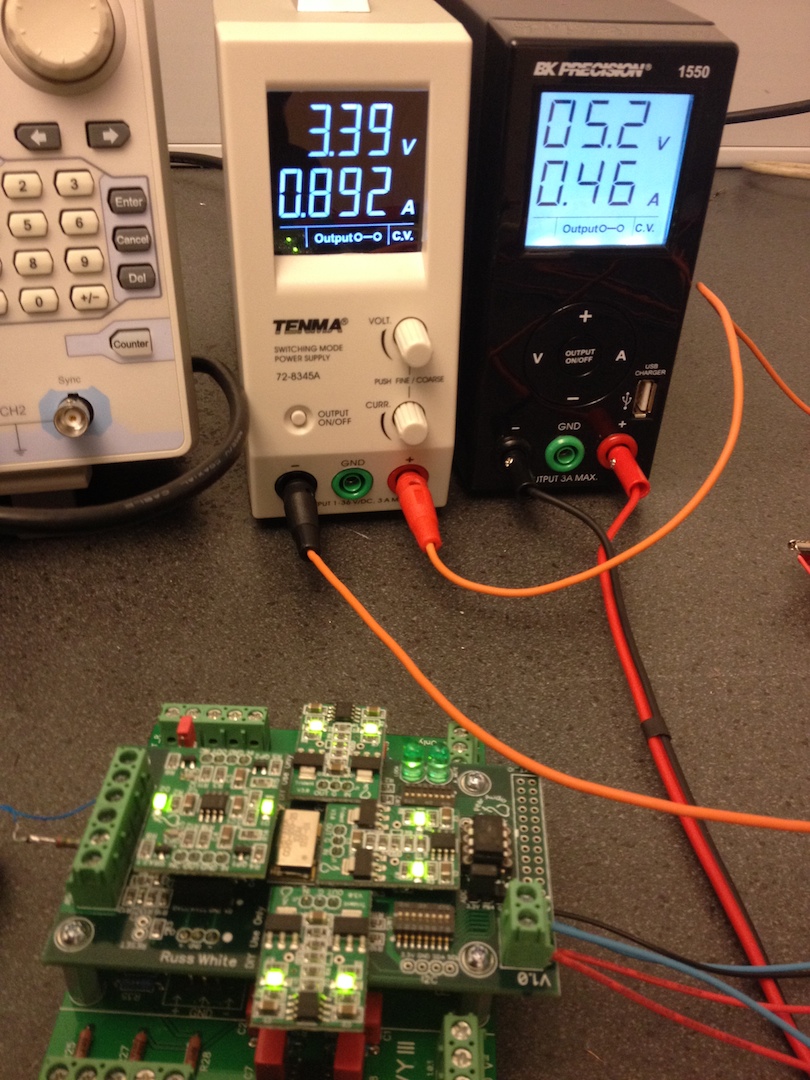

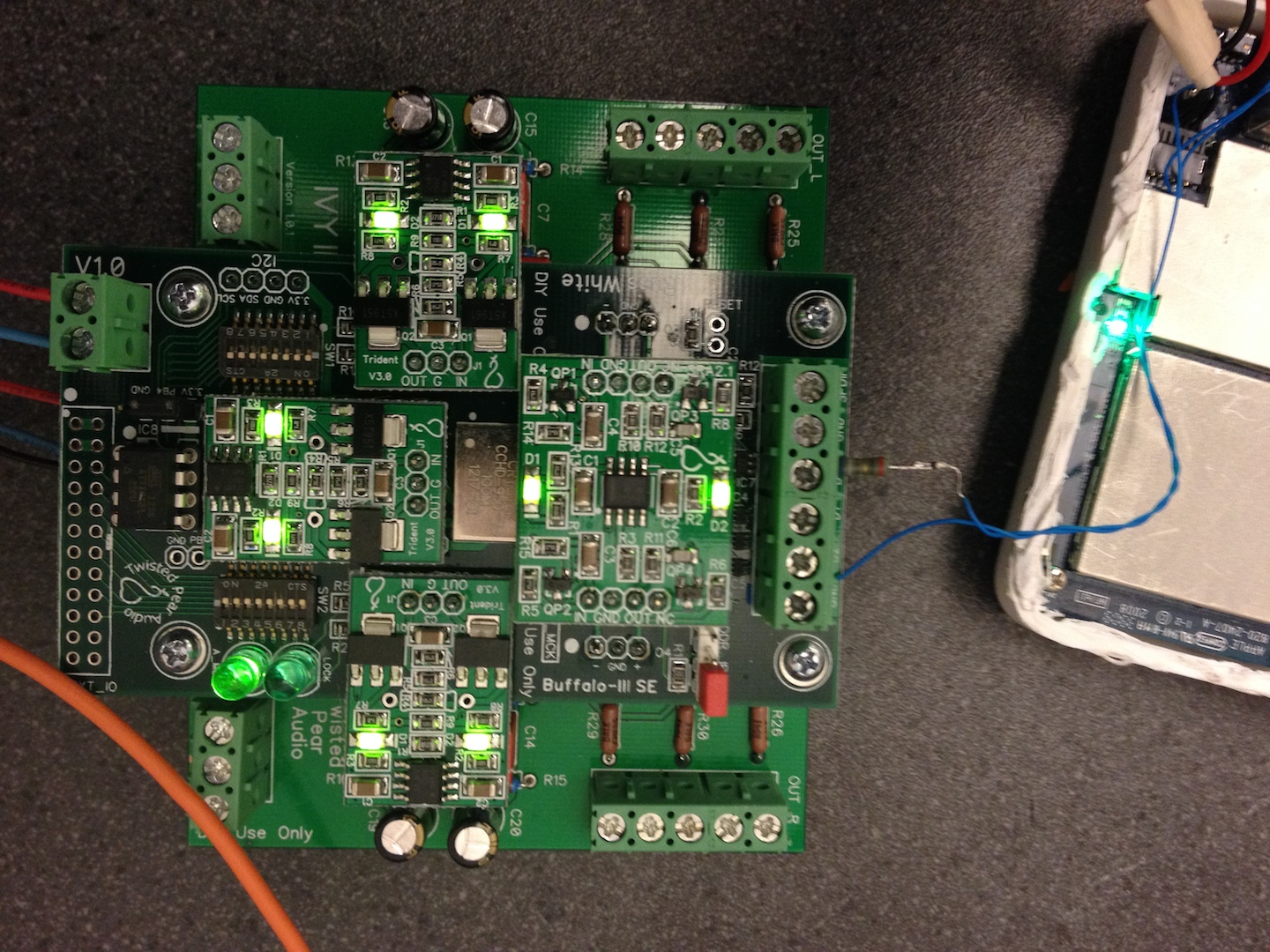

Regarding the wiring then here is some pictures.
I have tried to remove the other wires so only GND and SCLK was connected.
The white power supply is for the AE and the black is for the DAC.
All the dip switches is set to ON and it make no difference how I set the filter bandwidth.
The SW2-5 S/pdif auto detect dip does not do any difference.

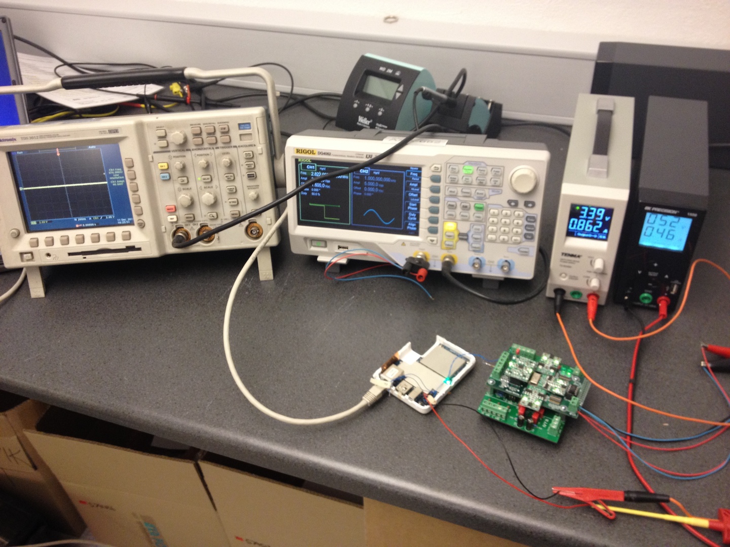

Hi Russ
I have found the spdif out from the AE and with the divider you suggested the voltage is about 0.6V
I connected to the Buffalo DAC but it would not lock.
Tried the same wires on another DAC and it did lock right away with no drop outs.
Then I had the scope on at the same time and saw that the voltage is pull down to 0.3V.
Hmm... tried the i2s again and it will not lock and the voltage is pulled down from 3.2V to 0.5V when connected to the Buffalo DAC.
When I removed the wires from the DAC the signal is 3.3V and 2.8Mhz.
What has happent here ?
Both SPDIF and i2s is pulled down when connected to the Buffalo DAC
Chris

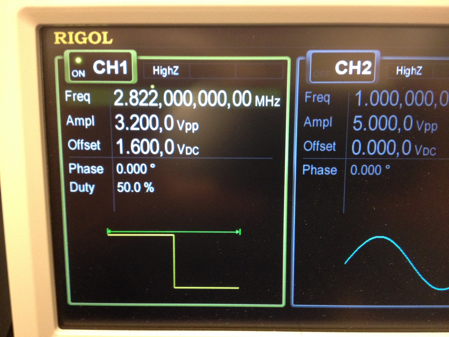

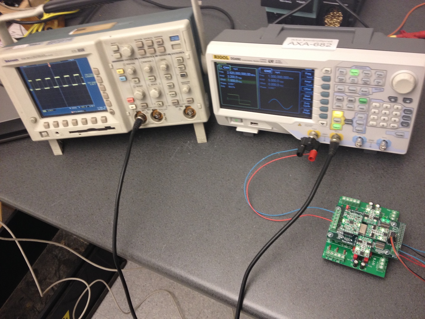

Hi Russ
Thank you for quick reply.
Yes I did remember the jumper and it make no difference.
I think something must have happend to the Buffalo board but I have no clue as I do not have the schematics.
On the picture the yellow channel is directly from the signal generator and the blue one is from the signal generator to the Buffalo DAC.
I have been re-soldering all the junctions I have made myself.
I really need some advise what to check.
Chris

At what exact points are you measuring?
Does the same thing occur for all inputs?
If anything failed it would be one of the input multiplexors.
